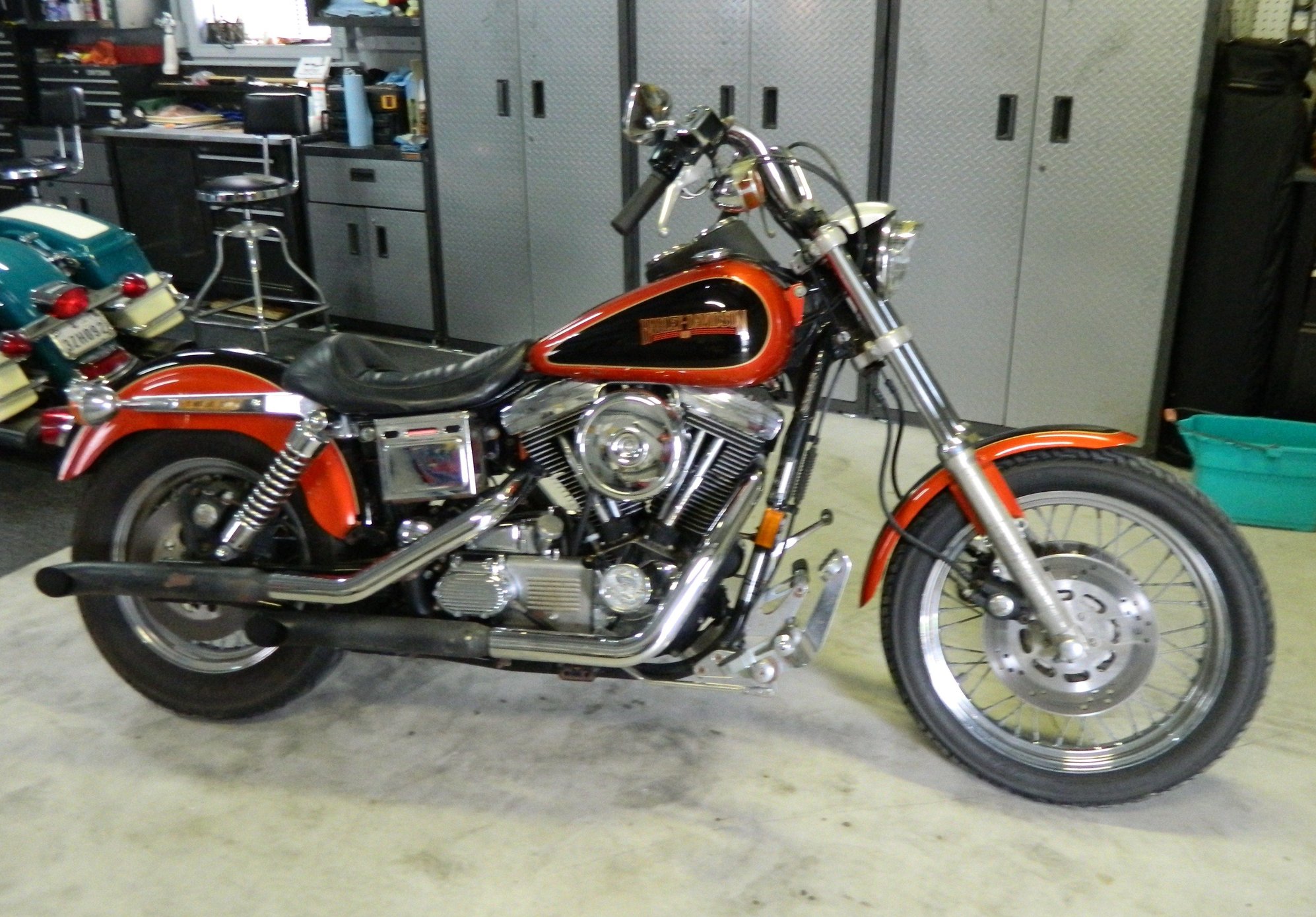

I have to ask. What is your riding experience and mechanical ability?
$2K - $3K and some search for best part prices can completely transform any bike, if you have a fair mechanical skill set. If you don't have any skill search until you find exactly what you think you want. Chances are you'll still change it up.
The above are before and after LowRider Evos final $$$ less than $5K - $6K - Sales price +$3K ater I rode them a year. It's all about what you want and what you can do.
