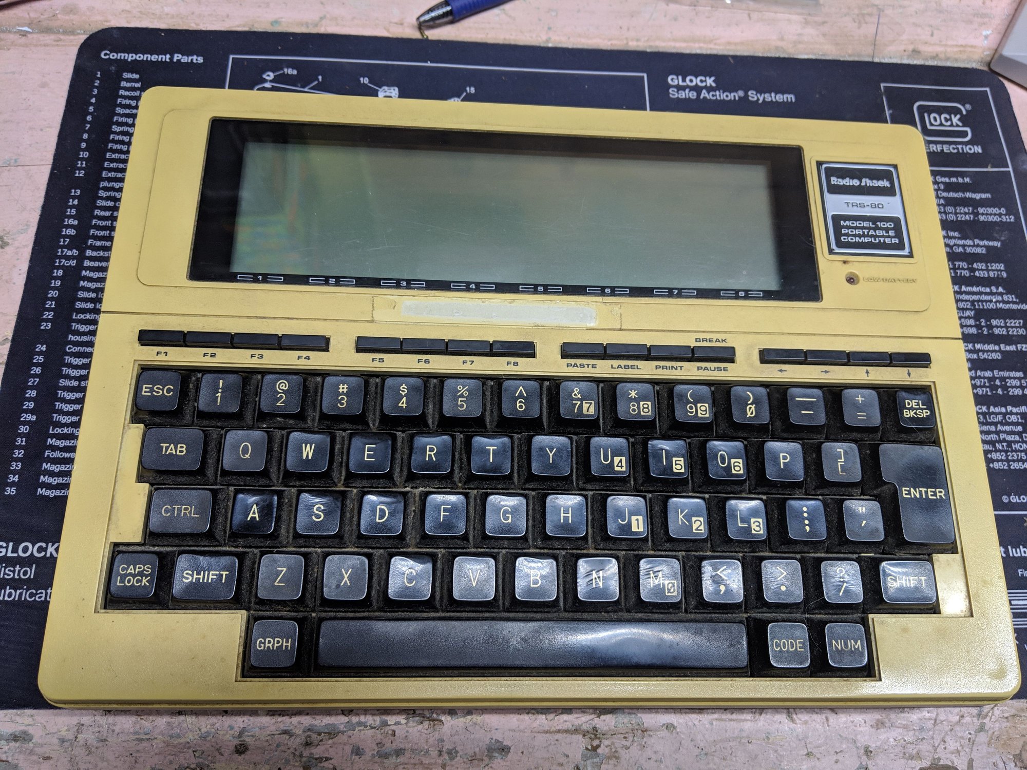

Like the presentation. It reminds me of the time I was trying to pick a plexiglass colored cover for the monitor on my TRS80. Went with yellow instead of green.
Partial to the "laptop" version myself.
