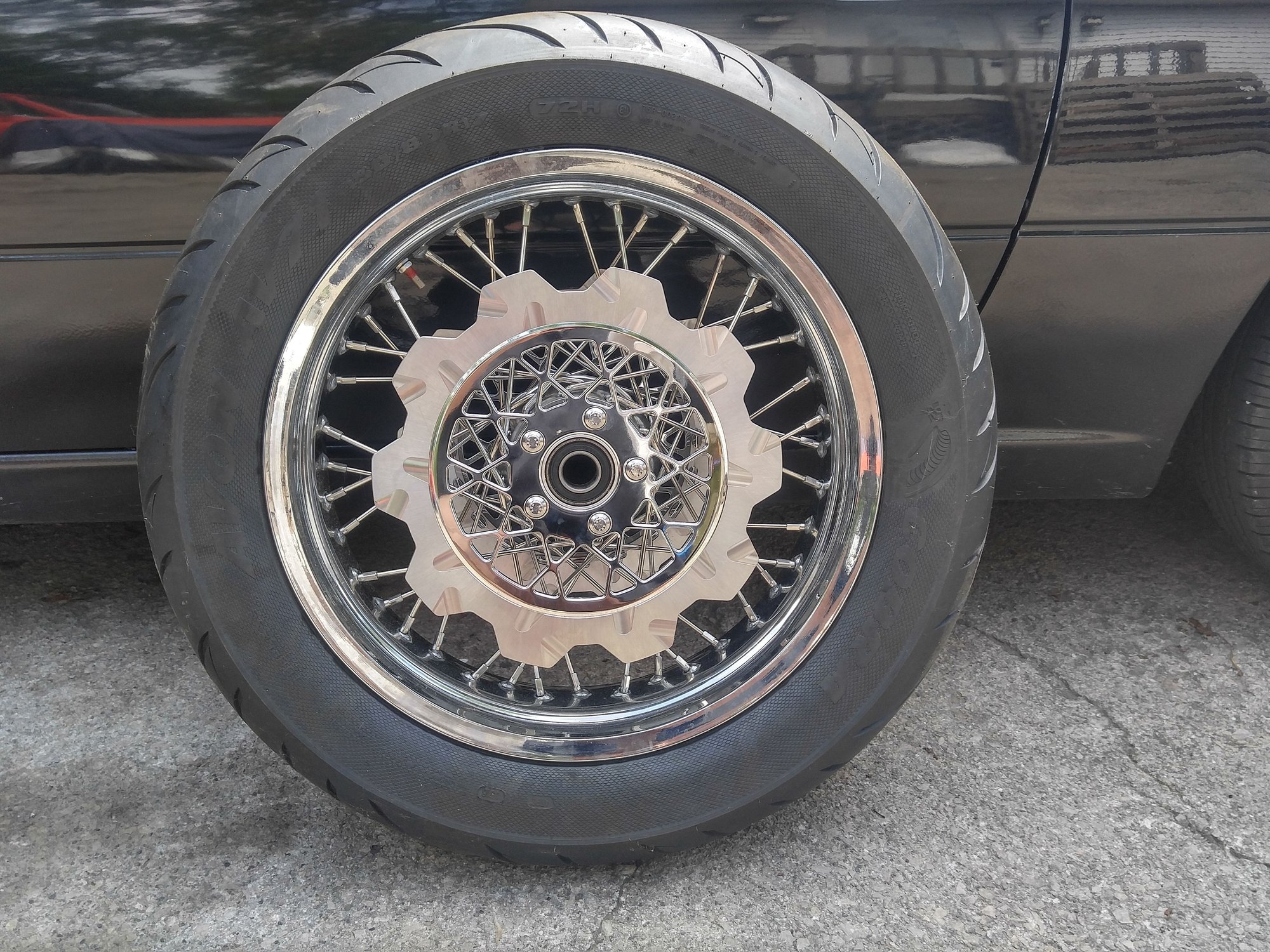

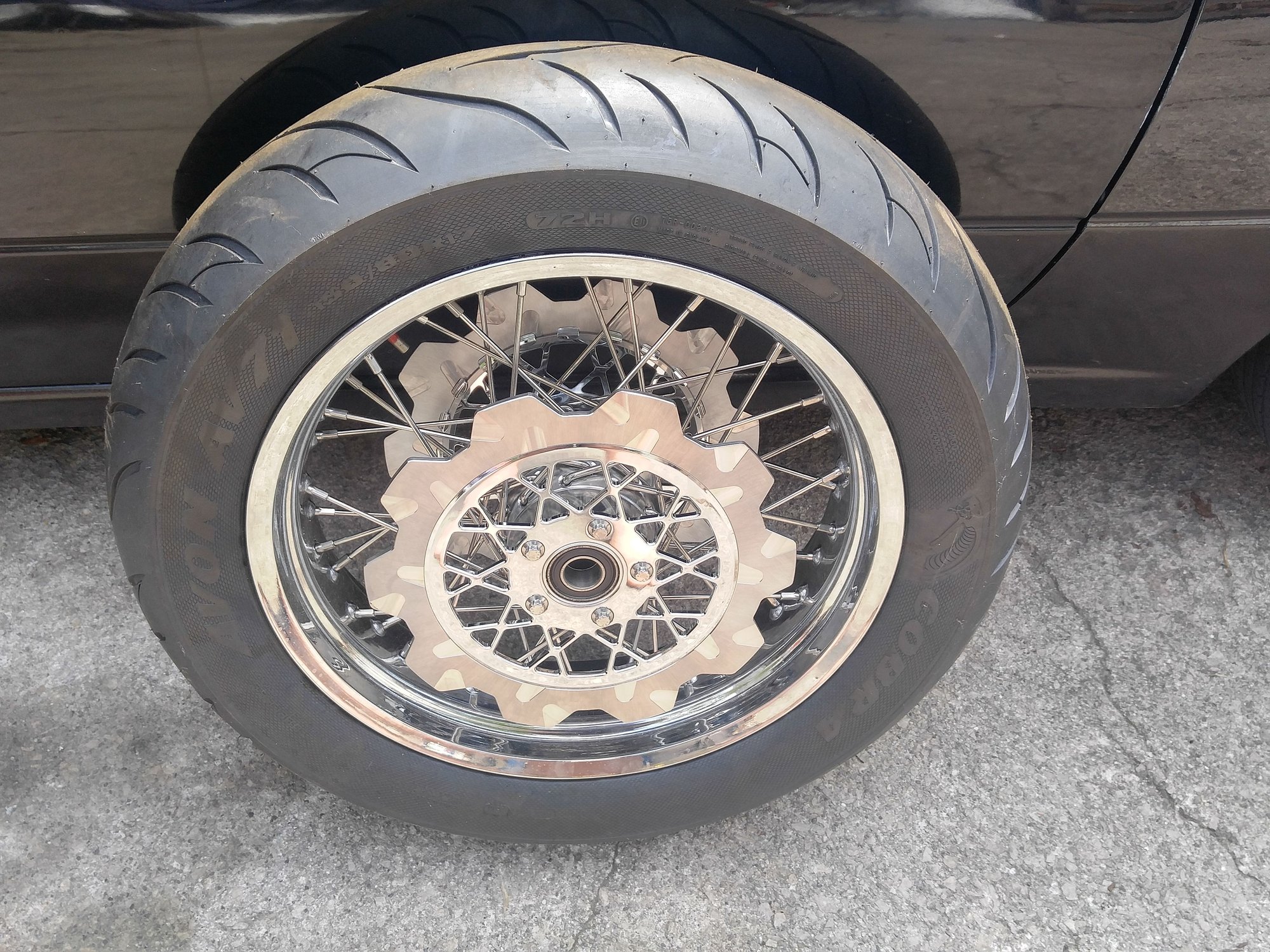

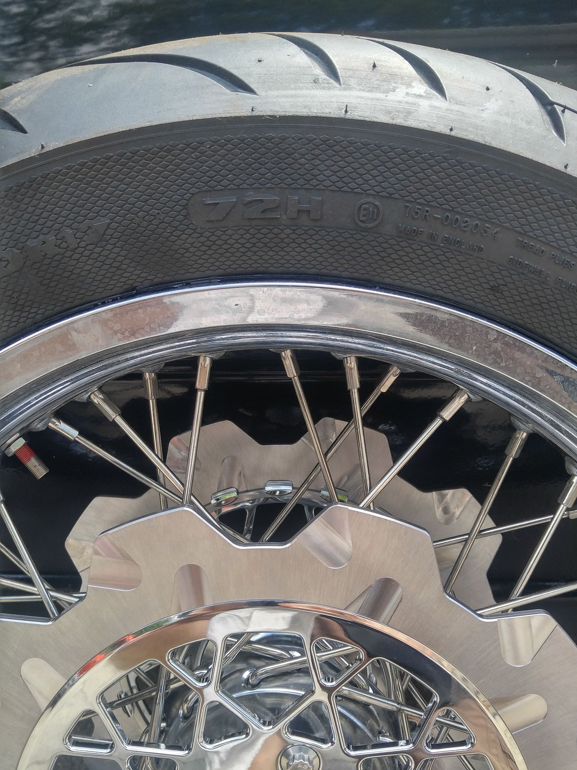

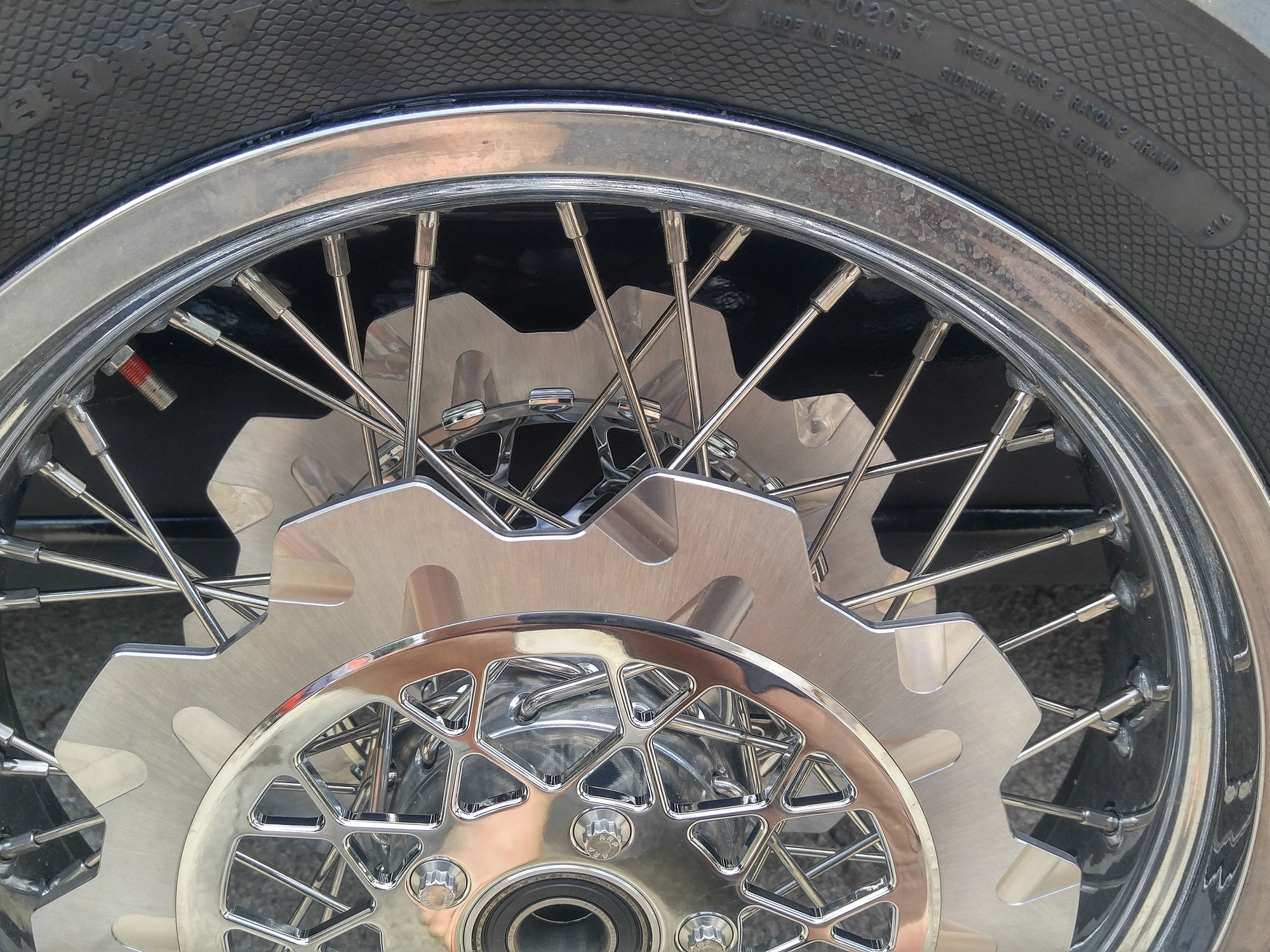

Got my new brakes today. These rotors are lighter than expected. Super jazzed!
The front 11.8s are 2.98 lb each (5.44 pounds saved, total)
The rear 11.5 is 2.77 lb each (2.23 pounds saved)
(7.6 pounds of unsprung rotating mass saved. That's HUGE!)
11.8" Lyndall Gemini Scalloped
11.8" Lyndall Gemini Scalloped (front)
11.8" Lyndall Gemini Scalloped (back, lug locks, floating replacable friction ring)

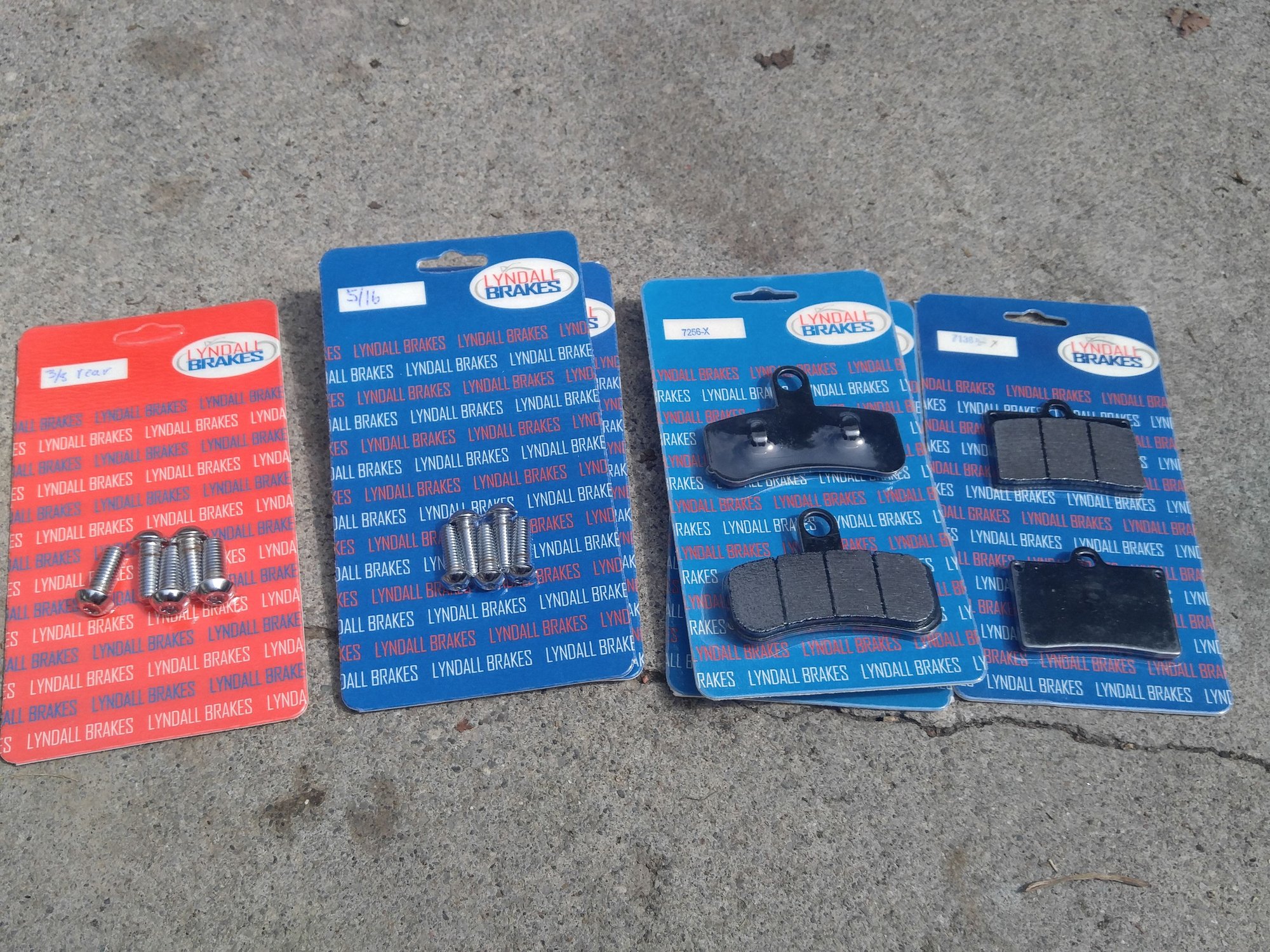

Lyndall included polished button head screws. Not sure if they are included standard or not. I didn't order them since I've got ARP hardware already.
Xtreme pads for front and rear.

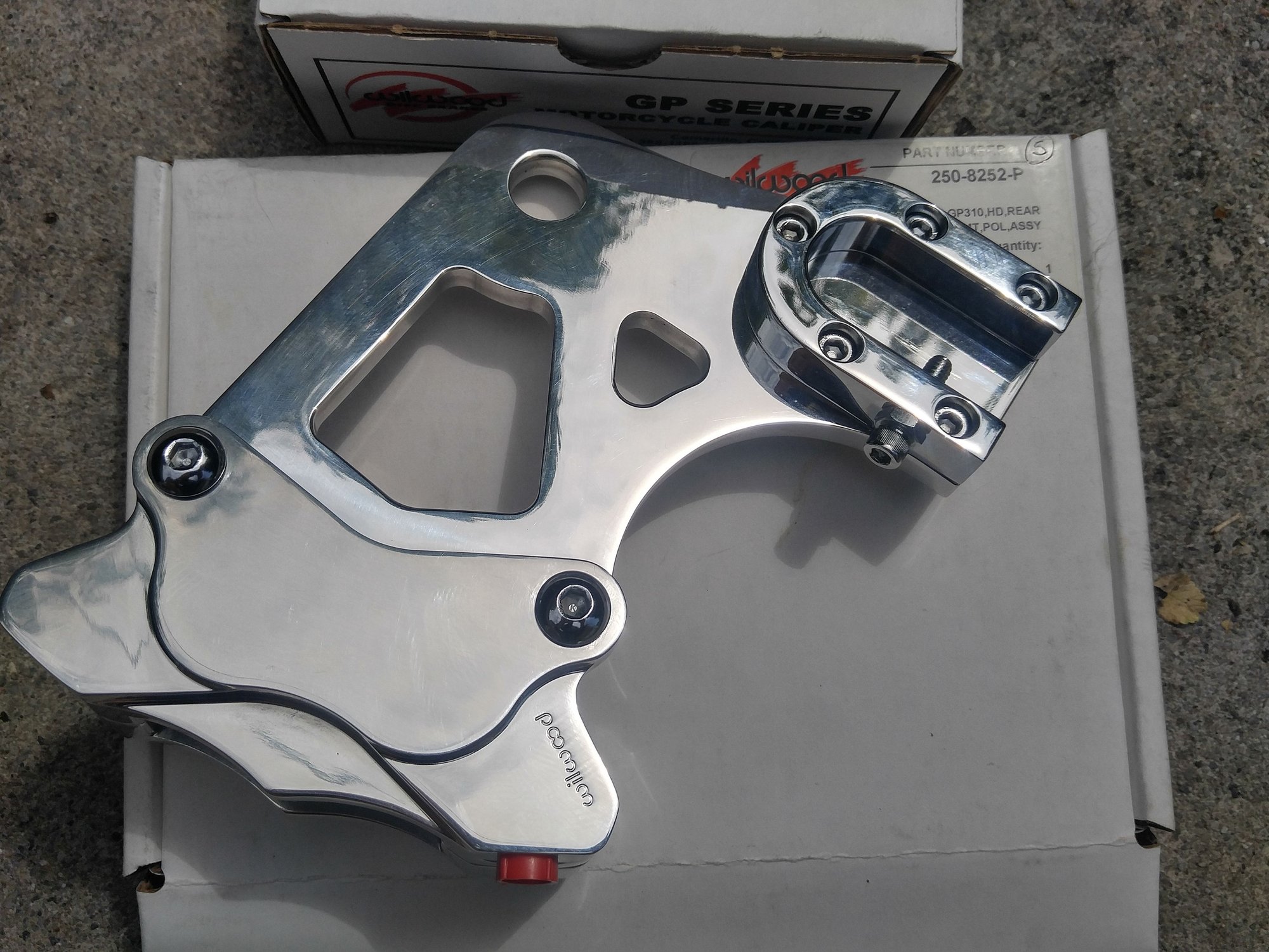

Wilwood GP310 4 piston caliper and low mount bracket (under swingarm). They will both be going out for powdercoat later this week. I'm thinking gloss black for the bracket and texture black for the caliper. Wanting to match the front calipers as closely as possible.
Lyndall hardware and Xtreme pads
Wilwood GP310 and low mount bracket (polished) (front/outboard)
Wilwood GP310 and low mount bracket (polished) (back/inboard)
