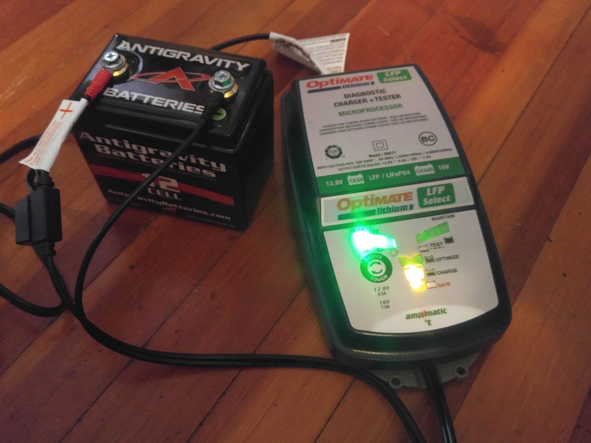

Antigravity AG-1201 (Small case) & Opti-mate TM271
I'll get size and weight comparisons once it's done charging.
Yes... You don't want to weigh it before charging. "Dry Weight" vs. "Charged Weight" will make it seem much lighter than it will be after being topped off with electricity!
I have an Antigravity in my other bike... So far so good. With a conventional battery, it would be dead in a month without a tender (the electronics are never really "off" in that bike). I left it in a cold, unheated garage with the battery fully attached for at least three months over the winter without a tender (maybe longer), and it cranked and started like a brand new bike in the spring. We'll see if it can do that year after year...

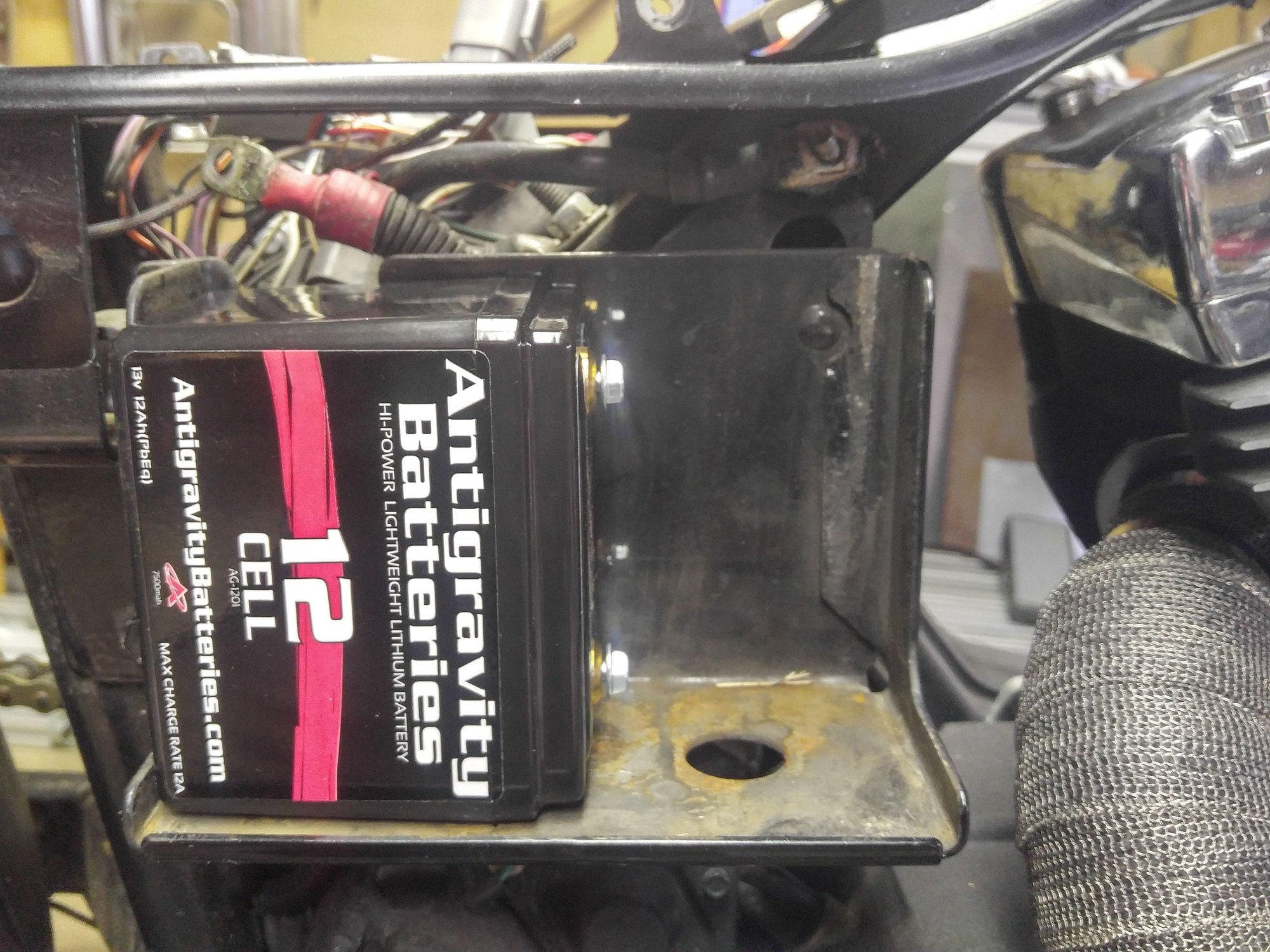

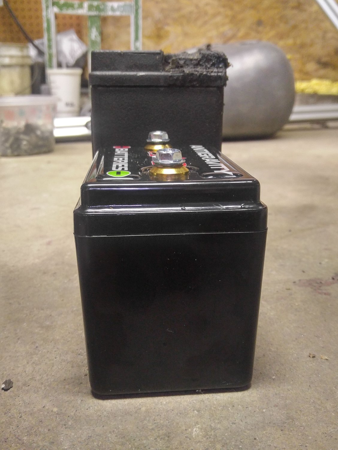

Antigravity AG-1201 weighs 2.625 pounds.
Stock H-D battery weighs 15.8 pounds.
13.175 pounds saved! I only estimated 10, so that's great.
More importantly, I gained much needed space for the M.Unit. I may still move the coil into the neck gusset, but if not I wanted to get the brain away from the EMI from the relocated coil.

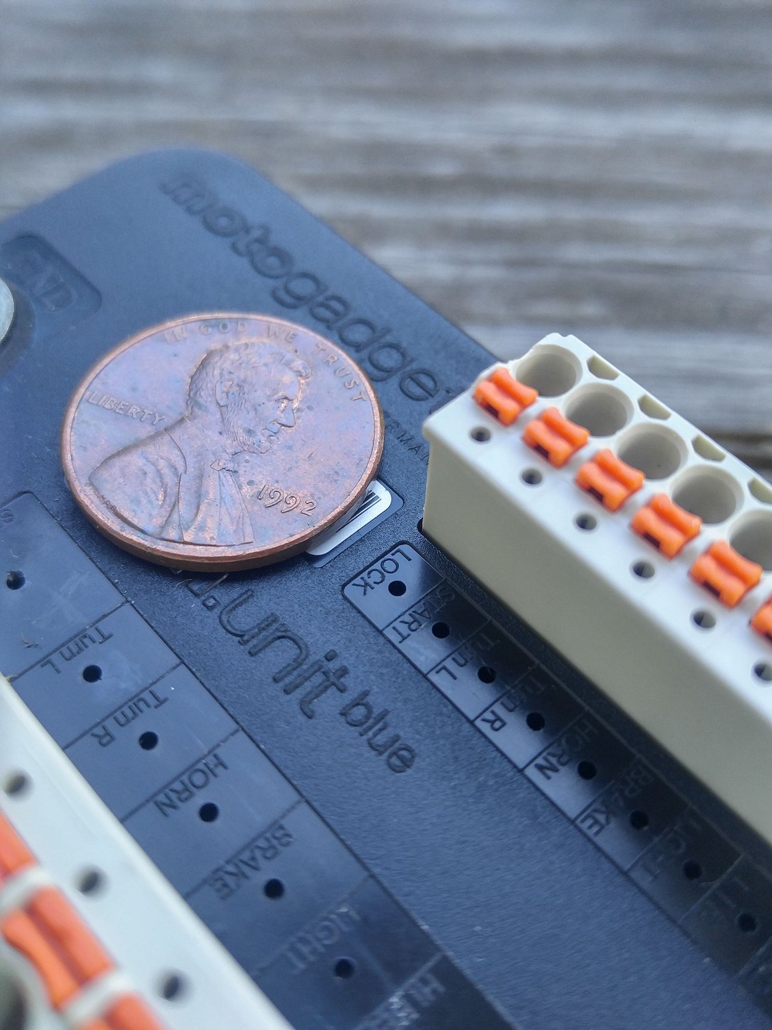

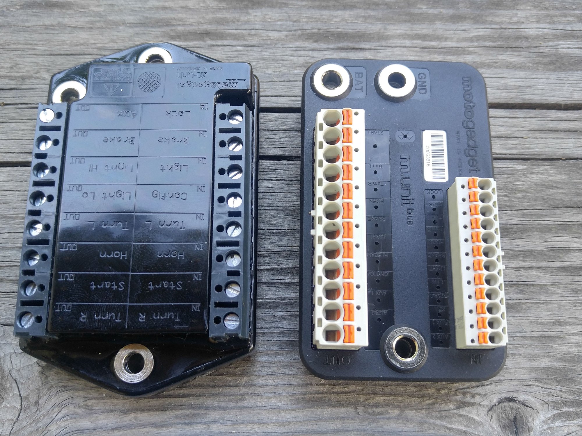

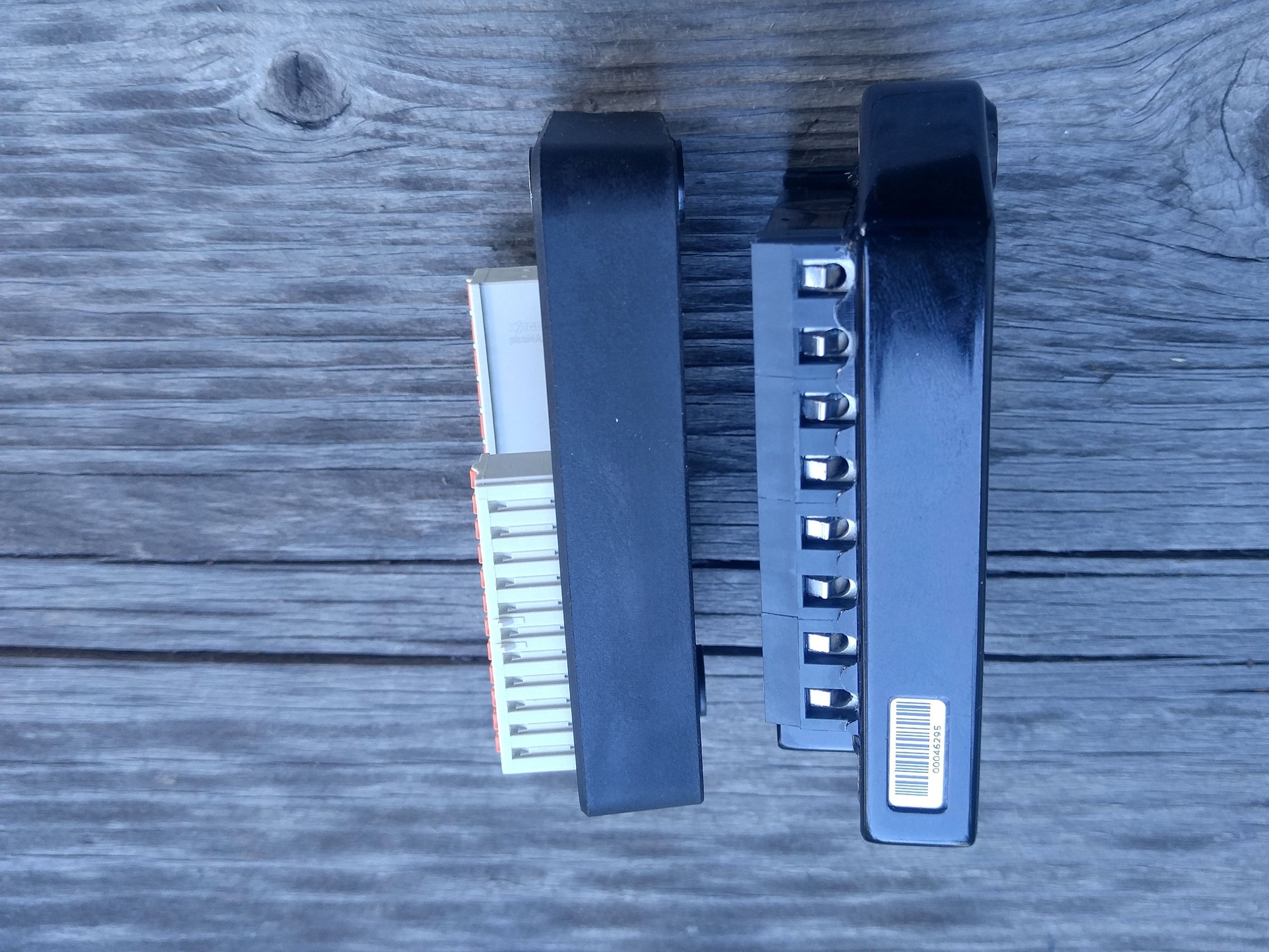

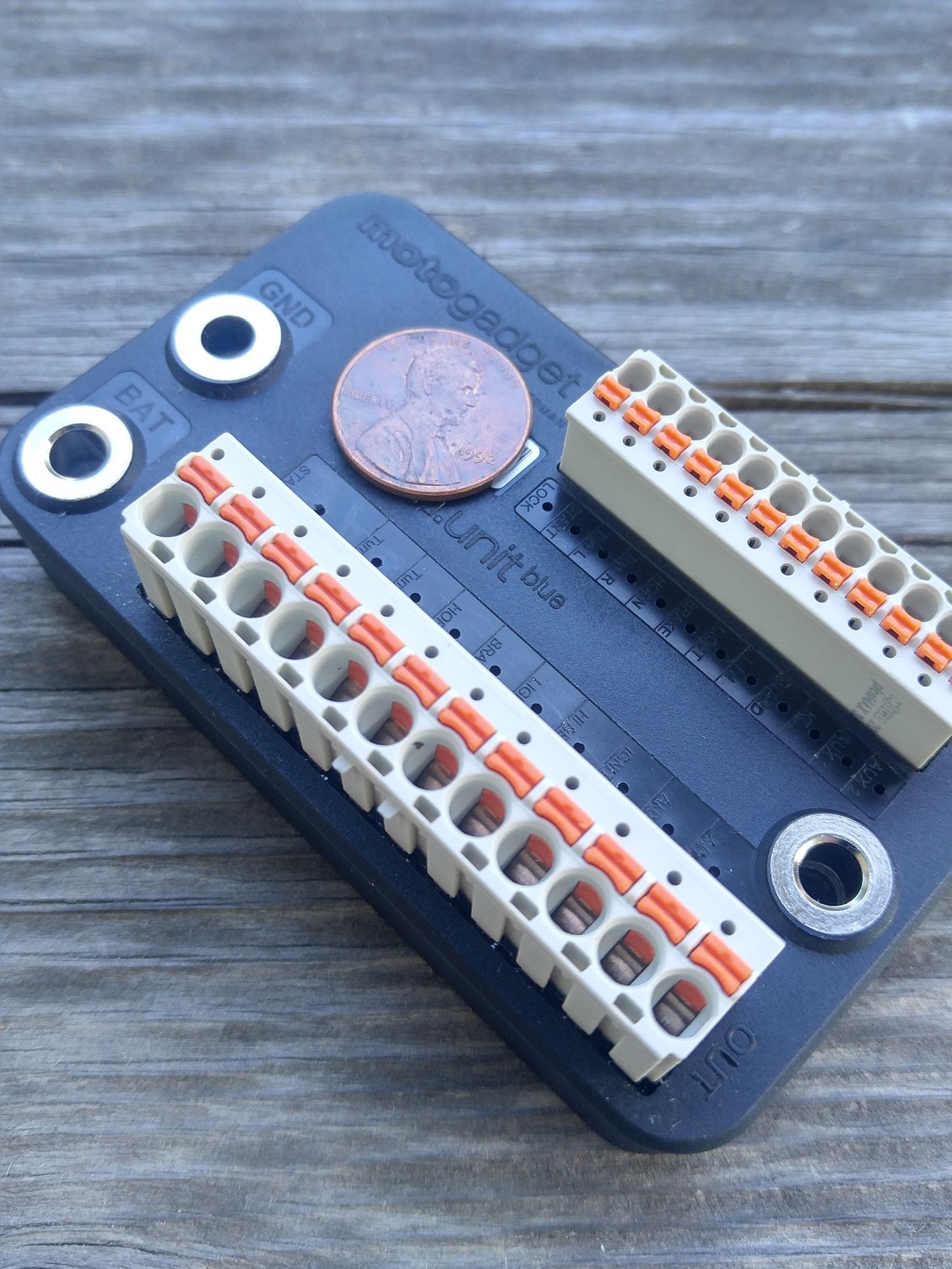

Got the new M.Unit Blue today. They completely redesigned the chassis. The entire thing is cast aluminum. I've never seen such high quality casting. It's remarkable. The chassis is smaller and lighter and the connector busses are industrial style top-load pushbutton locking.
m.unit v2 and m.unit blue
