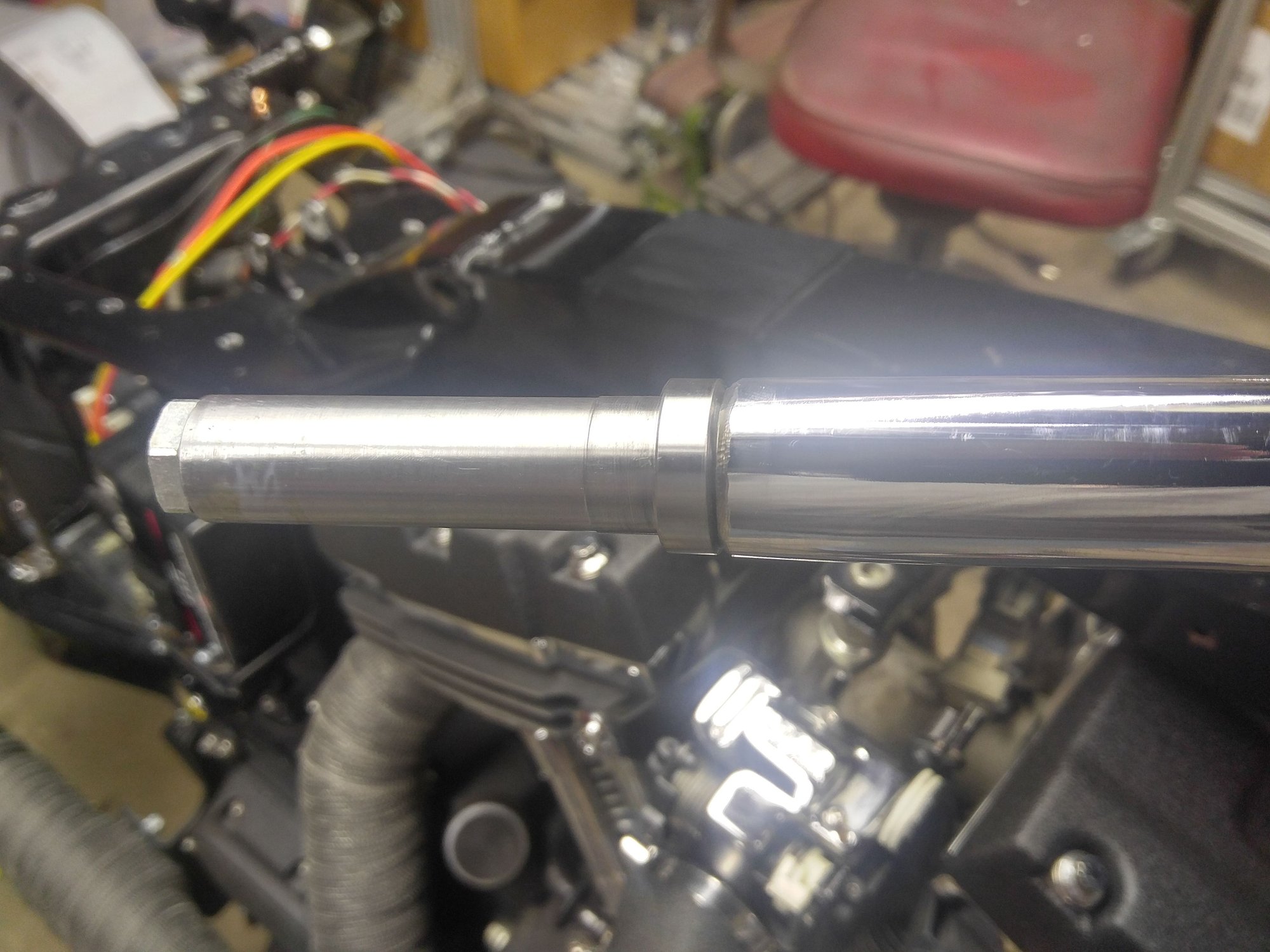

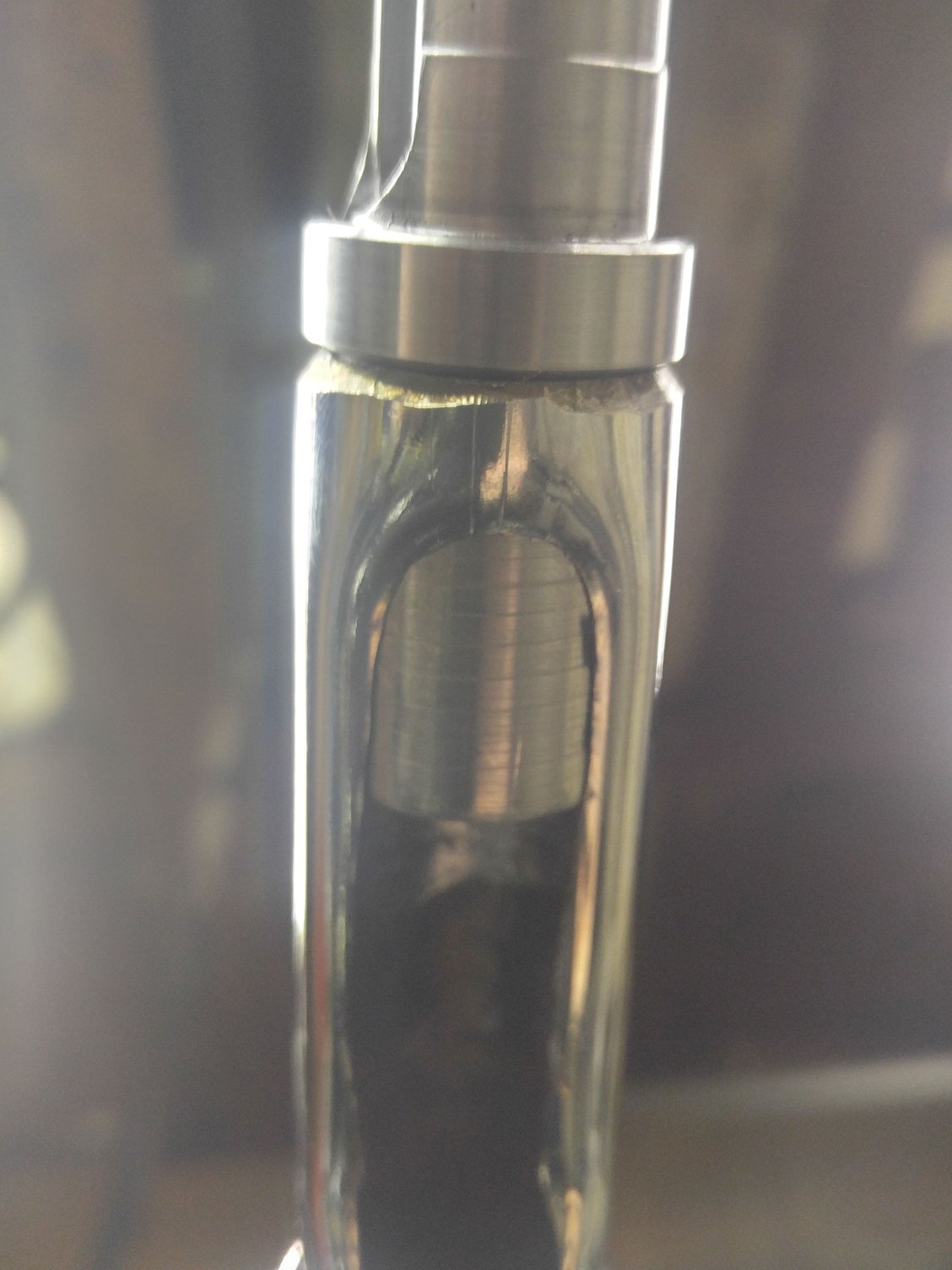

Throttle half-installed. I'll try to get it welded tomorrow.

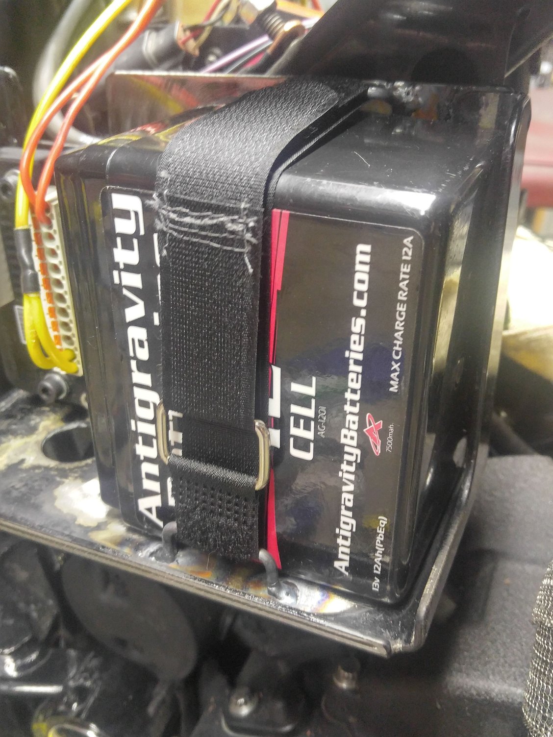

Battery & M-Unit mounts finished. Still need to do some finishing work. Grind, sand, paint obviously but I'm also thinking about cutting out a bunch of lightening holes and adding some CF panels in their place...cause, why not? Need to find a better strap for the battery. That was all I could find locally.

Broke out the sewing machine (be scared!) and shortened the new battery strap. I'll hit the gray thread with some black marker before I cover everything up. Much better than the first version...my poor sewing skill notwithstanding.

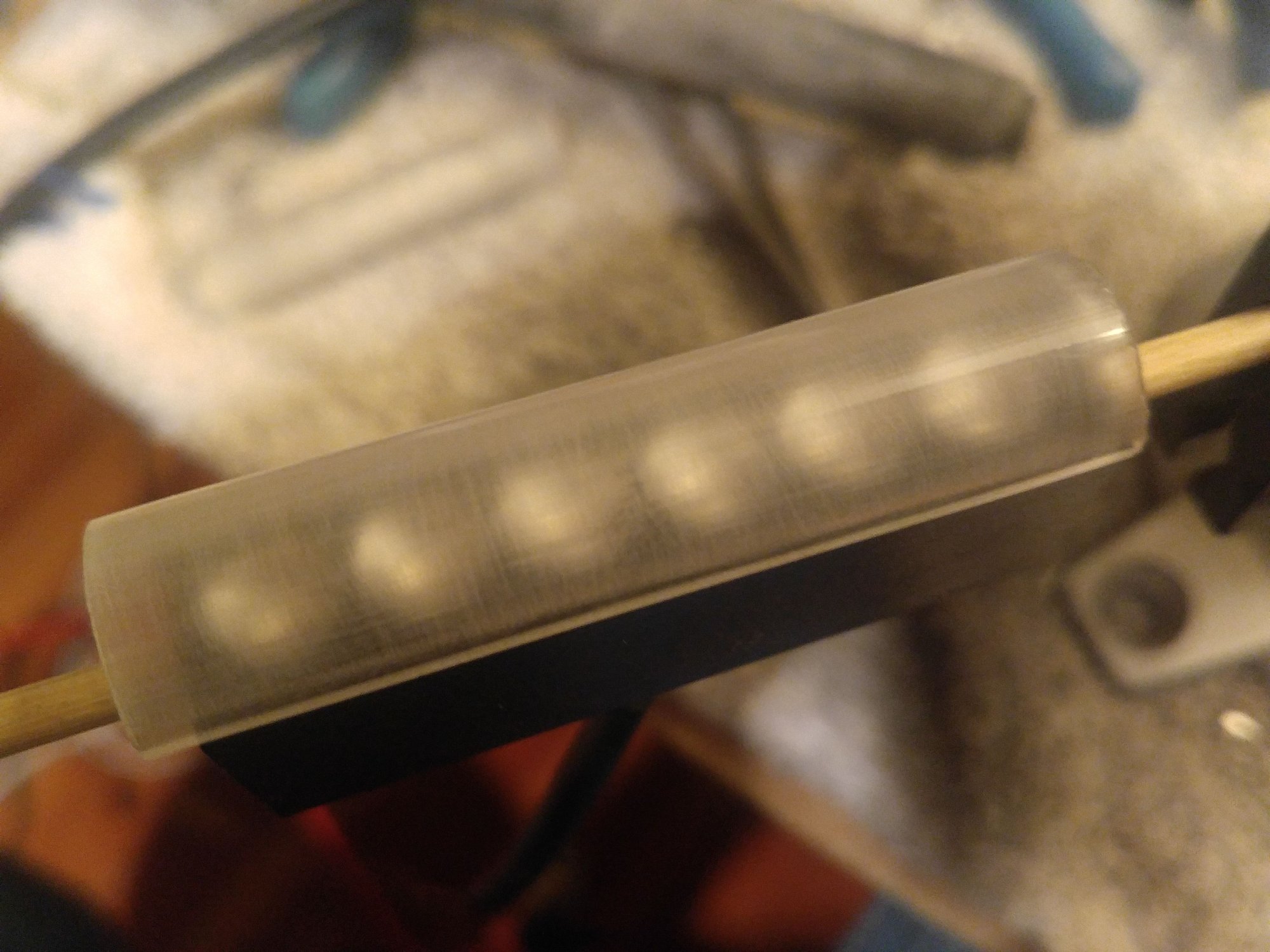

1/2 x 3/4 x 2 aluminum channel and acrylic lens trial. When I started this morning I decided to scuff the lenses, but I think I'll try them polished now that I've got the channel where I want it (finish-wise).
I mis calculated the height of the diodes so they protrude above the face of the channel a bit. That prevents the half-round from setting properly, so O ordered some ball end mills to cut a clearance radius.
No lens, diodes at lowest possible power (.001 amps)
Half-round lens, diodes off.
Tubular lens, diodes off.
Half-round lens.
Tubular lens

are you adding something to prevent rearward movement of the battery? looks like it is trapazoid-ish and will get free from the strap.

Done did. It's just not visible in the pic. I made three of those wire loops that the strap threads thru. The third is welded to the back wall of the battery tray.
