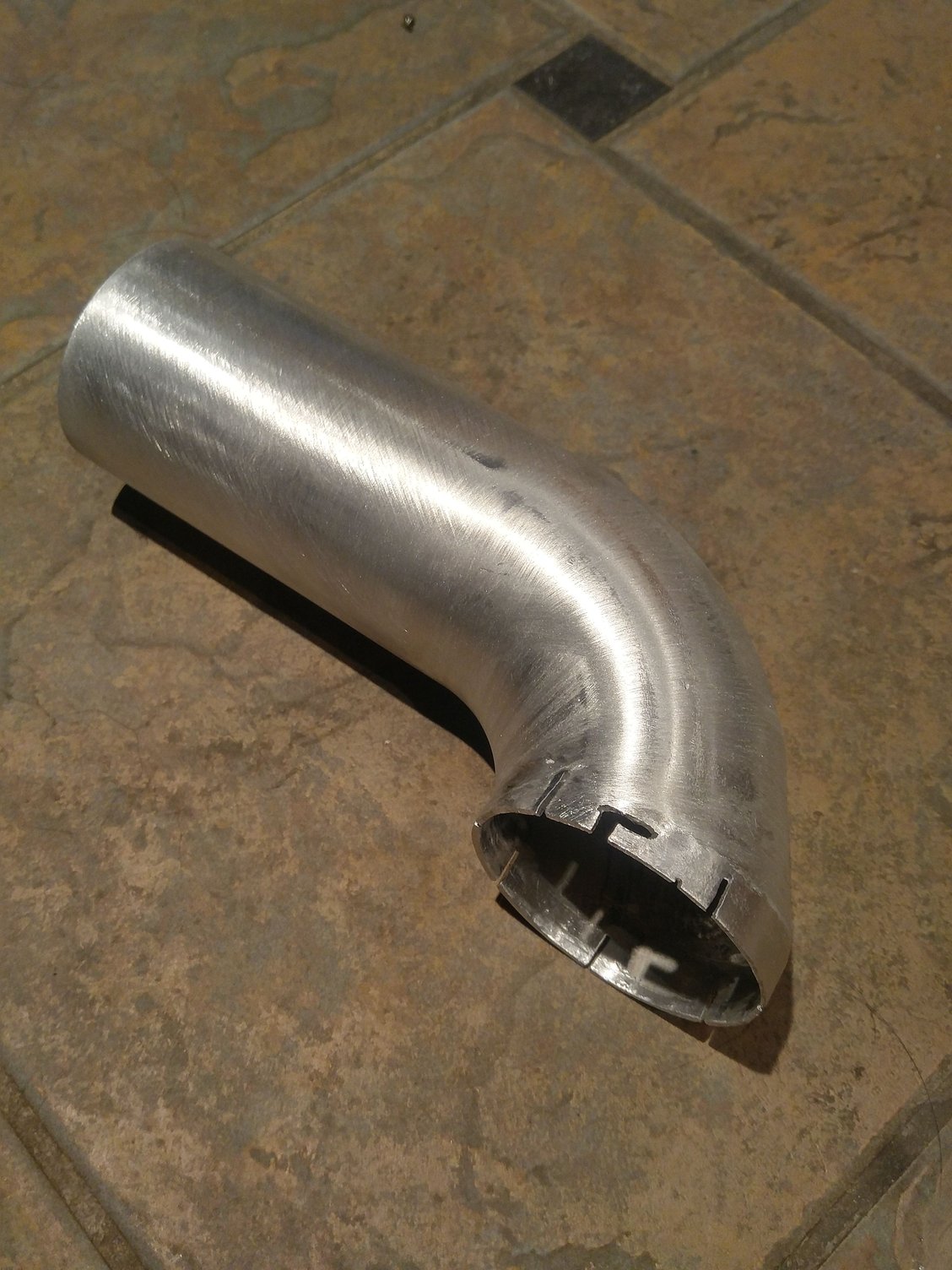

Air cleaner induction tube is mostly fabbed up. Still need to adjust the length, make some fine adjustments, and paint/PC.

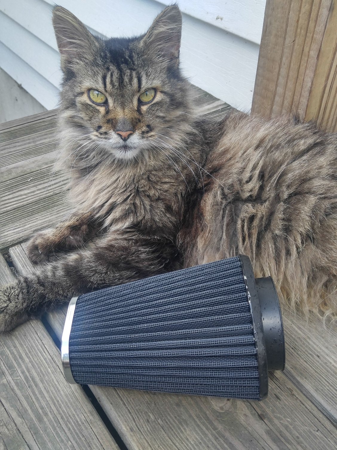

Ran out and picked up a 6" chunk of 2.5" round 316 stainless ($43) and made another black K&N filter ($2 + filter)
Degreased thoroughly then an hour soaking in 150 degree water with a box of black Rit and some salt. The cat is not impressed. I think I'm gonna buy some black filter oil to see if it will darken up some more.

Absolutely beautiful cat!!
