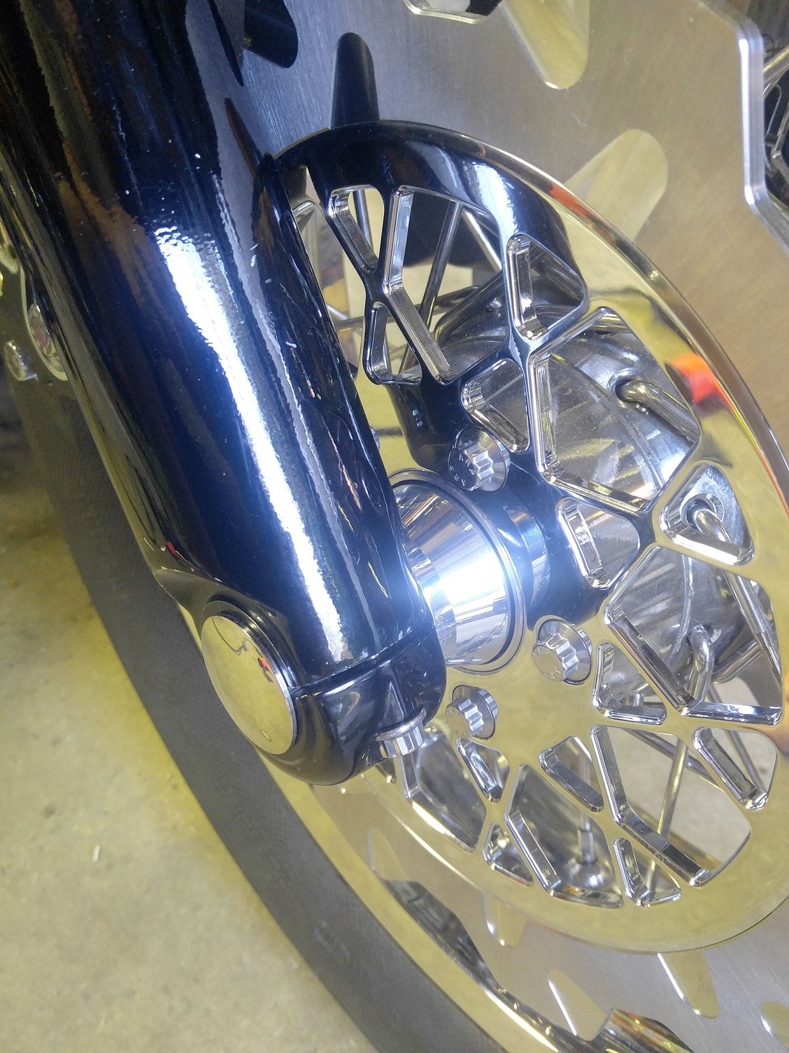

Got the Klock Werks flush axle blind nut pressed in finally. Had to make a rubber faced press anvil and press it in with a hydraulic press. The nut and wrench method wasn't working. I was afraid I was gonna pull the threads out of the blind nut.
Cleaned and polished the trees, neck, and lowers.
Final install of the front wheel.
Still need to touch up some paint chips on the RH lower and finish off the brakes before I can check off the front end.

Super sanitary! It's amazing what the whole impact is when so much attention is paid to areas that most people take for granted...

Big mean tire looks good with the evil rotors

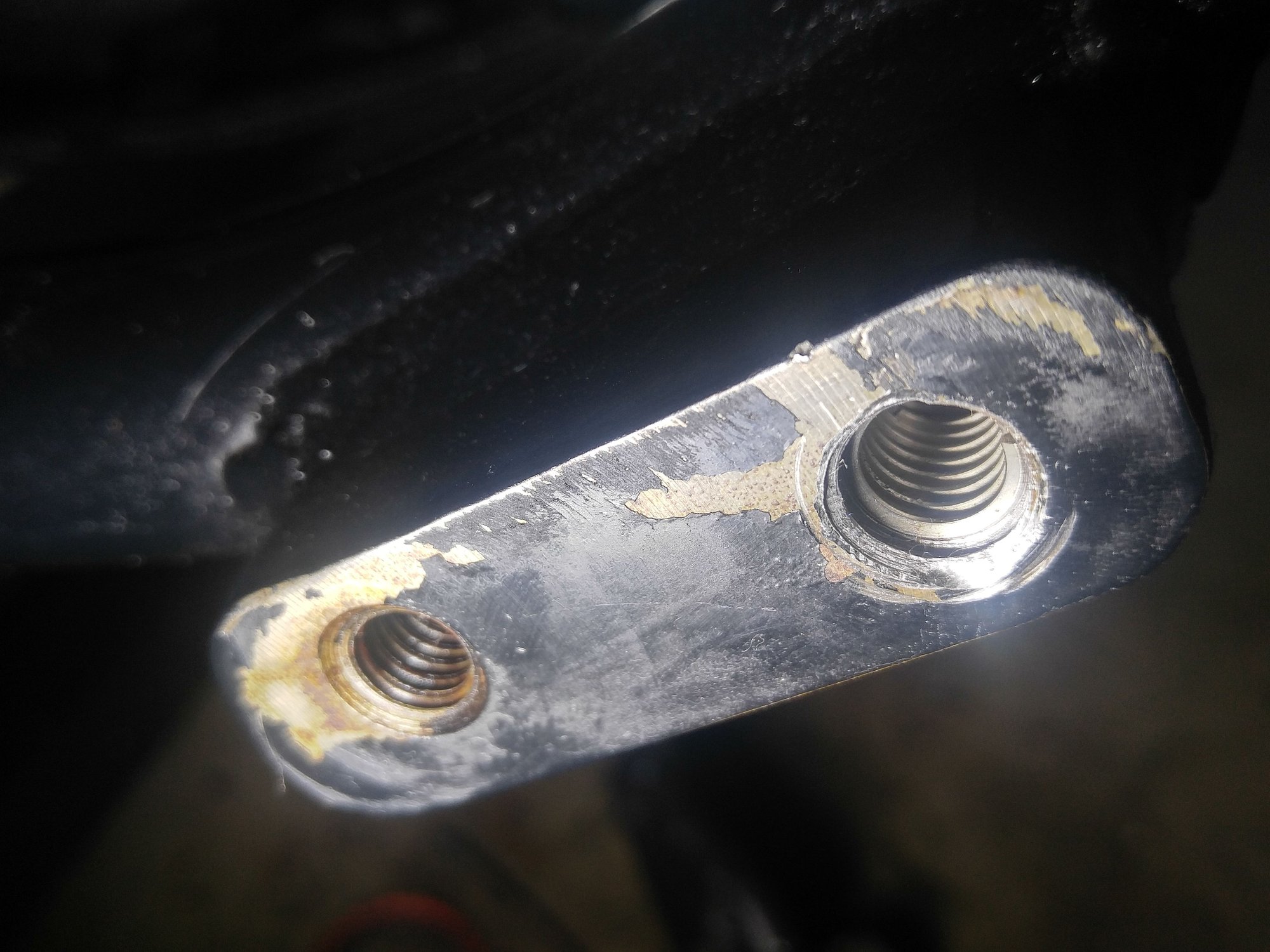

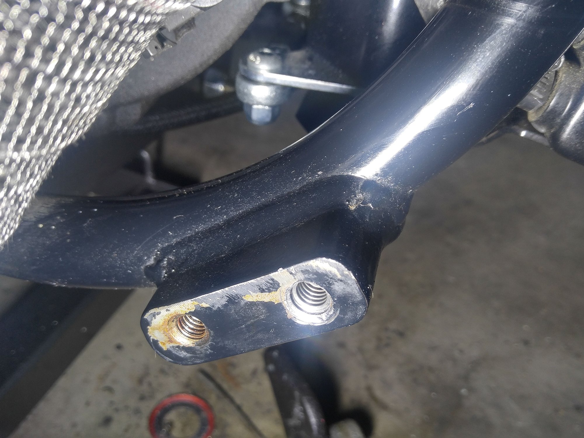

Spent the first half of the day removing the sheared off bolts for the RH foot control bracket. Made a drill bushing so I could get the drill started center and straight. That went great!
Got'er all drilled and hammered in the easy out.
Wouldn't budge.
Applied heat slowly until the powder coat started to blister. Tried again. No joy.
Applied more heat and tried more torque. Went until the easy out felt like it was springing and gave up.
Drilled out the majority and then broke out the die grinder. Tried to stay out of the threads, but didn't do real good.
Chased the remainder and blew it out. Tested a bolt and it wobbled a bit. Would probably have been OK, but not taking any chances.
Spent an hour running to town and looking for 3/8-16 Heli-coil. Got that installed, so she's good to go.

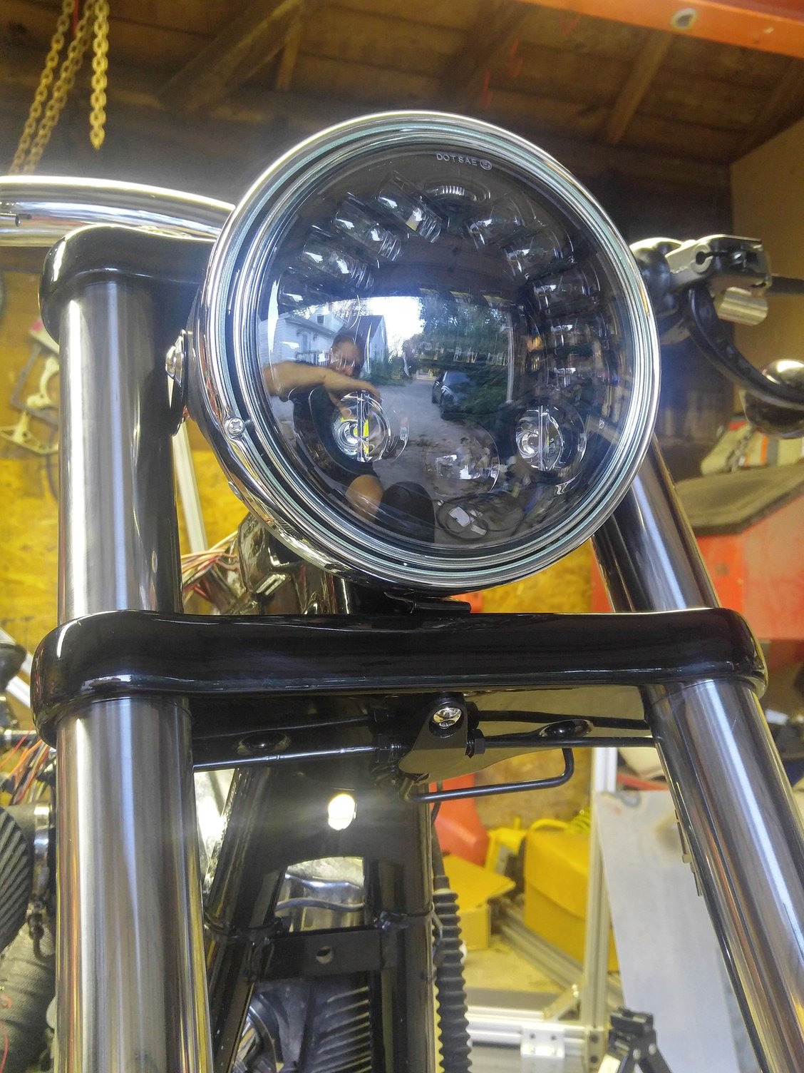

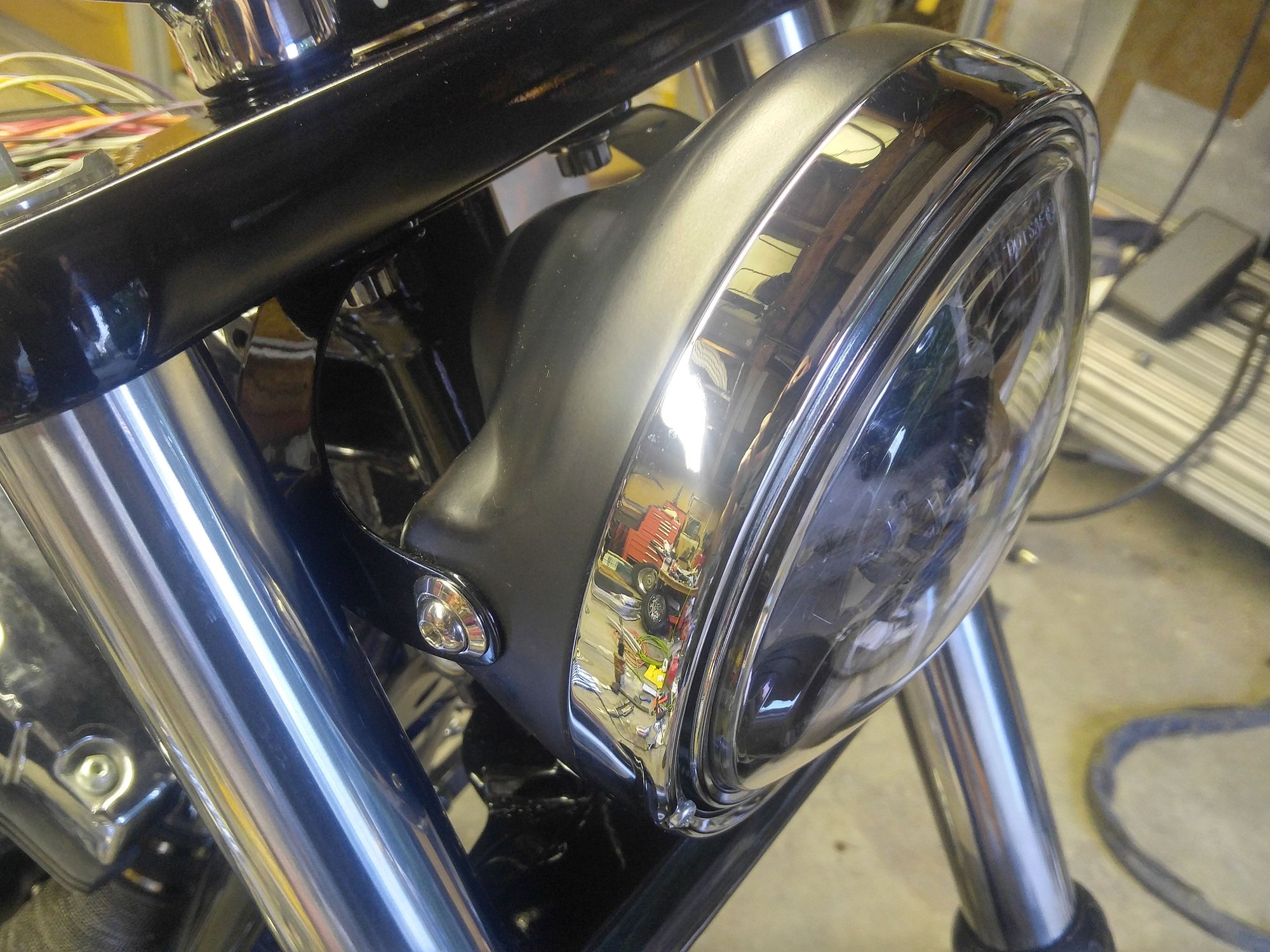

Spent the rest of the afternoon polishing hardware, then final install of the headlight, handle bars, and freshly painted brake line tee.
