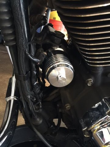

Perhaps start with a high flow oil filter instead an expensive oil cooler.
http://dkcustomproducts.com/OUTLAW-H...K-OCOF-CRM.htm
But if you must have an oil cooler....check out DK Customs
http://dkcustomproducts.com/Sportster_c155.htm

These Twin Cams are hot running, too hot for their own good; there's not a single magic bullet to help with the heat but rather it's a series of things that if done together can help in reducing the heat.
A good tune, both fuel and spark. A Jagg oil cooler, an A/C that vents hot oily crankcase gasses to atmosphere, an exhaust that's not overly baffled, a tank lift to increase air flow over the heads, a permanent oil filter to help reduce parasitic engine drag, a coil relocation to help reduce rear cylinder temperatures, and fans such as the Wards.
No one thing will get the temperature down but when doing these changes, all of which bring temperature reductions to the table you can ride as hard as you want in high ambient temps and still keep your engine and oil temps down.
