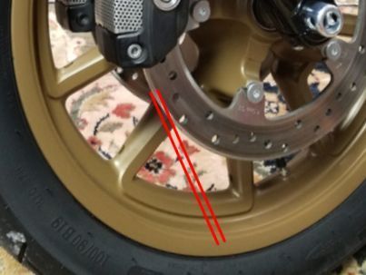

Originally Posted by Bahltech
I have read on these forums that the brake pads do not completely touch the brake disc when using the brembos on none brembo bikes. Something to do with the location of the mounts on the forks.
Can you please tell us if your pads are running on the complet surface of the disc ? If the caliper sits to high the top part of the pads do not run on the disc or maybe the angle of the caliper, cant recall what it was.
Thanks
It's not the "Brembo on Non-Brembo bikes" problem, it's a popular swap with an accompanying change to 11.8" (300mm) rotors except for 06-later Dynas. Only 06-later Dyna models changed the caliper mounting locations to accommodate the increase in rotor size to 11.8" instead of redesigning the calipers (like all other models) when changing from 11.5" to 11.8"
Thus you don't see it a lot on 06-later Dynas
The Poster should expect the Unswept area shown below to be eliminated and possibly the the pad to overhang the rotor slightly or least into the Radiused/Chamfered outer diameter. Either of which is not an ideal situation
