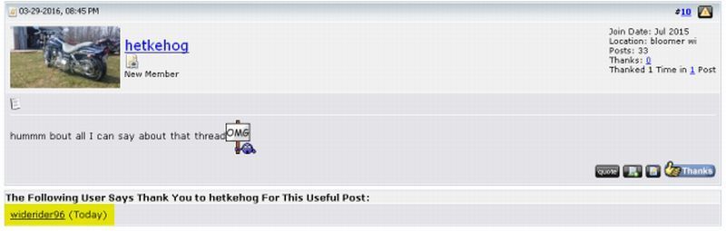

Originally Posted by hetkehog
hummm bout all I can say about that thread
Ok, that's funny
But that is funnier ...widerider96 is the OP
