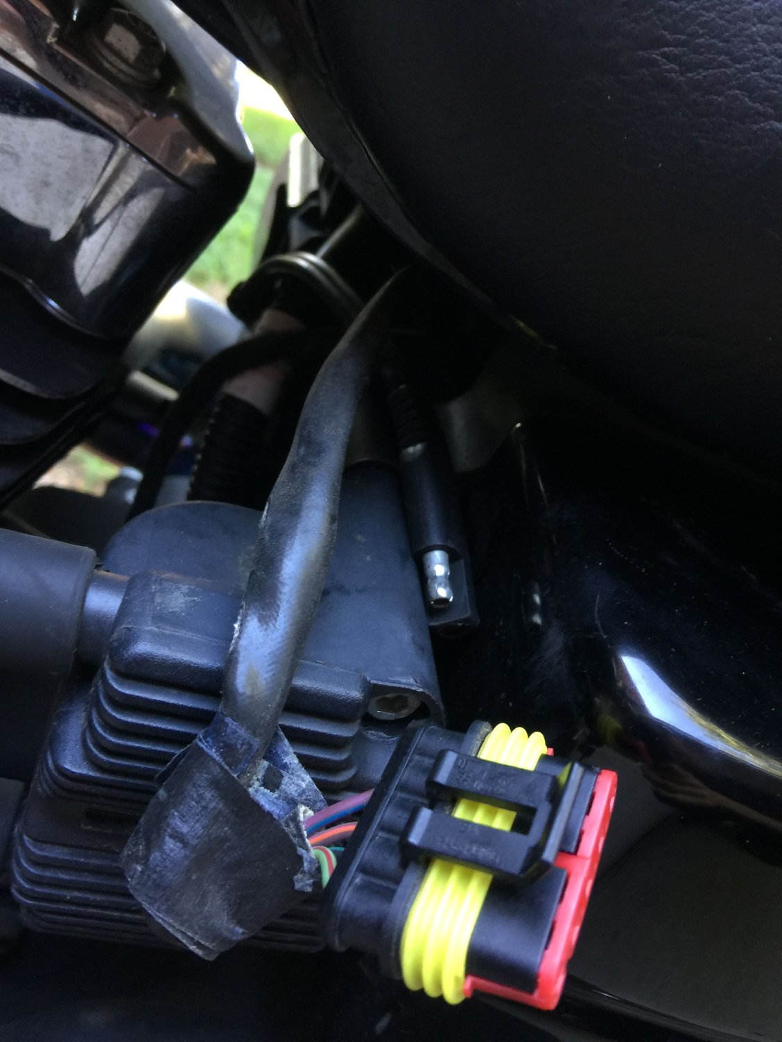

Ok so I was messing with my bike and o see this plug. It's capped but I'm curious what it's there for. It's a flat 5 pin connector with 4 wires in it. It comes from under the seat and came out by the heads.

A WAG but I think that's the connector for the actuator valve on the active exhaust that's used on the international models. It should have had a 5-pin dust cap on it, part #72553-07.
It's much like the active intake solenoid connector mounted behind the stock A/C; that's used in the international bikes but on the USA bikes it's capped off and forgotten about
Edited to add: Yep, that's what it is, the active exhaust connector
http://www.motorcycle-dynamics.nl/p/...TOR_14286.html
