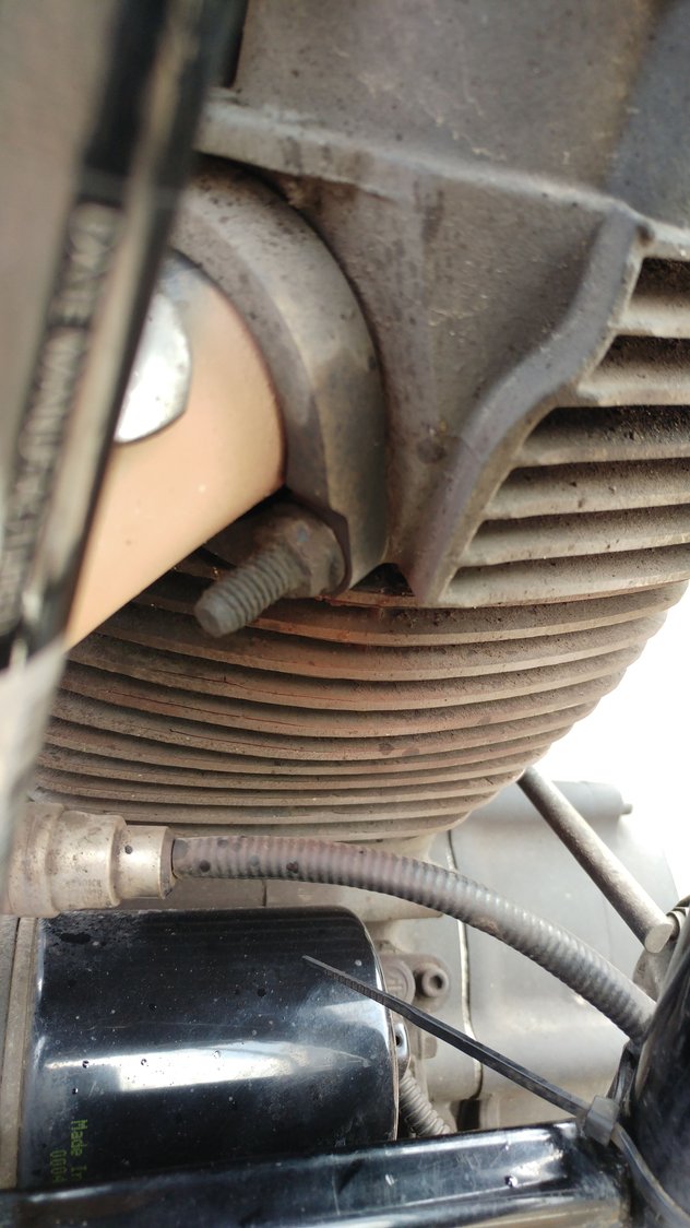

Here's some pics. I haven't attempted anything just yet, busy day.
You still reckon it's save able?

Pretty rusty (or maybe just dirty?). Assuming rust, I'd suspect the studs came loose before those nuts, but it's hard to tell from here. I would definitely clean them up as good as I could with a steel brush then soak them with a good penetrating oil for a couple days before I made further judgement.
Those studs are WAY longer than the ones on my '99. Did they make them longer on the newer bikes?
