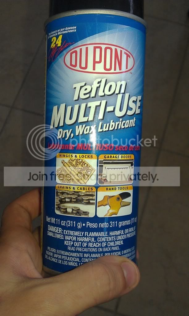

This is what I've used for years on my throttle cables on my sport bikes, track bikes, and HD's; I get it at Lowe's. I have such a sense something is binding, it's either in the throttle cables or the switch housing...
Two Lowes so far and neither have it. I'll buy this or CG's suggestion DriSlide off of Amazon I guess. Tonight I am going to pull the A/C and take the switch housing/grip apart and see if I can't figure this out. Was hoping to have something to lube the cables with when I took everything apart

Can't find it? Wow, glad I stocked up; that was my go-to chain lube. It does help if you can see the throttle body as you adjust the cables.
Adjust the cables for maximum slack; after you've lubed the cables start with the idle cable first. Adjust it so that there is no slack when the throttle is held closed and tighten the locknut. Adjust the throttle cable for your desired amount of freeplay at the grip and tighten the locknut. Check operation; hopefully your grip will start snapping back cleanly like it should
