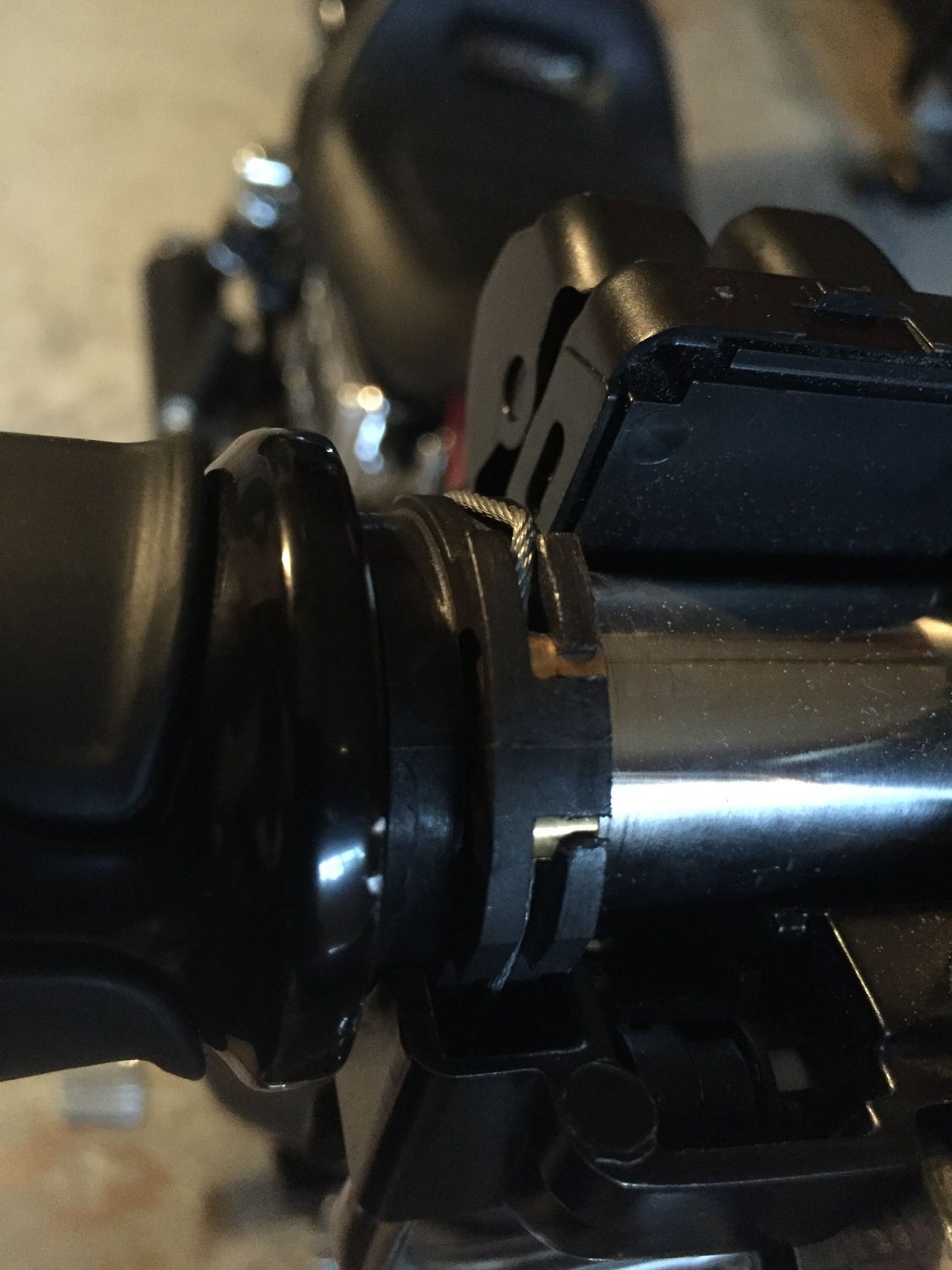

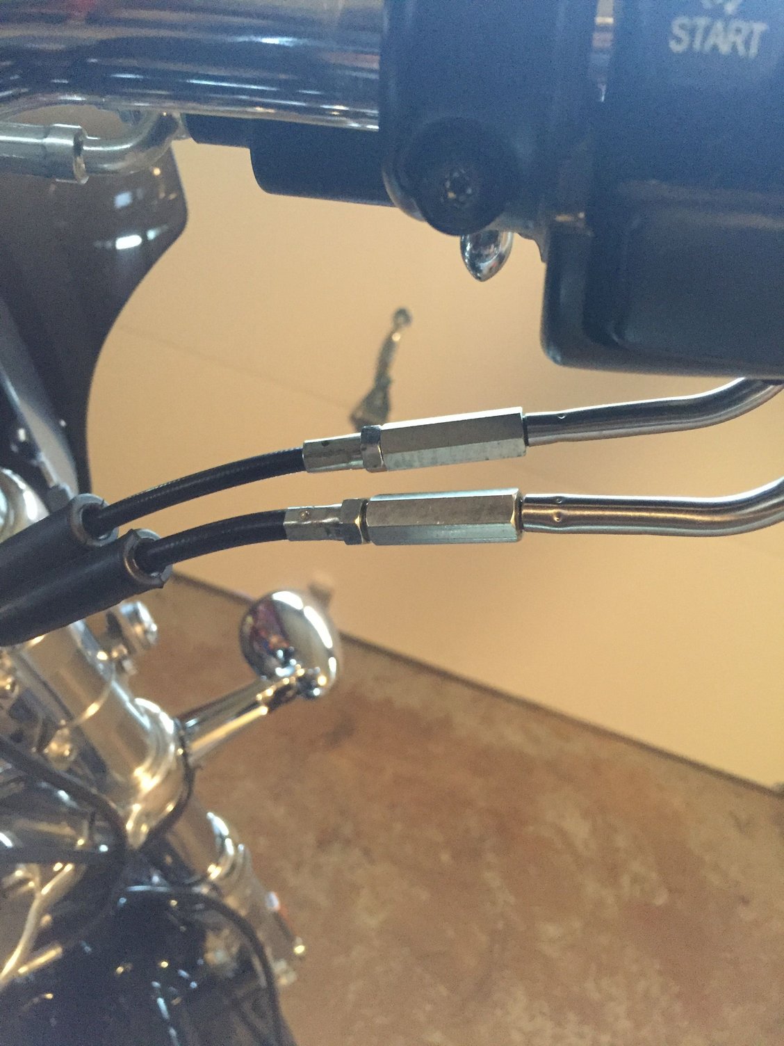

So this is what I got. First pic is showing the adjusters are full down. Second pic is a shot inside the switch housing facing towards the rear of the bike from the front. The kinked cable is the idle cable right below where the ferrul (I'm sure its spelled wrong) is in the hole. Third pic is showing with everything loosened this is fully closed. If I roll the throttle forward to place it in the fully closed position and start turning the idle adjuster I can get to the point where the adjuster fully unscrews and there is still a tiny bit of free play. So I screwed it back on a bit. Then I went ahead and adjusted the throttle cable. By the time I had gotten it almost to the throttle stop there was zero return, it was WAY too tight. I know this is far from rocket science but I can't seem to get this right.
Maybe it's just that kink. I guess I would need to replace that cable. I'm going to try two other powersport stores that are around the area and see if they have cable lube tomorrow. If so I'll try and see if it makes it any better.
