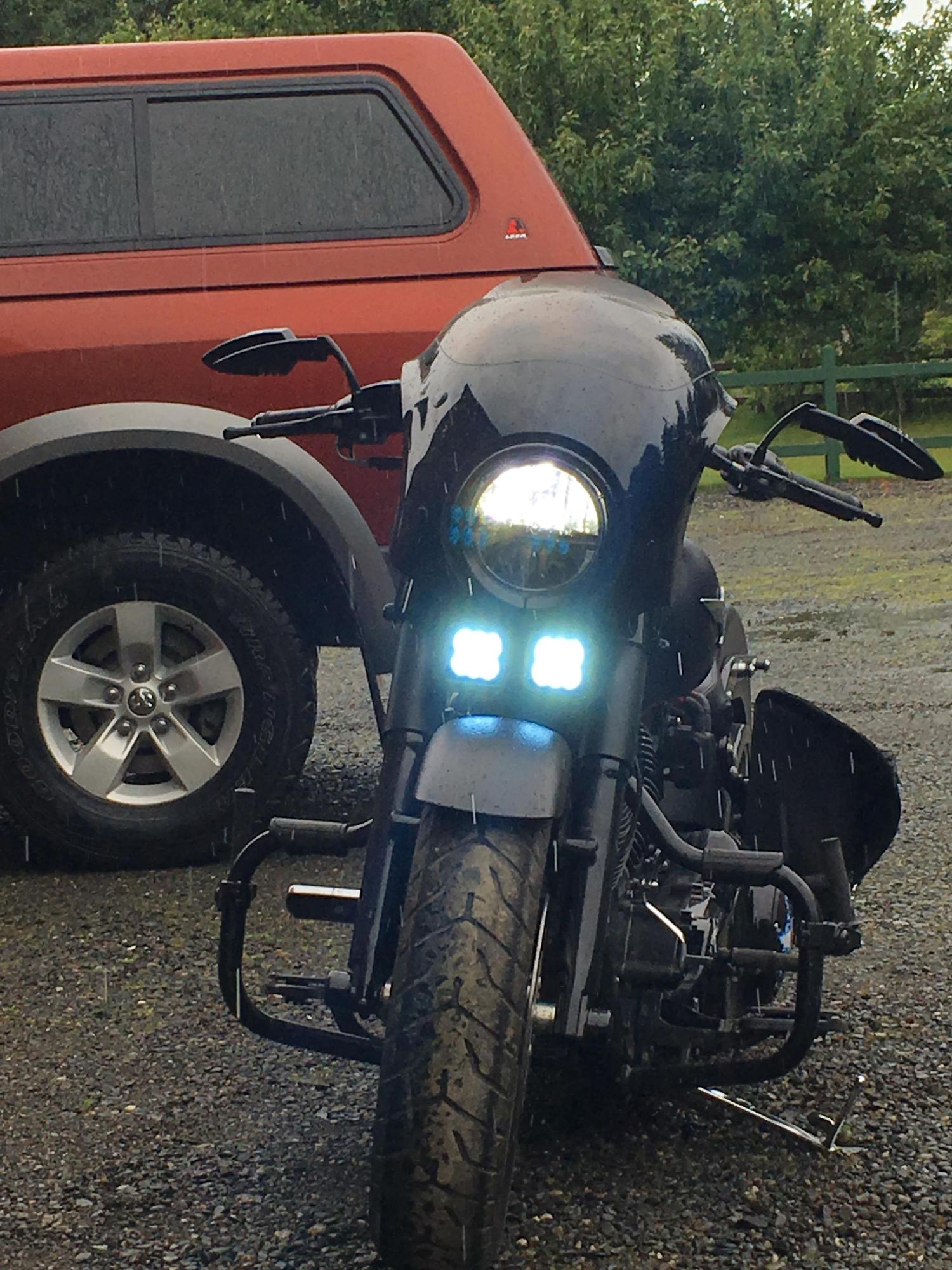

Not on a Dyna, but I mounted two Rigid D2 hi/lows to my Lo. Used a 5 pin relay with normal open to the low beams and the other pin to the high beams. Relay is triggered by the high beam circuit, turning on the high beam driving light, once relay is opened (low beam switch, the cubes revert to low beams.
