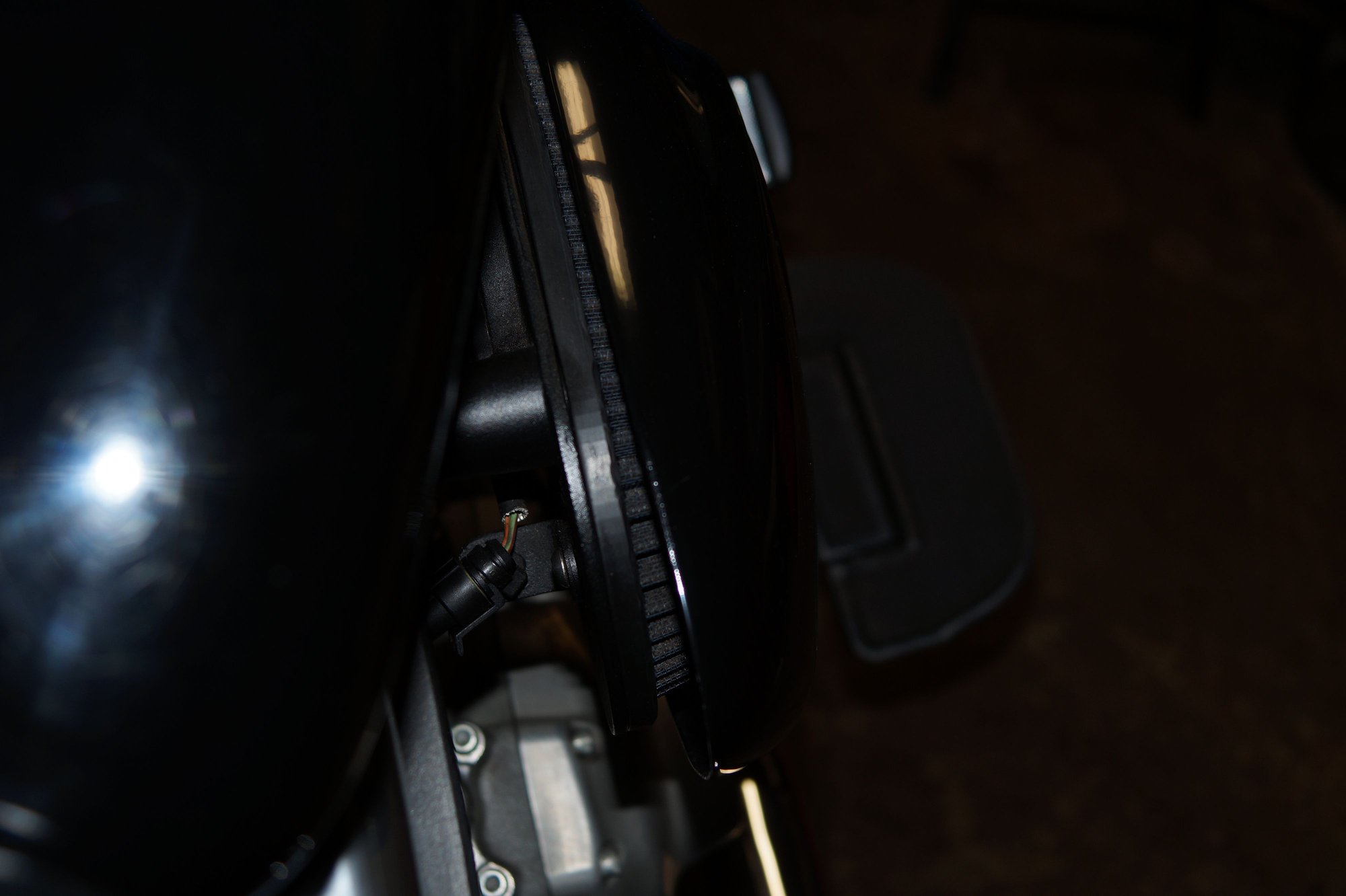

I don't see how the stock cleaner is that restrictive. There are two large openings on the front then the cleaner has full access to all the air that comes thru it. I re-routed my breather venting to atmosphere this morning and the newer boxes are much more open then they used to be. I'm keeping mine also, there's not a damn thing wrong with it.
This is what I did and it works perfectly and the box breathes very well.
