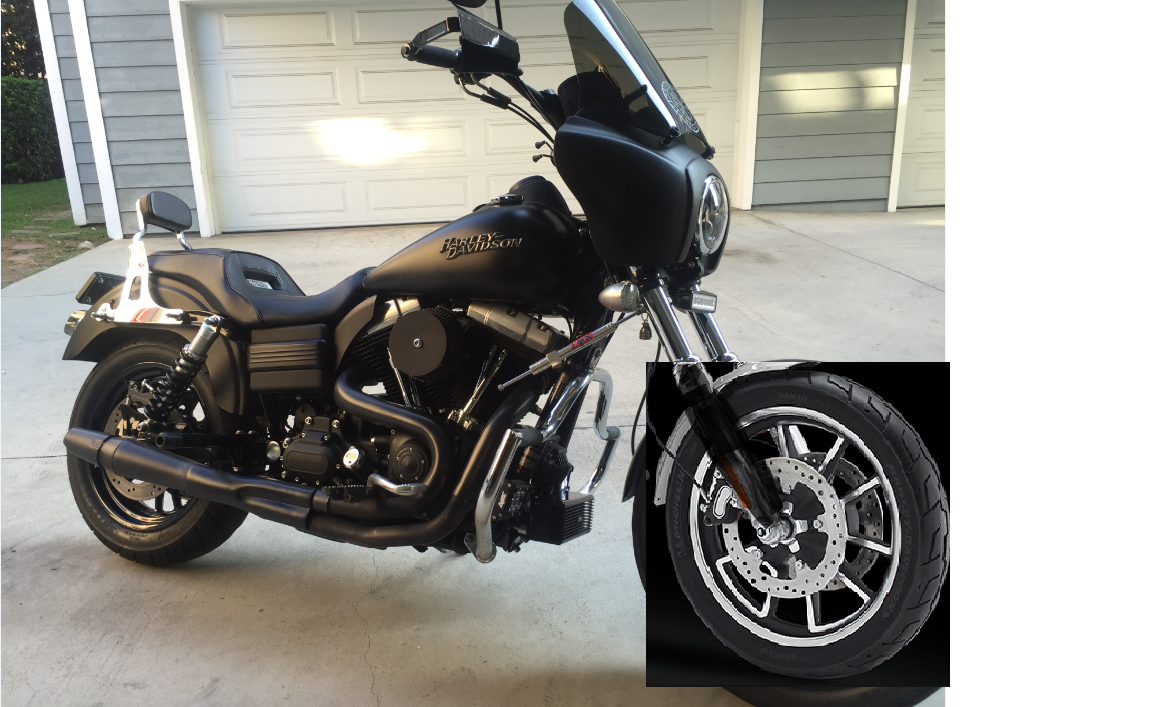

I'm slowly collecting parts for dual disk upgrade. I have single Tokico, and it was great improvement, but it seems that braking from 90+ mph is still a sketch. So will add another one
Got fork sliders from fat bob - don't see where machining will be needed. Based on what I read it was only fender fitting differently
Brake line - you can actually run second line from master using dual line banjo bolt - did it on sportster and it works awesome, some are saying better than splitter
Another tokiko adapter from SM and caliper off ebay
11/16 master from there as well
just did forks rebuild with cartridges - so only seals
I'll need is to swap wheel - my switchblade takes only one disk
Thinking between these two
