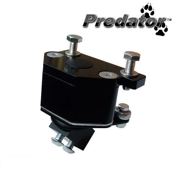

So last weekend the front motor mount of my new bike (2011 FXDC) went bad and I allready knew that they are two different models of Predator Motor Mounts depending if your bike has a Twincam or an Evo... but my question is why is that since the oem front isolator mount hasn't change 47583-90B, what HAS change is the bracket that attaches the isolator to the engine.
Could it be posible to mod the EVO Predator Mount to fit my Twincam engine?

But are they really tuned differently for the Evo and the Twincam with different components?
Evo model
Twincam model

It the motor mounts on the case that is different from evo to twincam. The mounts top mount plate it the only difference

The evo will fit the twincam but the twincam won't fit the evo. The case mounts block the hole

Because I'm selling my old bike and wanted to put it on my new one... btw I just mount it today, no problem.
