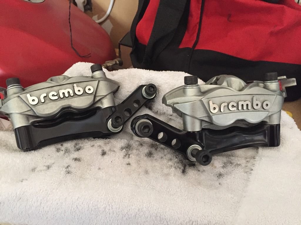

Got the calipers cleaned up a bit and mocked up. Can't wait to get them powdercoated. Still have to pick up a 11/16 master, brake lines, and a rotor for the right side but it's starting to come together!

Not a big deal now, but I think you have the calipers reversed (side for side). Your brake lines/bleeders should be UP
...but going to look good
