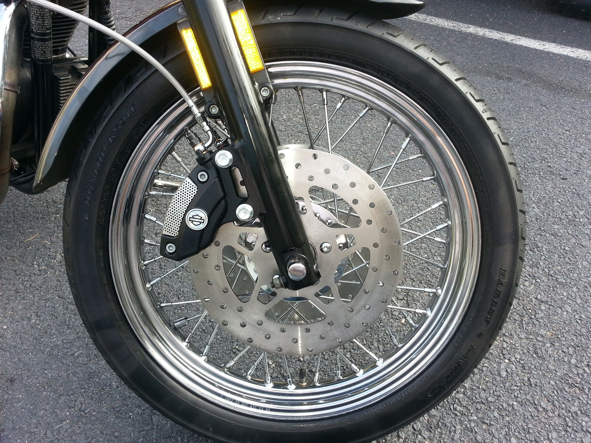

Not a big deal now, but I think you have the calipers reversed (side for side). Your brake lines/bleeders should be UP
...but going to look good
You are correct sir, fixed that when I took the brackets off so I could take it out for a rip since the weather was halfway decent today. Put it back on the correct way and measured for the brake lines. Should be on the way tomorrow and searching for a master and rotor now!

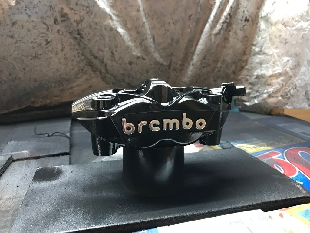

Powder will be black except the logo which will be polished. Calipers really arent that bad I picked these up for under $250 with shipping. Its all the stuff that goes along with it that gets expensive. Brake lines, fork legs, brackets for the calipers and the master cylinder. All in all Ill probably have around $650 or $700 into the front brakes but you cant get much better than brembo monoblock calipers! If I were to ever have trouple on the road all I have to do is find a Suzuki dealer and ask for parts for a 2014 GSXR 600 or 750 as well.

Well I got my stock levers cut down and powder coated today. Dropped them off at 1:00 and picked them up at 4:30 hows that for quick service! Also polished up the logo and painted the calipers tonight and I have to say they turned out incredible!
