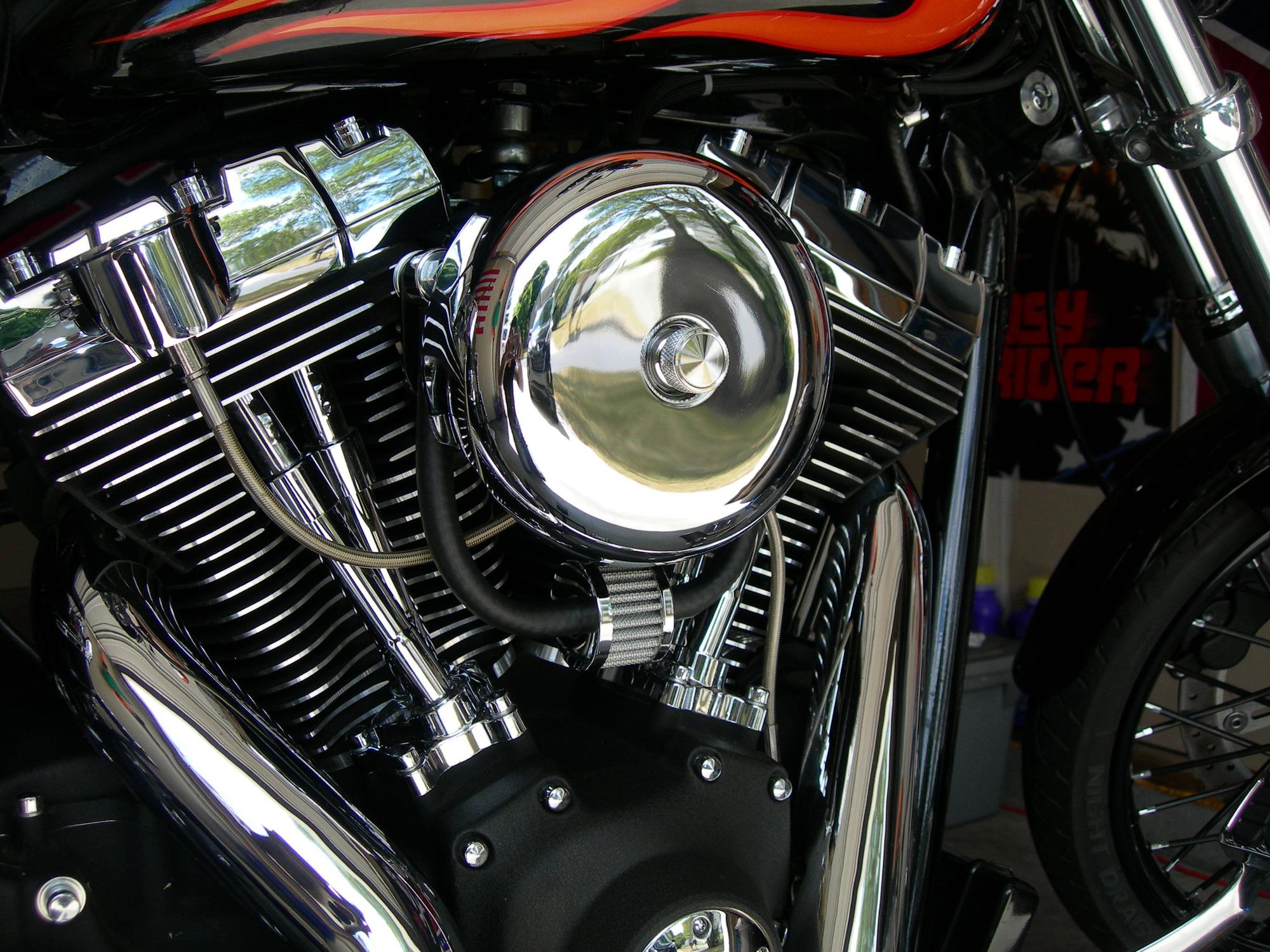

I went with the FP3 but I got it on sale for 280 bucks. They're now like 400 so at that point I'd go for the PV. I also have the DK custom AC. Here's how mine looks. I have a t connection that goes to the external breather.
