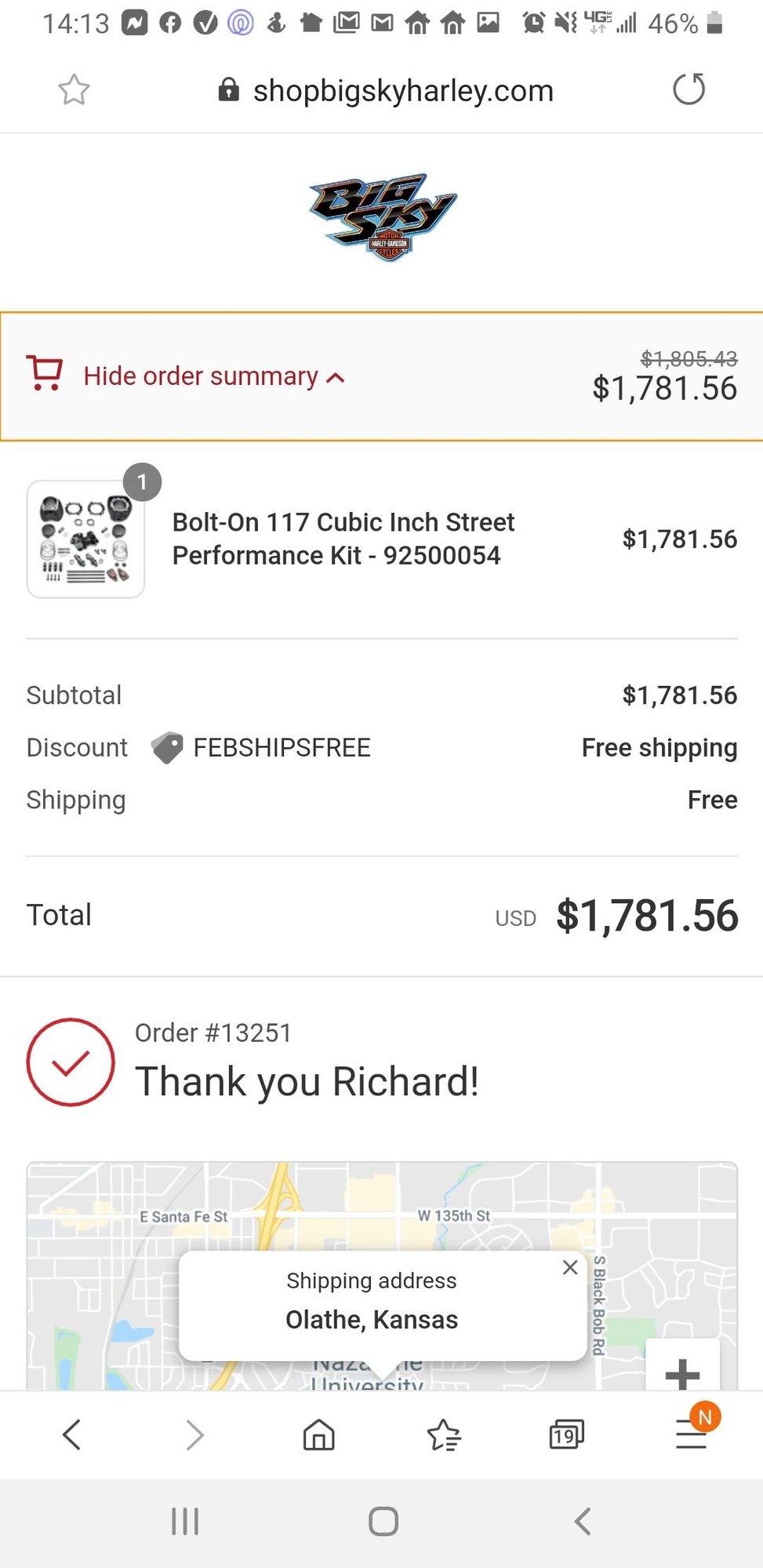

Got this FatBoyS and readyto do this 110 to 117 install via the HD kit. Can I get a Hell Ya! Love this information and post. Thank you sir For giving us this plethora Of information. Got a reasonable deal on the Kit and also had to get the Elite performance AC for it. Should be here Monday. I've already been using Power Vision and have the target Tune WB O2 'a I have to instal . Was pondering how to get the Compression to 10:1 and if by doing this via cos head gasket and decking if I would cause interference. I'll keep you all posted.

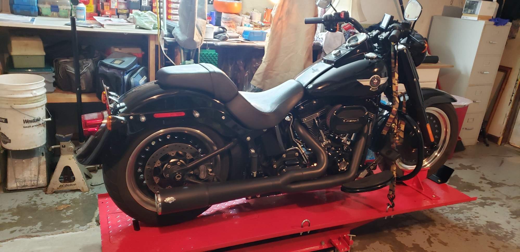

Default Update on my FLSTFBS 117

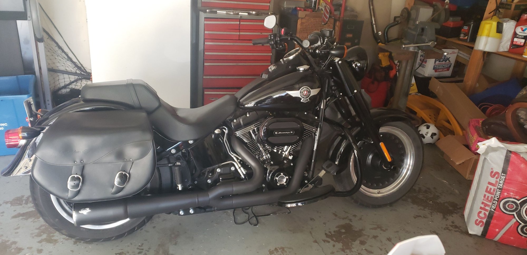

Got it all back together. I opted for a cam change on my 117. I chose the TTS-150. Cometic .030 head gasket and ported matches the heads. Also swapped the lifters for Slow bleed downs I believe most call them B lifters. Thanks for the write up again. It gave me the courage to tackle this. I just have to slap the tank on and Tune with the TTS.
