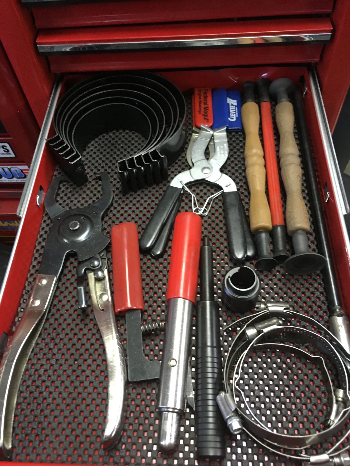

thank you, glad it helps!! The new rings were within spec from the box. Just make sure you check your service manual and position the ring gaps as instructed. Just a heads up, it will take some patience to get the Pistons out of the ring compressor and into the cylinders. At least it did for me.

Tip ........ get yourself a Hastings ring compressor kit they are the best I've used . I have a crappy knock off version of that too , it's such a piece of **** I may as well throw it in the trash. I've had the Hastings one for 30 + years . It would be impossible to figure out how many engines I've built , it's into the thousands now , I'm soon to turn 63 and have been doing this since high school .
