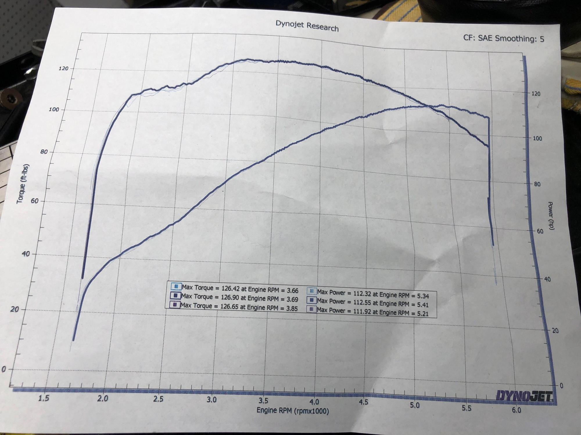

Default My dyno sheet
Originally Posted by Nickd2689
Badass man good job. Glad it helped you out. Bike is lookin awesome by the way.
hey thanks, I appreciate that. I originally had my heart set on a Lowrider S but the one they had there sold and so I got the FLSTFBS. I love it. I almost sent my heads off to be done. At the Dyno Tuner they did a leakdown and found that my front head leaks over 5% bad valve seal. Winter project as it's time to RIP my Ground pounder. Still pretty decent results. TTS-150 Cam put that torque down low. 110TQ at 200vand just climbs! Awesome the old But Dyno says Hell ya! And hold on!! GreatThread thanks a million
Hell yea man those are good numbers. Glad to see the end result!!! Thanks for sharing.
