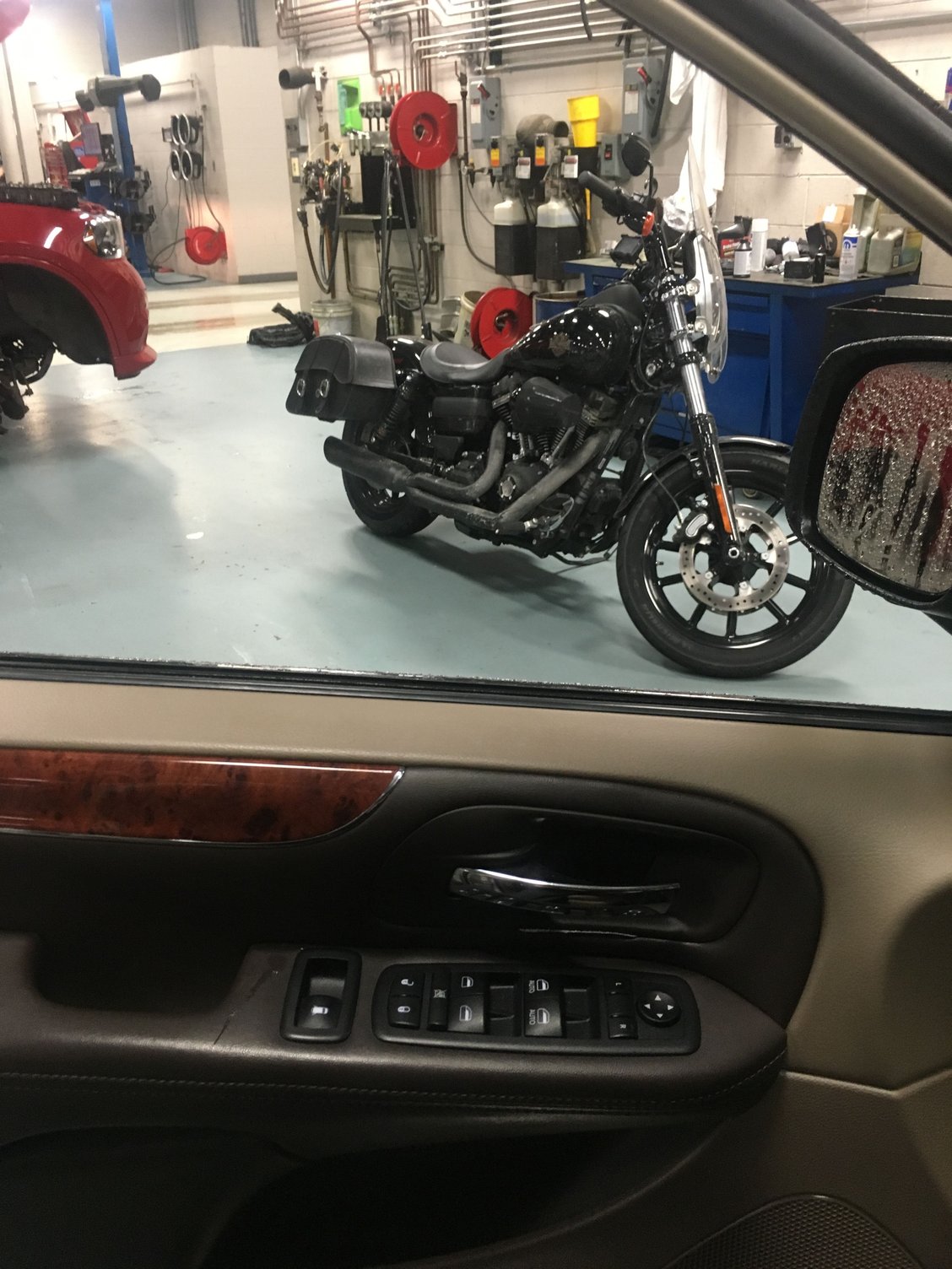

Shame to have it this dirty but hey, I wanted to ride today.
anyway I rode for 2 hours after work yesterday, came home with a 95.8 temperature and 100 miles. Still runnin strong. Now that I've put some miles on it I'm takin the rpms up a little further (around 3k) and auto tune is working out. Minimal decel popping in the learned rpm range, and you can just feel how bad this bike wants to go. As far as the temperature goes, don't give me ****, I've always ridden in the cold, and never had that happen before. Guess I gotta be careful.
