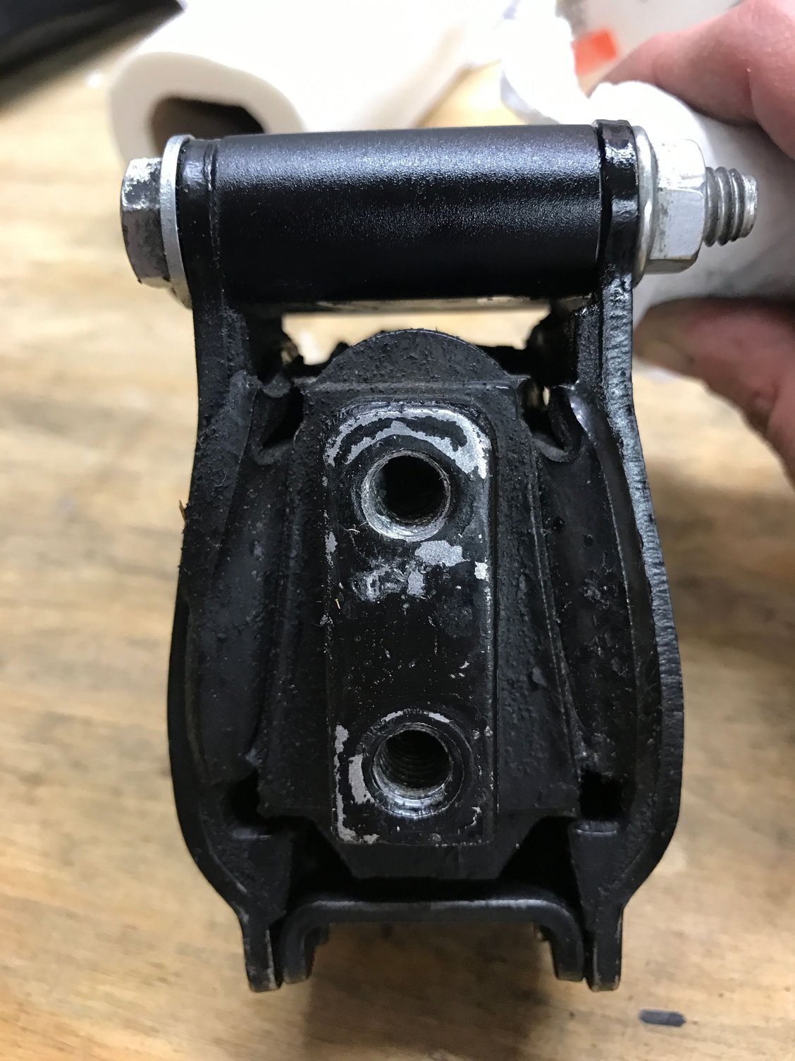

Got the new mount installed today. I still have to put my oil cooler back on so I haven't been able to ride it or even start it yet. It looks a lot stronger than the oem mount. While I had it on the lift I noticed that the fall away is jacked. I haven't looked up the specs yet, but I'm pretty sure it not with in spec. It just completely falls to the left side on its own. If I pull over to the right side it will hold for 3-4in then falls away. I'm gonna pull the clutch cable off and get the fall away adjusted while it's still on the lift. Anyways, here are some pics of the oem mount. I'm not sure if it still good or not, I don't have anything to compare it to..

Yep that is the real problem with motor mounts, they alwys actually look good, but the problem lies in the weakened rubber once oil get on it, I doubt that could be seen with a naked eye, unless it was ripped somewhere, but you will surely have your answer when you get out on your ride with the new mount installed, good info below.
