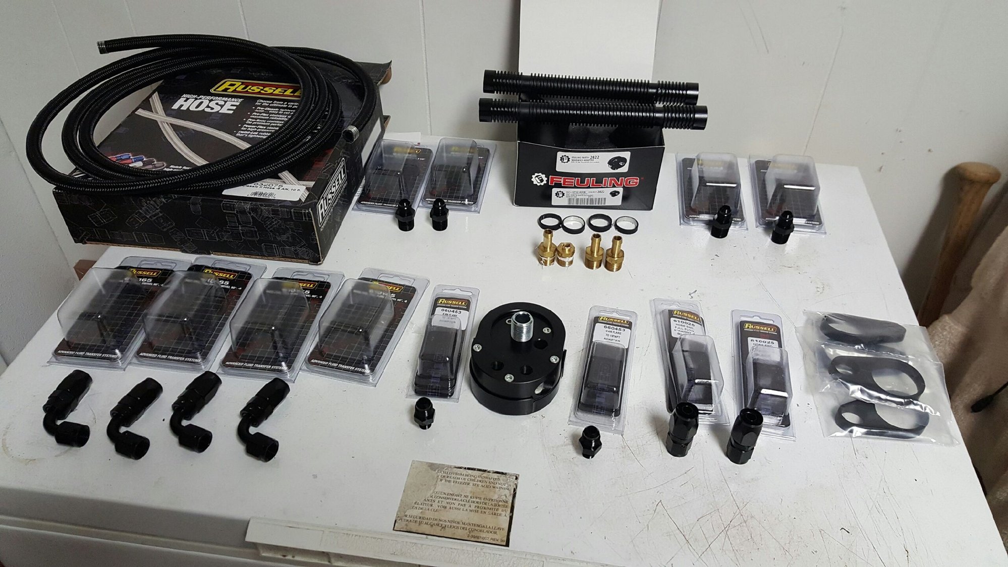

This thread is not about whether building a cooling system for a bike has merit - that decision's already been made
It also not about one supplier being better..., worse..., whatever..., than another - going the direction I'm going
It simply one way - one might go about tackling the task of cooling down a bike
Plan:
Add wimmer dual tube oil cooler..., w/ fueling filter off set - all plumbed w/ AN fittings
Add the lj mini fans
Below is a pic of the oil cooling system
The 4 - 3/8 npt to barb connections have been removed
1/4" has been removed from each end of the oil coolers to allow for plenty of wrench "bite" when tightening the 3/8 npt to -6 an fittings
After mocking up - this evening - I ordered 1ea
-6 an female hose - 45 degree
-6 an female hose - 90 degree
-6 an female hose - 120 degree
-6 an female hose - 150 degree
Some combination of above..., will help better route the hoses..., from the oil offset..., to the cooler inlets
iow - this'll eliminate sever bending of the hose in order to make the connections to each side of the oil cooler - from the oil filter offset
Mini fans were ordered Wed, Mar 01 - still no eta on shipment
More to follow as add'l parts come in
Grab a beer and enjoy the show
Ghost

Looks like a really nice collection of parts.
Will you be able to gather any temperature data from pre- and post- modification?
I've looked at those Wimmer tubes myself but just can't quite get there from where I'm at. (I've got a Jagg low-mount with thermostat valve). if the tube work.good and look like I think once mounted, I'd probably.pull the trigger.
Where I'm at, and how I ride, additional cooling isn't really necessary but I like the peace of mind and the bike came with the Jagg, so...why not?
Adding that I've also considered making my own extra-length finned tubes. Maybe if I get bored in a year or two...
I have a Longacre IR pyrometer - so I can..., and will Sir
I'll make it as controlled as possible - keep speed / run time & distance - as close as is possible
Also pick two consecutive days where temps foretasted to be similar
Make a run pre-installation..., measure temp - install - then make the exact same run..., and measure temp
Using the same measuring points front and rear cylinders..., and top of oil filter (I don't have an actual oil temp gauge)
I'll do this with just the oil cooler
Then again w/ oil cooler & fans
Ghost

Oil pan or crankcase would probably be a good place to get a decent IR temp reading.
Since we're only concerned with the delta, I'm not sure it makes a whole lot of difference as long as the pre- & post- measurement parameters are the same.
