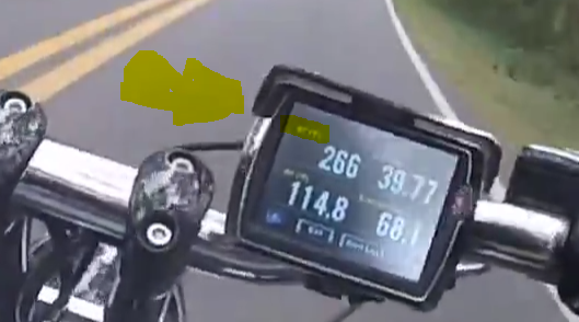

Mchad, can you measure oil temp with the PV or just head temp?
You could always cover the oil cooler or let it idle and see how the oil and head temps compare.

Unfortunately, you can't measure oil temps with the Power Vision; HD saw fit to only give us one engine sensor, located on the back of the front cylinder near the head. A completely dishonest number, to be sure; I'd like a sensor on the rear cylinder as well, that's where the flippin' heat is and the actual truth is.
Knowing that ET the Power Vision shows me is HD's Pollyanna approach I realize the rear is much hotter, so I proceed on the side of how low can I get those displayed numbers; an oil cooler makes sense to me, those fans may be lowering your observed ET's on the one and only sensor but I suspect that true engine temperatures are still much hotter than that.

However on my power vision, i don't see any oil temp or calculated head temp in the options.
it's ET. pulling from the head temp sensor

**** I'm running 240-275 (engine temp) without either one. At least these last few days with temps ranging 70-80 degrees. I was considering the opposite, and going with an oil cooler, then if necessary love jugs. Hoping that won't be necessary though. If I can get my temps to stay closer to 200-225 regularly I'd be happy. However on my power vision, i don't see any oil temp or calculated head temp in the options.
There is no oil temp option in the PV. There is an option to display ET and HT. They are probably both based off of the temp sensor in the front head. I'm guessing the HT reading is an actual reading off of the sensor and the ET reading is some sort of algorithm or derived figure based on the HT reading.
If you go to the gauges icon in your PV, there is a list of channels that you can display. HT is one of them, in case you want to view them both.
