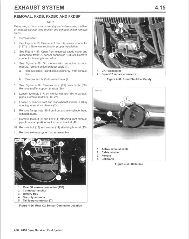

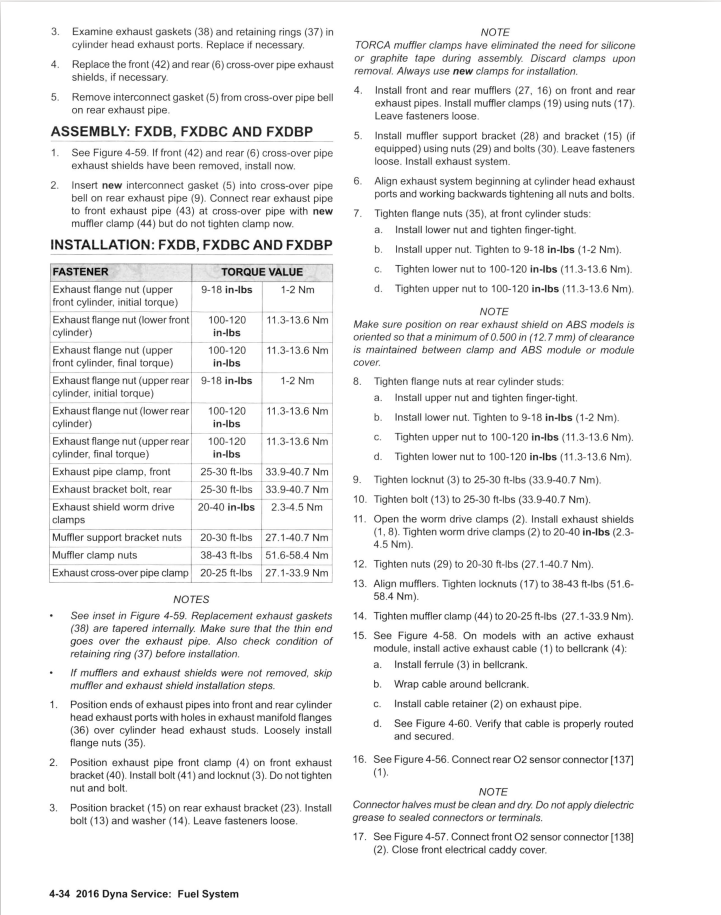

Hope this helps, and be careful not to bang the heads of the O2 sensors, otherwise you might have to get new ones.

From: California
Thanks for that. I do have the manual but didn't know about how delicate the head of the sensors was. I appreciate the tip.

Also do not get any antiseize on the heads or your ride will start throwing error codes, just put a tiny bit on the threads, and make sure you do not touch the heads with your fingers, and you will be good.
