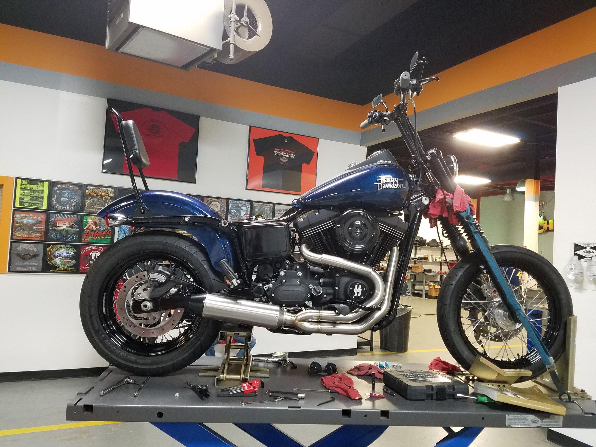

Pulled the exhaust off again to insert the proper bung adaptors. The stock 12mm lambda sensors will be used to get me home (only a 30 min ride). The next day my tuner should be in so I'll pull everything off again to Install the 18mm sensors. I'll ride the bike while I'm waiting for my bags and fairings that way i can tune it and be ready to ride and fully done hopefully in one month.
A little anti seize never hurt. One thing I did notice while reinstalling the exhaust is the anchor point for the spring was welded on backwards.
You can see the spring detent is on the wrong side. The spring doesn't sit right. It's the small details that sets the quality of bikes and builds apart. I may just end up notching it with a Dremel but it's not a big deal over all.
here is how my bike sits now. I jacked the rear end up to simulate my new extended shocks I'll be receiving. As you can see it's one ugly gap. But that's where my bags come in to play and once it has some weight on it, it shouldn't be too bad.
Ordered some new bags that are 4x less the cost of what I just sent back. Can't wait to compare the quality. I know for a fact the cheap ones will be better.

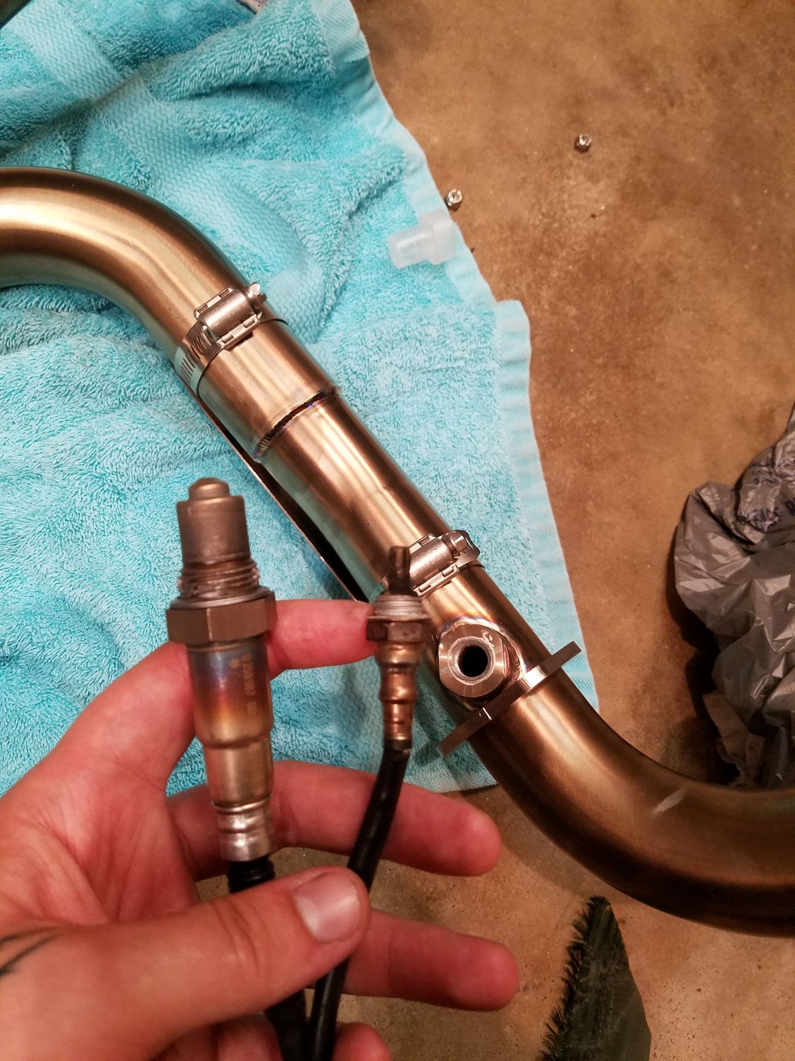

I ended up getting a powervision shop kit using my schools discount. The package comes with the powervision, wideband o2 sensors, autotune module, and connectors for the old j1850 and the new can bus system.
First thing I did was lay everything out. The kit doesn't come with instructions so unless you know this ****, good luck. It's actually not hard at all just use your head and you'll be good. The worst part is wiring the widebands to the autotune itself. It is straight forward but the system they used is stupid. The wires are pre soldered. they are stiff so you can push them through a rubber weather barrier and into a clamping mechanism. I had problems with the solder being to sloppy and even had to a strip some of the wires to make it work. Not a big deal but I'm not sure why they couldn't just use a plug....
Had to pull the exhaust off to get the stock o2 sensors and the 12mm adaptors off. You can see the difference between the wideband sensor and the stock o2 sensor.
I ended up wiring everything hidden and secure but temporary and easy to remove. I'm not leaving the unit on for very long, just until I get enough information in enough cells and then I will reflash the ecu with the new tune. I selected a preconfigured map as a base tune, and now I'm using autotune pro to reconfigure the map specifically for my bike and mods.
