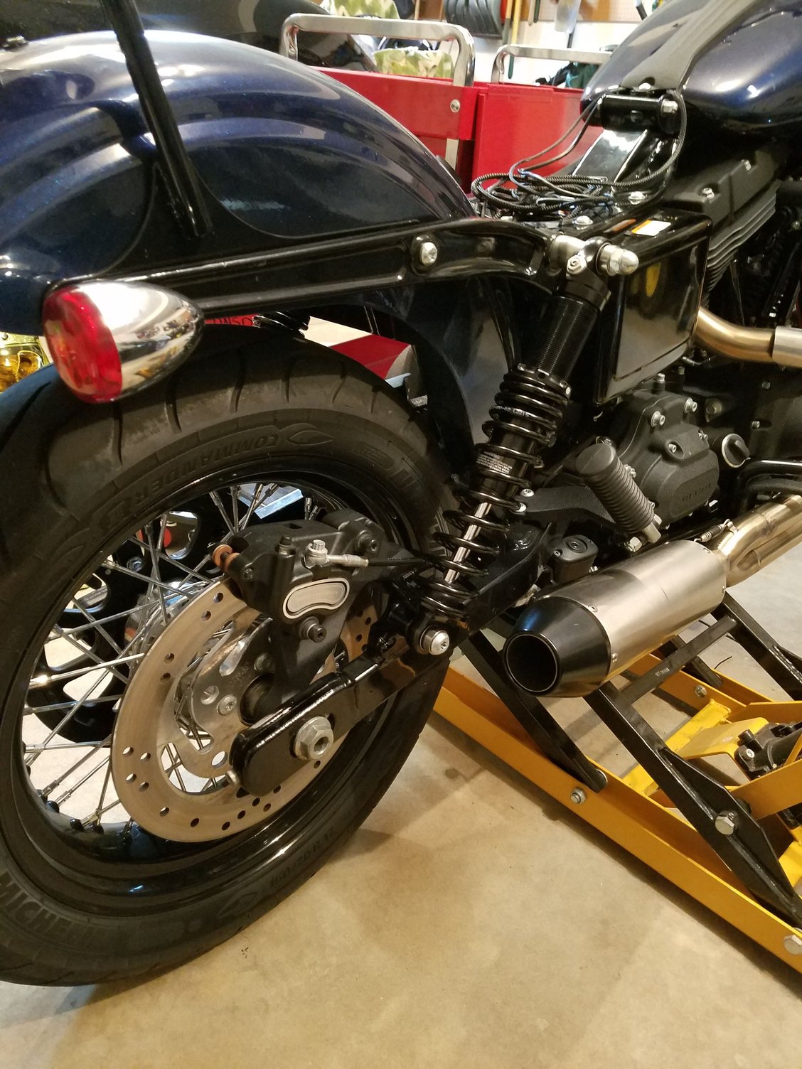

my shocks showed up, and I threw those on immediately.
No instructions, no big deal. Just make sure they don't toe in. Plenty of spacers come with the shocks. Check out that gap, ****ing ugly. 14"

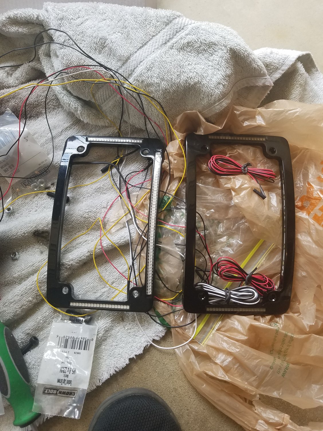

the bags obviously took place of my taillights. So It was time to mount the new lights.
You can see the plate mount I originally bought on the left. Well it won't work on bikes with no center tail light which I should of realized before buying. I had to purchase a new one, seen on the right. It uses the two red led strips on the side as your turn and brake.
Here's a shot showing the bags from the rear. About as slim line as can be. Cost me 4x less than big bear bags. And the mounting hardware actually fit too, unlike big bears which hit the stock shocks. Not to mention big bears bags where ****. But anyways, you can also see the holes I drilled for the plate mount, and also a larger hole using a grommet to run the wires.

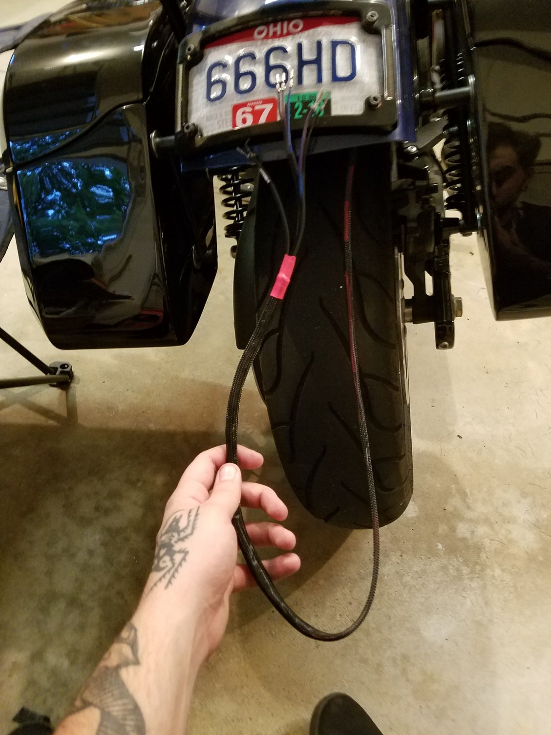

I actually had to wire the damn thing 3x. I was sent a faulty converter which failed after a few rides. But it ended up being okay, because each time it just allowed me to do a better job. Luckily since the bike has such a huge fender gap, it's super easy to wire everything without jacking the bike up.
I'm really against electrical tape. It has its place, but most people absolutely ruin hardwork with it. When I worked on aviation wiring harnesses we used string that looked like Dental floss covered in wax. It was used to tie wires together using a special knot, keeping everything nice and organized. Essentially thats what i did here but with electrical tape. Since I knew it was going to be shrouded, I was ok with using it.
As you can see I ran the wire through a braided wrap and soldered the factory wires to the new mount. I use 3m aviation heat shrink. I ran out of black so red is what I used to sort of mate the end of the wrap and the wiring together.
Here you can see how it's wired under the fender. Just like factory basically.

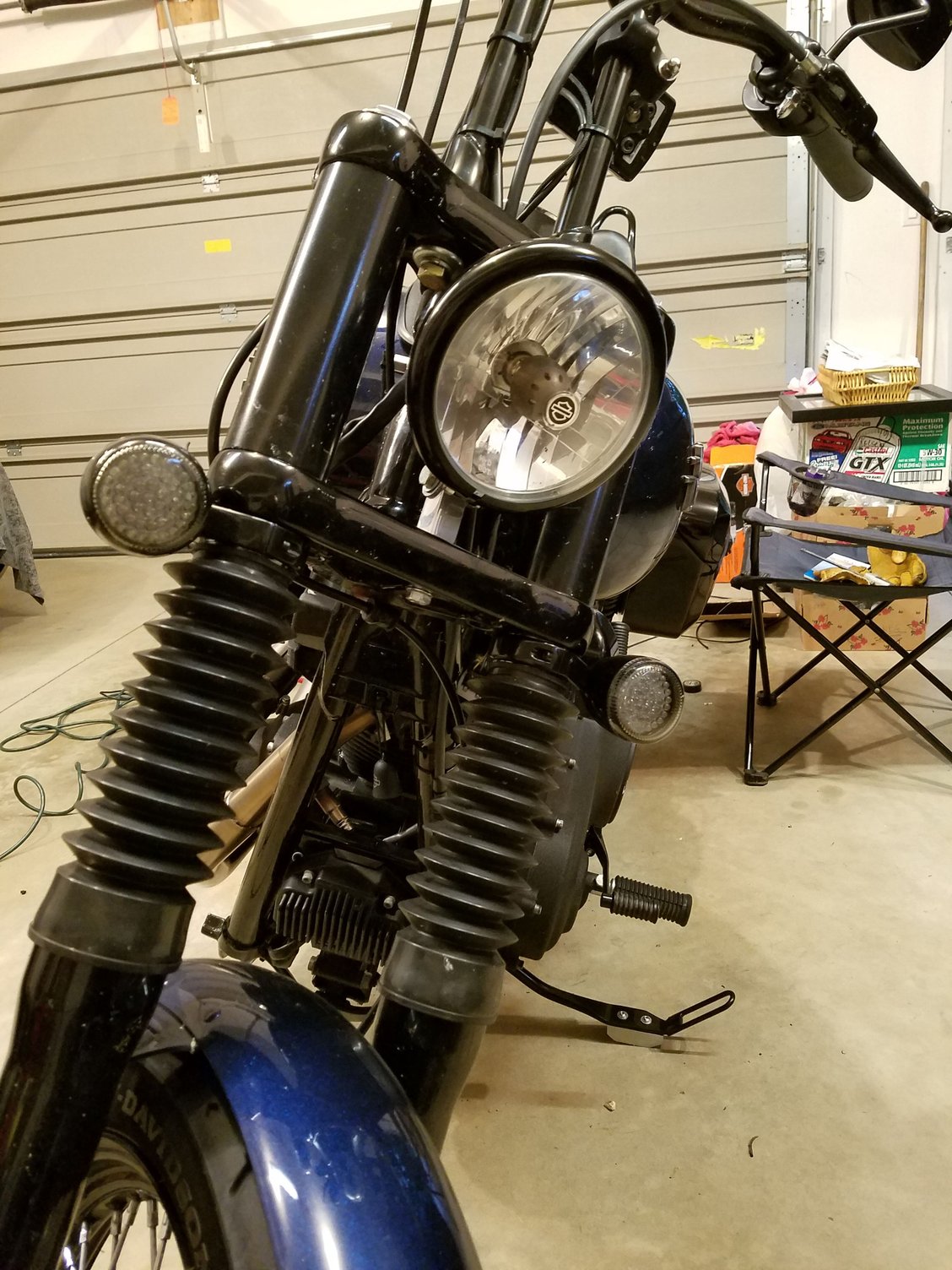

since I was going to mount my front turn signals to the fxrt fairing (which I dont have obviously), I picked up some cheap 49mm fork clamps to mount my turn signals. I think I paid $15 from Amazon. The hardware they came with was the right thread, but I wanted the turn signal housing mounted flush to the fork bracket so I picked up some different bolts.
Here's the lights mounted "flush". Also took 10 minutes to powdercoat my headlight ring.
next step was the wiring the lights

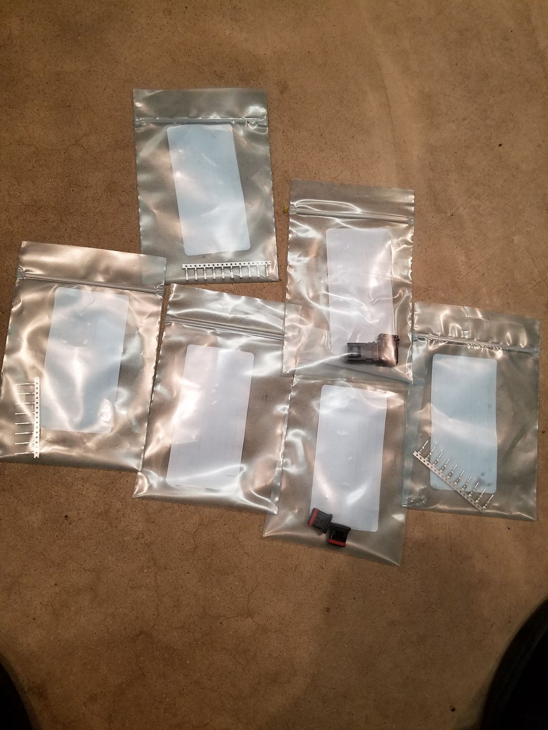

Super happy this worked out. I was able to find the factory connectors, pins, and sockets. If you remember previously I ran the wires through the bars and extended them like 3 feet. This worked out good because I just cut the wires and soldered them directly to the lights. I then used the pins and sockets and got everything wired up like it would be from factory.
throwing this picture up to show how the light is flush with the mount instead of using a spacer. Here the wire is extended and soldered already. Next was to attach the connectors which was tedious but very satisfying once done.
The parts you deal with when using these connectors are very small. This pic shows a weather plug used to "convert" a 4 pin plug to a 3 pin plug. The pins and sockets aren't much bigger.
you can see its shrouded and wired up with the connectors. The wiring coming from the bike was eventually covered aswell. Just testing and making sure everything was working properly. That's the last pic I have of the wiring unfortunately. The wiring follows the lower triple tree and runs into the frame with the headlight wiring. Looks super clean.

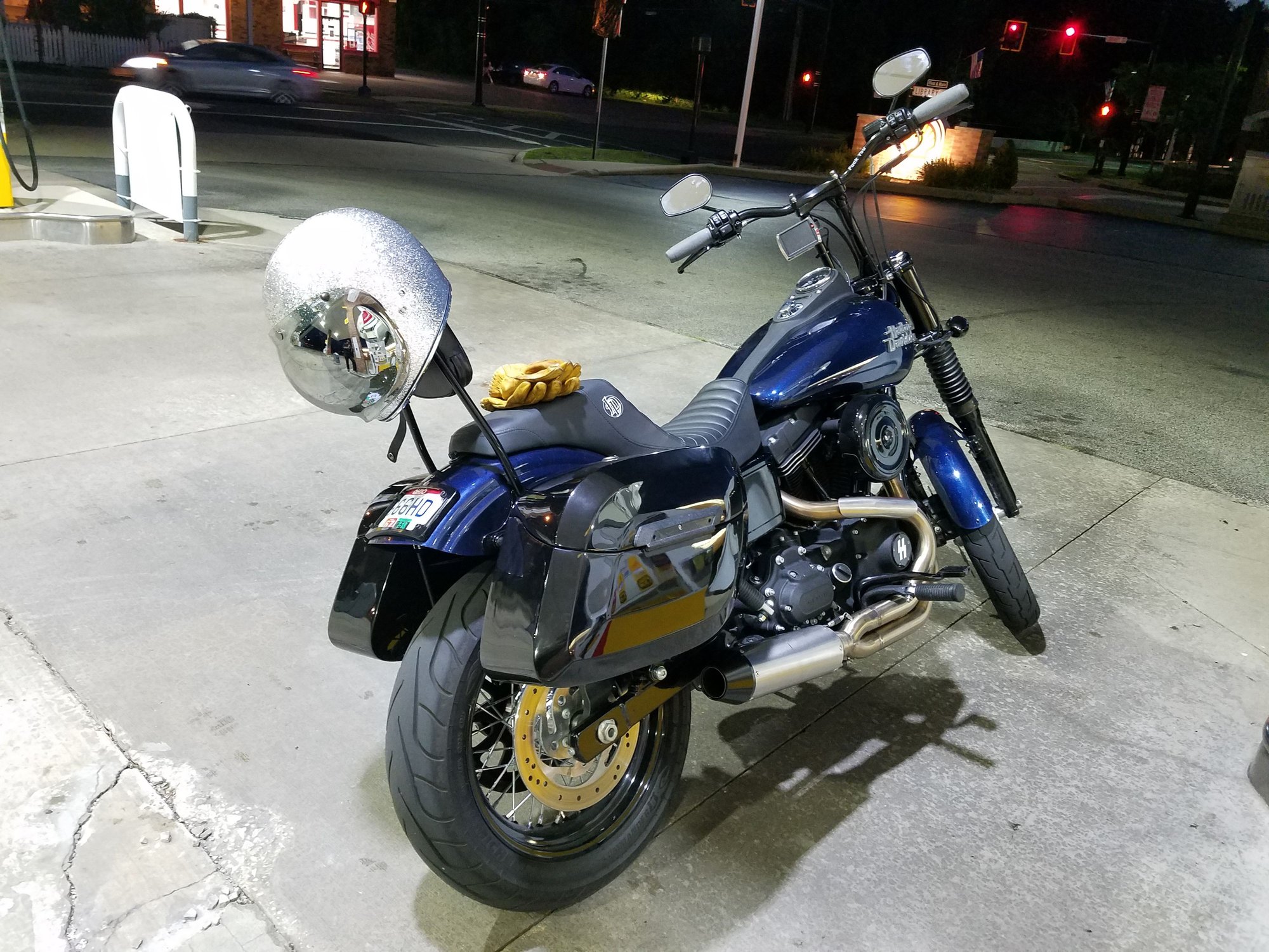

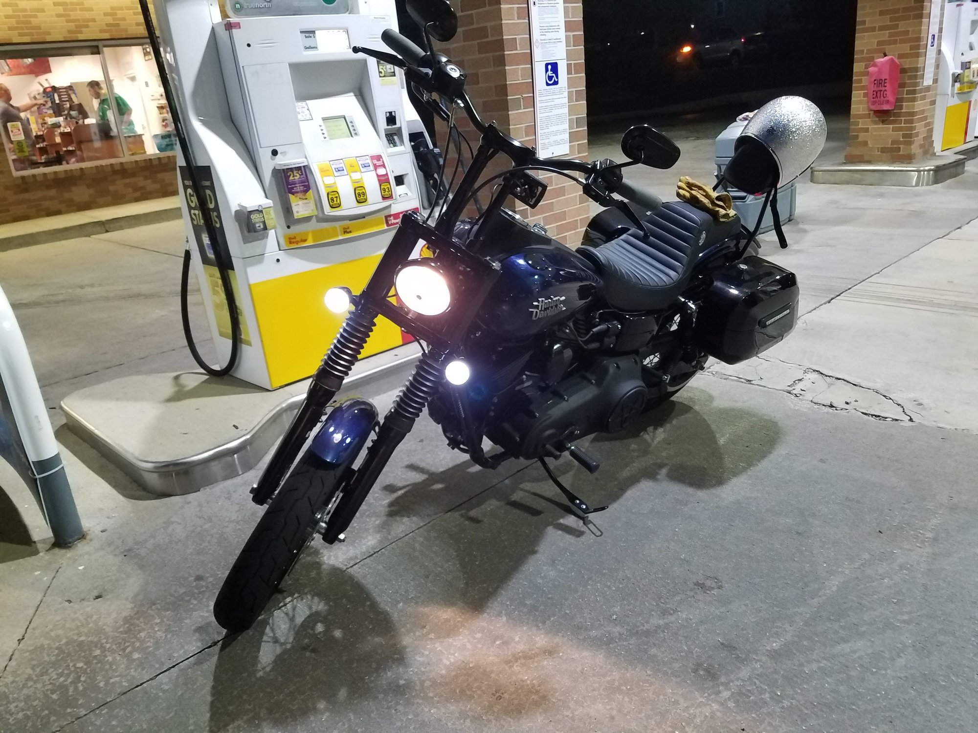

Here is the bike on a quick ride from tonight.
Showing the lights. Super bright. Definitely need to get rid of the stock headlight though as it doesn't match the LEDs and it is horrible.

gonna have to screw with the front end. Letting go of the bars at speed causes the front end to shake. I'm also going to have to get rid of the fork sliders as I think they are messing with the neck bearing adj. as they are a bit of an interference fit. I should have parts by Wednesday so I'll update if I have the opportunity to mess with the bike.

Sounds like your kneck bearings are shot or you have the nut too loose.
I doubt my neck bearings are bad. I think the fork sliders have to go and an adjustment is needed.

Are you talking about the rubber fork boots need to go? The actual fork sliders a kind of important cant really just get rid of them.. I think you may just have the nut under the upper triple tree a hair too loose. Same thing happened to me when I put my front end back together after powdercoat.
