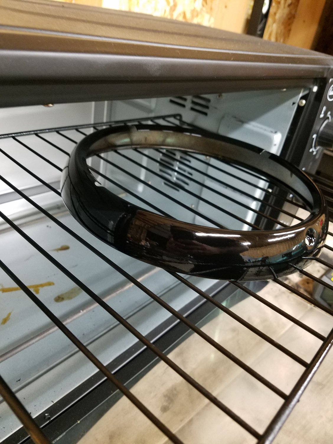

Here is the beauty ring for the new light that is going on my bike. It's straight out of the package from harley and the finish on it is perfect. Powdercoating shows all defects on the substrate so the condition of this part really made this an easy job. I only have about 5 minutes (not including oven time) into this piece.
Since this piece won't be seeing any abuse and will be behind a weather proof piece of glass and gasket, there is no reason in scuffing or etching it with a wire wheel or media. I use Eastwood pre prep spray. This stuff last forever, isn't too expensive and really does a great job (I can pick it up locally too).
simply wipe the piece of leaving no finger prints or oils. After that I threw it on an oven rack.

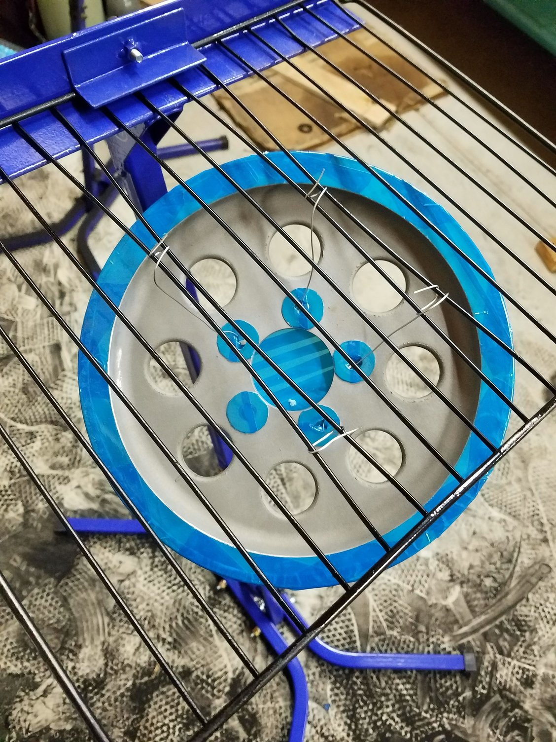

I generally try to hang parts because you dont get the "grill" marks and you don't have to deal with the faraday pain in the *** as much. Make sure your grounding wire is touching the substrate, charge the part by holding a button and blast away. There really is no skill involved. It's very forgiving. Once you have a good coverage. Throw it in the oven
Here is the ring covered and put in the oven. Generally I set the oven to 450° wait for it to fill out and then drop the oven down to 400 and set the timer for 20 min. However the correct way is to wait for the substrate to reach 400° then start your timer.
Here you can see the piece has "filled out " aka gotten shiney. I checked the temperature of the substrate until it reached 400° then set the time for 20 min.
After 20 mins your part comes out like glass. And you no longer have to look at chrome on your bike.

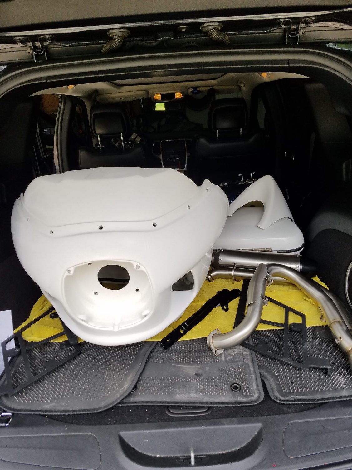

I thought I had a better picture of all the stuff layed out in my garage but I guess not. This will have to do. Everything came packaged super well and in 4 or 5 boxes. I ordered fairings, bags, chin spoiler, and the exhaust. Every inch of my car is loaded with parts. Brackets, fenders, gas tank, etc.

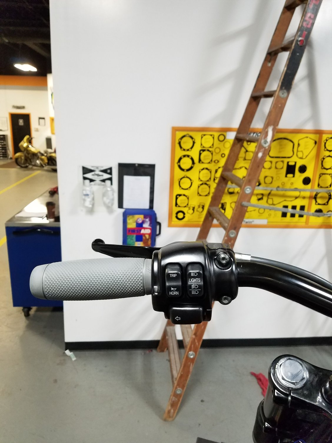

the next thing I did on my bike was finish the bars.
Really disappointed I don't have more pictures of the process. It's was a royal pain in the ***. After I extended the wires I had to wire everything through my bars. But before I did that I wanted to shroud the wires like the factory harness. This meant I had to take off the factory connectors without damaging them. I tried everything. I used sewing needles, jewellers screw driver, and a terminal removal tool. But I found that thumb tacks work the best and the fastest. I'll never buy a terminal tool again. After I got all that **** off I ran the wires through the bars using compressed air and string. Tie your string to your wires. Mask off all holes except the two your using, insert the string and blow the compressed air through the bars. The string will come out the other hole . All you gotta do is pull. Oh and use plenty of lube , I used wd40.

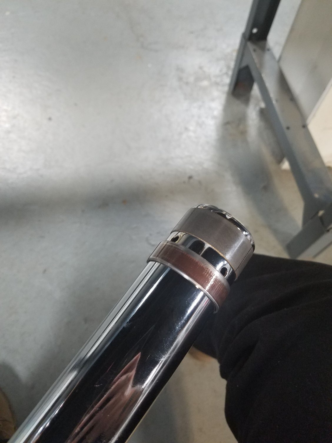

after I got the bars situated I decided to go ahead and extend my forks. I went with the wide glide tubes which are 2 over.
This is the one thing I didn't fully replace. My forks have 3000 miles on them so I didn't bother replacing the bushings. The wear seen here is normal and nothing to worry about. I did replace seals however.
Here is the difference in length between the tubes. ****ing bummed because I had to buy fork boots again. But not that big of a deal. The amount of times I've taken this front end apart is getting annoying though haha.

Installed everything including the grips and levers. So happy with how the wires are hidden. Looks so clean. Sitting on the bike the bars and mids are a hellish ( amazing) combination and it really feels inspiring as far as hard riding goes. I installed my tank and the instrument panel back on. I need it to ride home obviously, but I want to make sure the clearance between my fairing and the tank is perfect. I'm so stoked on the look of my bike right now I could honestly say **** the fairing.
