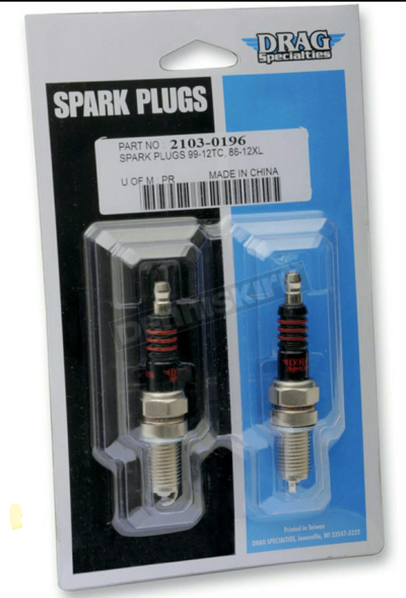

Thanks for the troubleshoot reference. I've just ordered some new spark plugs (since I've only had the bike since April and don't know when they were last changed) I haven't actually inspected the plugs, but getting a new pair on there isn't going to hurt!
I'll give the cables a blast of wd40 and hope for the best in the mean time..

Ordered spark plugs?
heres a link to a xref sheet so you can get some local plugs to test.
https://www.hdforums.com/forum/attac...arkplug-1-.doc

These are the plugs I ordered if it makes any difference.

These are what is in the uk ebay link above:
https://www.denniskirk.com/dk/produc.../21030196a.jpg
your local auto parts store should have one of the plugs listed on the cross reference sheet above... look at thev 6R12 row.
