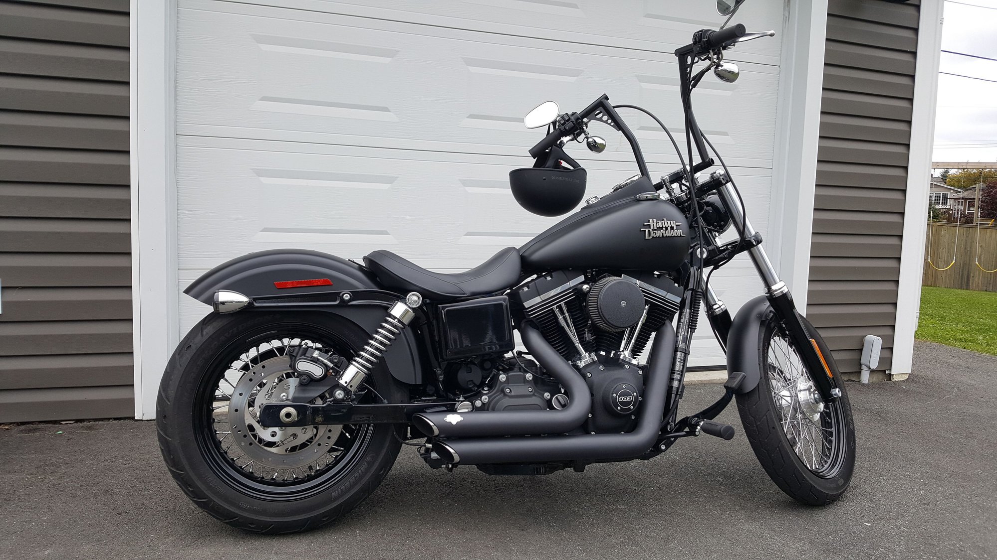

Got it done! Used stock cables but put a 50 1/8" (+2) brake line on. Extremely pleased with the outcome!

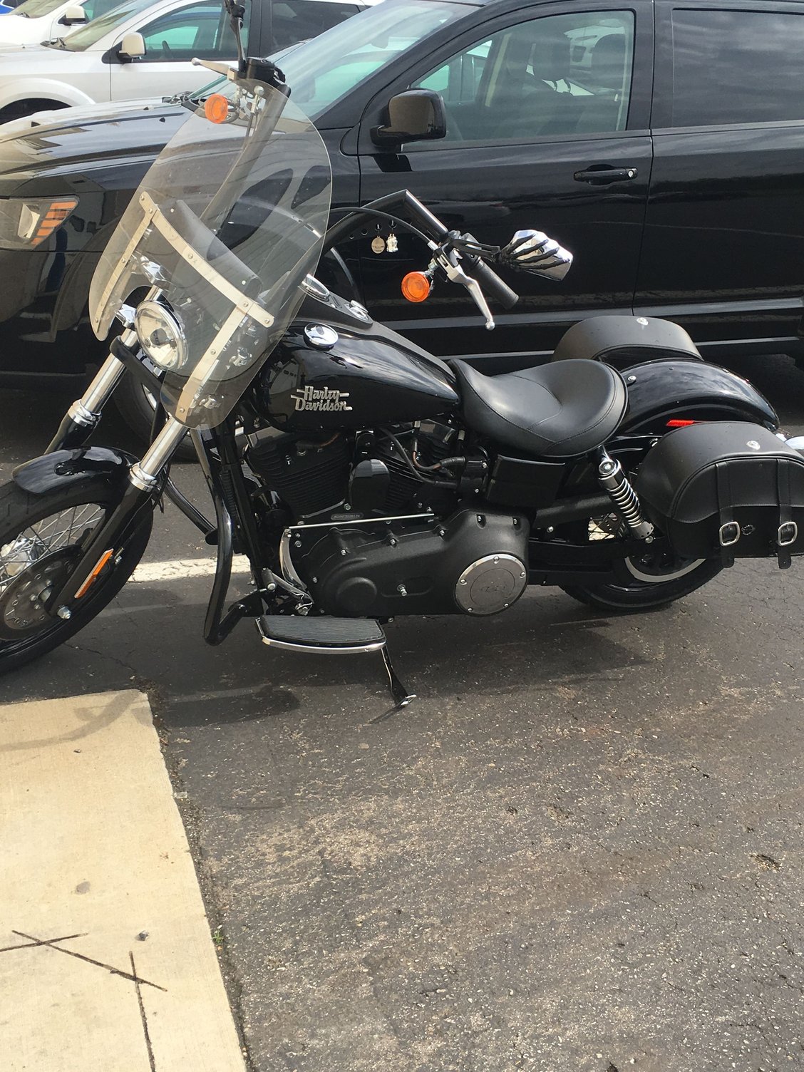

I put 16s on my old 15 street Bob without changing the wiring or brake line. I did loosen the lower brake line mount and take some of the slack out but it still worked without being too tight. If the bars were any higher I would have ordered a longer one.
lookin good man! Now...Some decent shocks ( hagon nitros are decent) and you’ll be set!
