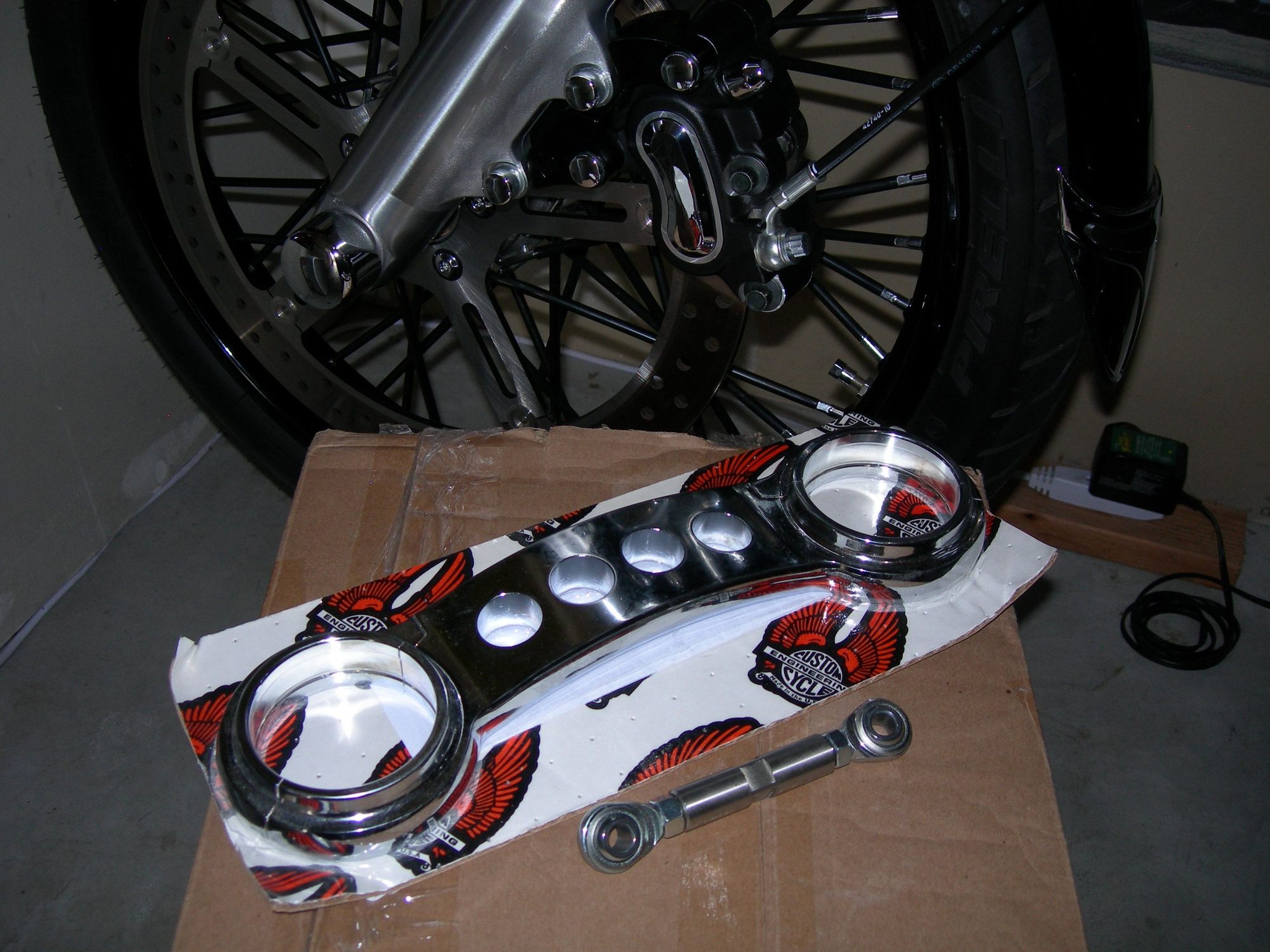

Yea, I do push this bike a bit; I've got quite a bit of sport bike and track riding in my past and I want to get everything out of it I can. That fork brace is worth the price of admission.
I used the Custom Cycle Engineering #TB 2649-1 Wide Glide fork brace. CCE says it only fits through '08 Wide Glides with 49mm fork tubes. I sussed out the part number changes and ordered it, and then Multihdrdr confirmed what I thought; the change was to the lower casting at the caliper mounting; it would fit my '13 If you've got a '10+ Wide Glide, it fits
I know most use the Super Brace, but I really liked the look of the CCE brace. This style of brace is also available as a #TB 2649-1 DG for the rest of the Dyna line. It's a few bux more than the Super Brace but it looks SO much better
Install of either the Super Brace or the CCE brace is not that difficult. I'd get the bike off the ground, if you can, I believe you can do a better and more accurate install that way. You need to loosen the fender mounting bolts <they're not metric, BTW. 1/4" allen and 1/2" nuts > and the front axle. The idea is you're going to take the tolerance slack out of the front forks. You want a slop fit on all the fender bolts and the axle and then mount the brace. Be certain the brace is exactly at the same level position on the sliders. Torque down the brace; then the axle, and then the fender bolts.
I have zero regrets on that fork brace. I did get it from Powersports Superstore through Amazon for a better price than suggested Which ever way you go, you won't regret it...
https://www.customcycleengineering.c...sses-7/49mm-68
https://superbrace.com/collections/harley
The day it arrived; that solid top stabilizer is an entire new thread

What's up with the turnbuckle? Thanks.
Agree, your brace looks great.

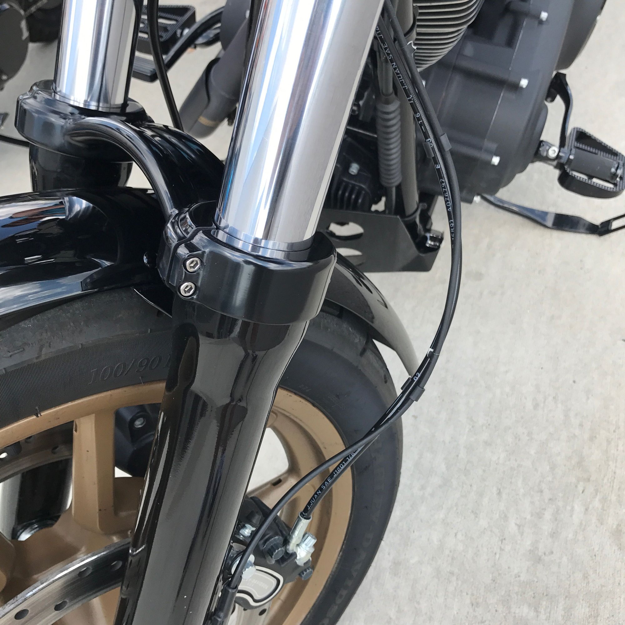

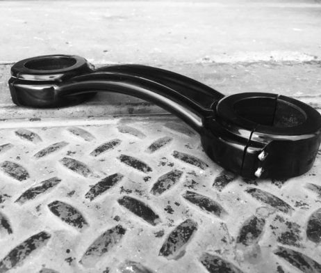

I had one on my LRS. It works great. Really seemed to tighten everything up. Only reason I’m not using it anymore is I’m switching to an inverted front suspension. Mine is for sale. Starting price is $2k. Oh yeah, that comes with a complete LRS front end, front brakes and OE brake lines��
Mine is made by Bare Knuckle Choppers
Thanks! The turnbuckle w/heim joints is a solid top stabilizer to replace the OEM stabilizer with rubber bushings. It removes the slop and horizontal motion of the top of the engine which was most noticeable during cornering. The Dyna powertrain/driveline/rear fork/rear wheel ride on 3 points; the front isolator, the rear isolator, and the top stabilizer and as with the Predator/Sputhe/TT mounts, the solid top stabilizer is another piece of the puzzle to improved handling and stability.
It solidly mounts the top to the frame; it does increase vibrations at lower RPM's slightly but not in any sort of unpleasant way.
F86 sourced this stabilizer out, he did a thread on it and the rear Sputhe install here: https://www.hdforums.com/forum/dyna-...top-mount.html
I found on my '13 to properly install the top stabilizer and achieve a 0.00 vertical alignment I needed to cut the ends of the turnbuckle and the heim joint studs slightly; on F86's '00 no cutting was needed. I agree with F86 that most likely had to do with the variances in individual bike alignment.
I shameless pilfered this image from F86, he had his tank off when he installed the top stabilizer; with my tank lift I was able to install the stabilizer without removing the tank so my images of the stabilizer don't show much
