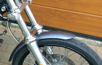

I put one on my Wide Glide, because of the state of the roads in the UK.
It may be a placebo, but i think it is noticeable difference, crossing over wee ruts on the lane joins. i suspect it may be more of a difference due to the rake of the WG forks.
The chrome finish, does not make it stand out. Enhances perhaps.
