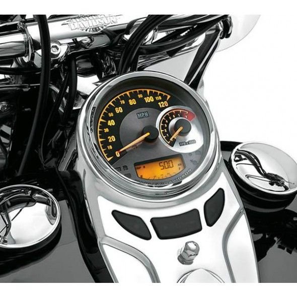

Hi everyone. I recently purchased a 5" speedometer replacement for my 2017 Dyna Street Bob, which has a stock 4" speedometer. When I ordered it from Harley I told them the model of my bike so I assumed it would fit... nope. I really like the speedometer so rather than return it to Harley and install the one I just removed, I'd rather find a 5" console (black to match). Hoping you guys could recommend a console replacement with a 5" insert. I've tried several websites and haven't been able to find one.

This one:

The #70900475 4" gauge would have been the correct fitment for your '17 Street Bob; a simple plug and play install for CANbus bikes: https://www.harley-davidson.com/stor...r---tachometer
It looks like you got the #70900070B gauge: https://www.harley-davidson.com/stor...ter-tachometer
Your '17 Street Bob is CANbus; I'd doubt that gauge will work correctly even if you do find a proper console
