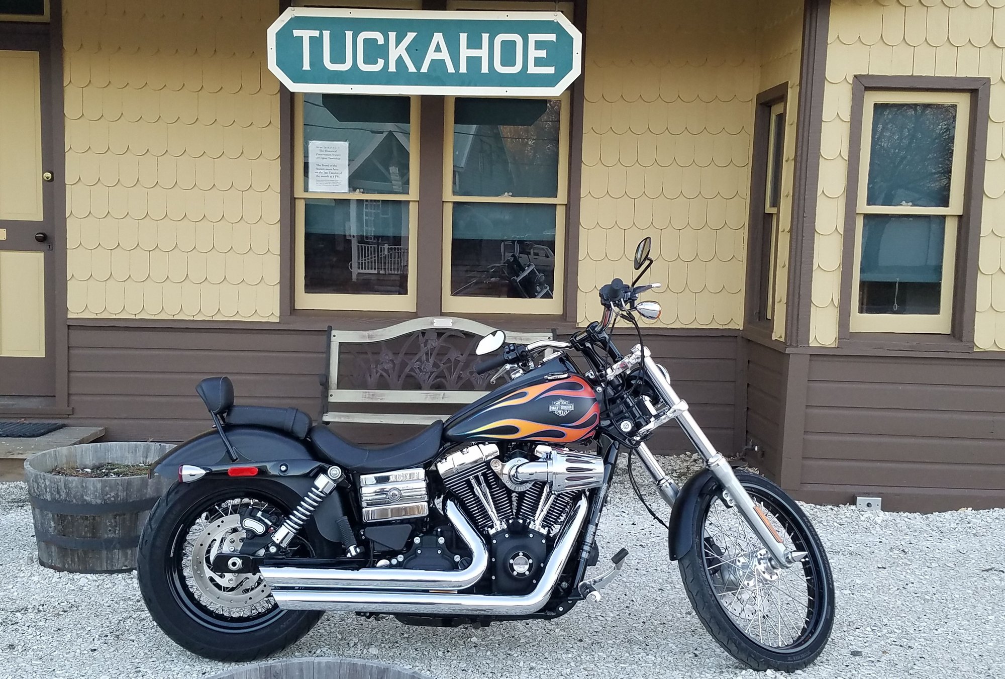

Unfortunately I tried it that way first without success. Here goes anyway. My front tire is shifted to right with makes the fender and tire not lined up. Dealer told me they are all like that. Trying to verify dealers info. Thanks

Can you post a few pictures?

The OP posted up images in this thread: https://www.hdforums.com/forum/dyna-...re-offset.html

Going to my home town dealer this weekend I can get a pick of the 16/17 wide glide they have on the floor I know they have 2/3 still. If that would help. Mine like tincup is centered.

That would be great. I really appreciate it. Talked to several dealers. Some say it's normal some say it isn't. Thanks in advanced.

I will get picks on the ones on the floor. and post once I get them Guessing Monday due to the weekend being busy. dam kids.

My '17 (ABS) is centered up.
However when I got the bike new in Sept. of '17, I noticed the fork legs were not installed evenly in the tree's. One was off by around 0.150.
I loosened everything up and set them to the same measurement and reset the front axle per the service manual. Don't assume it was put together correctly at the factory.
