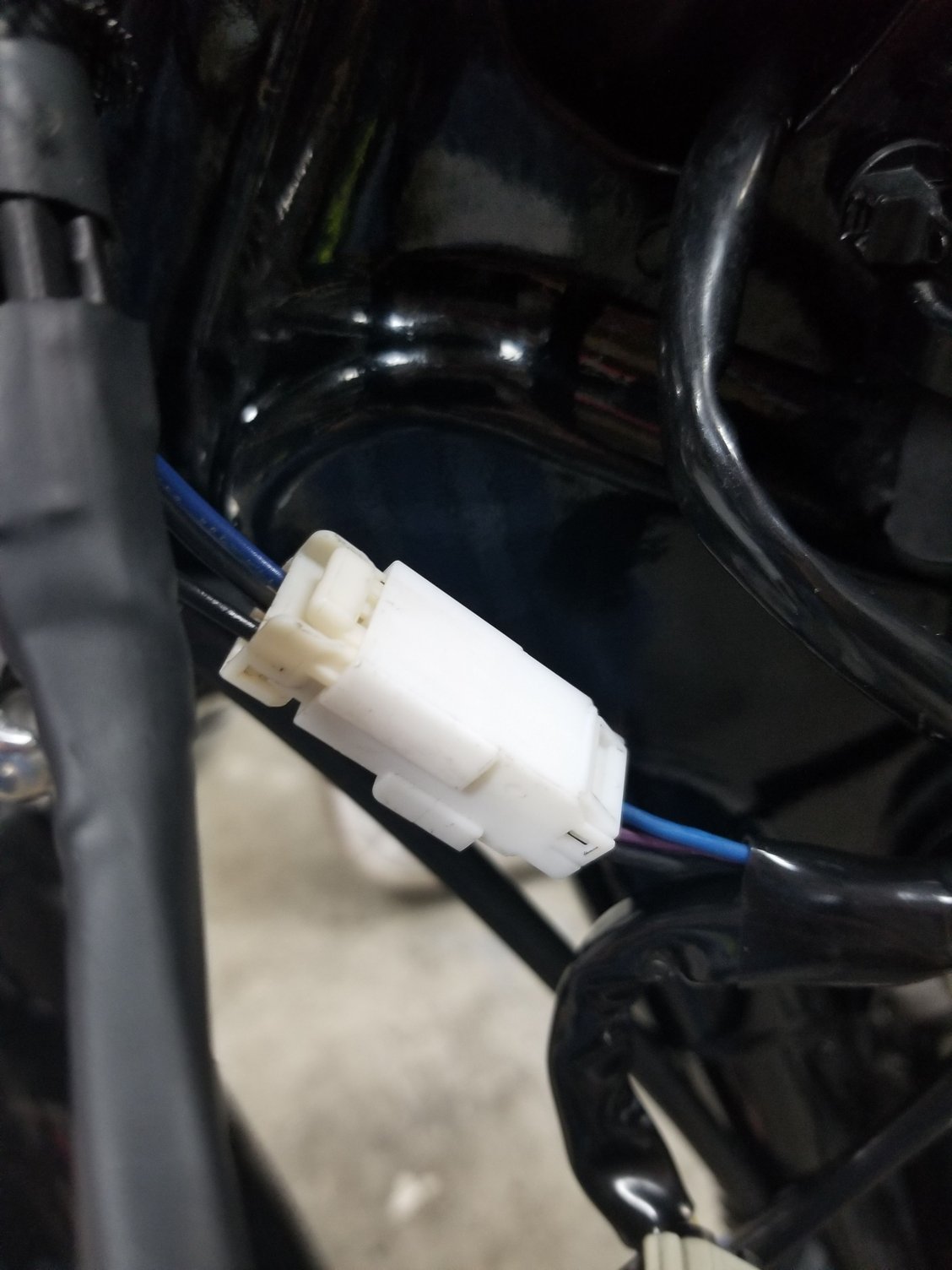

Hi All,
I recently changed the bars on my 2007 FXD. I went with 12" MXT bars. I used NAMZ wiring extensions. When I got everything put together it appears that the connection for the turn signals is loose. If it wiggles the turn signal light will go out and/or not flash. I tried a bunch of things and thought I had it. But alas, now that I have the wires all stuffed up in the frame the left turn signal does not work. I'm at a loss and dont really know how to move forward. Any help would be greatly appreciated.

Here is a short video that shows the problem.

Thanks for that. I've already pulled it once as there was a short which was blowing the fuse. I found that. I think the problem is in the actual connector as this is where I wiggle it causing the light to malfunction. You're right I'm going to lose good I have to take these bars off, again....

You found out that a grounding short will blow the fuse so it ain't that. This looks more like an intermittent connection and it could be either ground or power. According to my diagrams, if it is an intermittent ground, it should affect both the running lights and turn signals. You know that it is intermittent, but you need to also know what works and what doesn't when you are manipulating the plug. I would check that first. You could be right about the connector but that shouldn't be too hard to verify.

So as an update. I pulled the plugs, using needlenose pliers i bent the female pins up slightly. Problem solved. What a frickin relief!

Good job! Once I saw your video I was almost certain it had to be the connections inside the plug.
