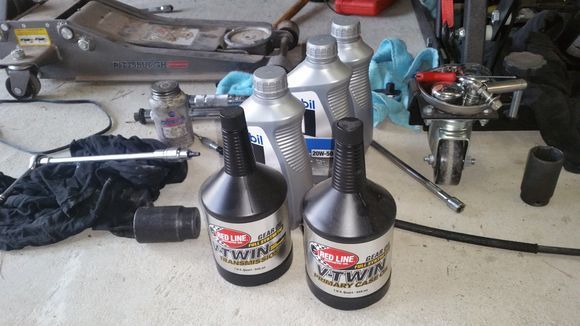

after much consternation,fiddling ,shucking, and jiving, . .. I've arrived here:
  • red line vtwin primary
  • red line vtwin tranny
  • mobil 1 20w-50 synthetic
  • oil cooler.
