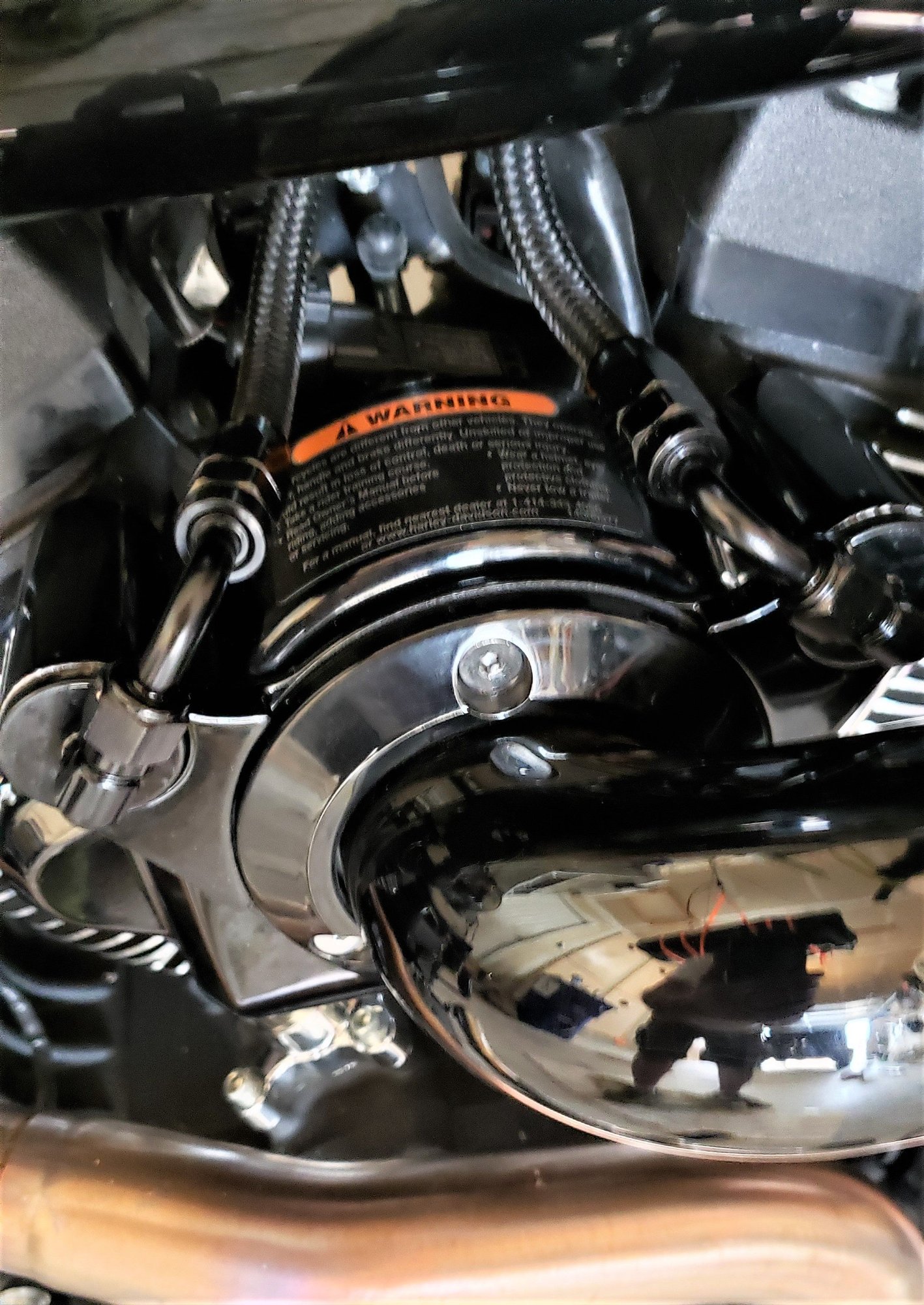

I drilled and taped the caps, used 4an fittings and ran braided hose under the tank, down the frame to a oil catch can. I purchase an extra set of caps to switch back to stock if necessary.
