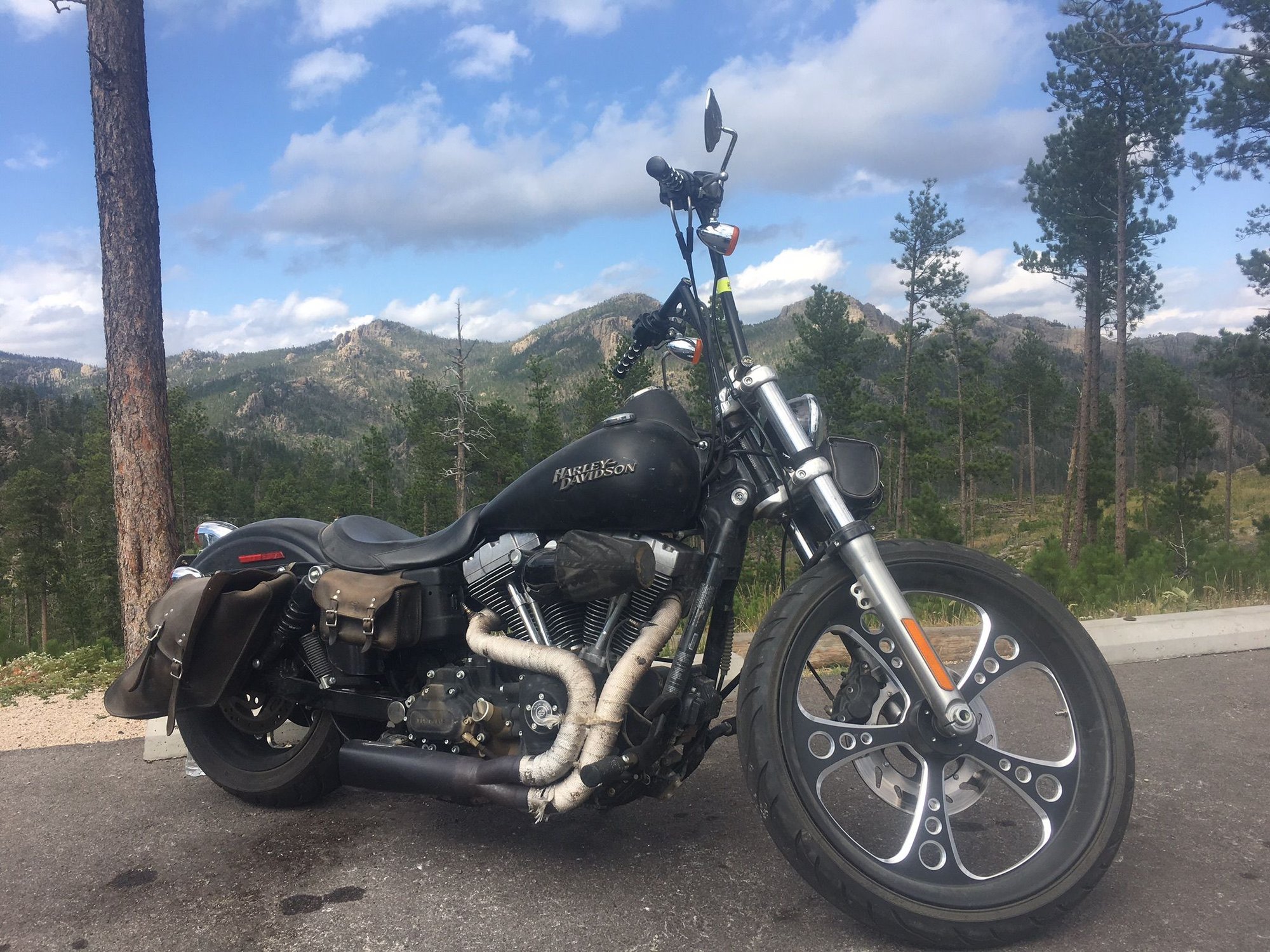

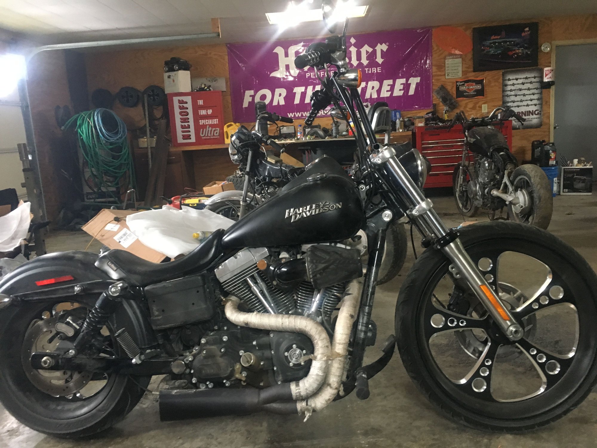

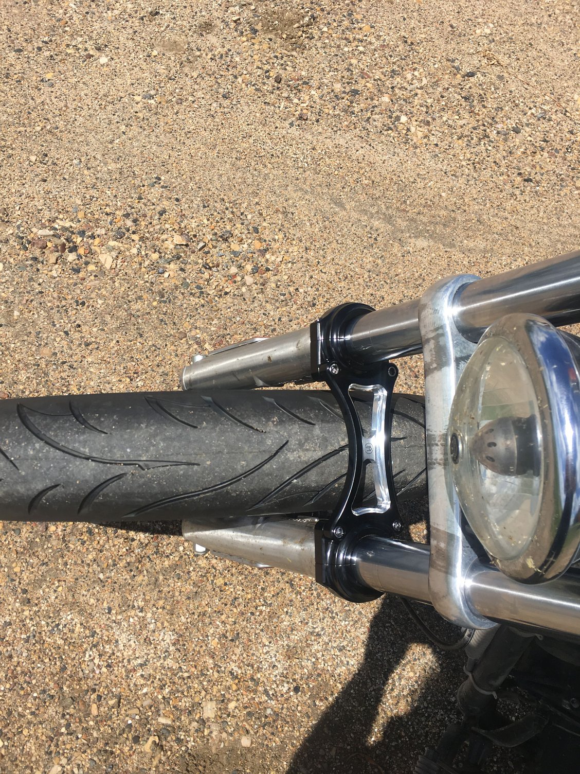

I’m not understanding why you guys are so harsh on this guy and his question. It’s reaaonable, can be easy to do depending on direction wanted, and frankly, it’s a good upgrade for looks.
I just got done doing this last year (as well as putting a 200 out back) and rode it a lot last summer. Had no issues, handles well. Doesn’t accelerate as quick, but with a 103 stage 4 in it, it’s plenty fast already. Lol. Feels more stable in the corners than before. It’s a bit heavier going into the corners, but it holds its line flawlessly.
For me, and what I would recommend to you, is order a custom wheel in a design you like. They will make the hub to your bike specs, and then brakes are the same, spacers are the same, etc. The only thing you would have to decide is what to do with the fender. (I ditched it and put in a fork brace). And as far as being 2 inches taller, yeah, obviously that is true as well. I lowered mine with a burley slammer kit. I may end up changing my springs out in the future to something that handles better, but for now it works.
