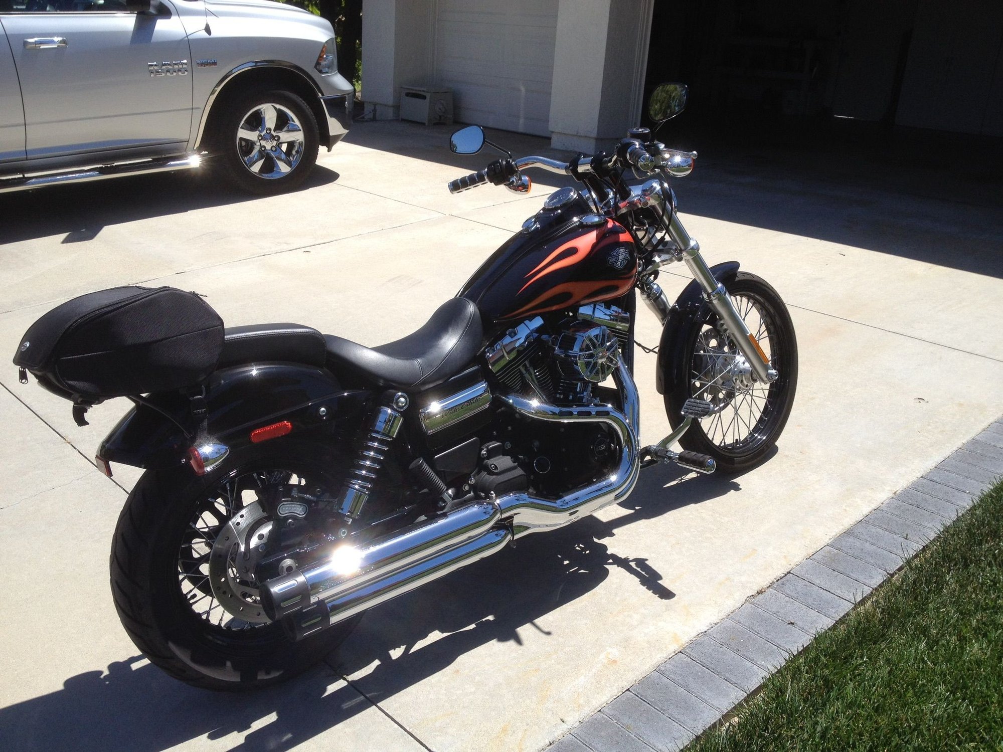

I put solo luggage rack on Wide Glide. Also removed sissy bar that comes with bike. Sissy bar was bigger job. Removed blinkers, fender, seat. Disconnected wiring to tail lights to run wiring inside fender.

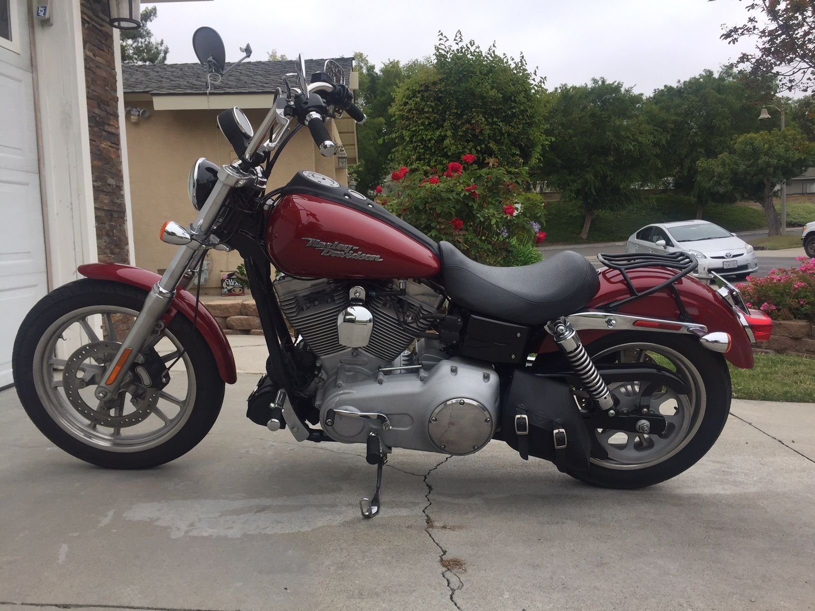

Originally Posted by tunafisher729
I used painters masking tape all along the side of the fender and the inside rail of the rack to prevent scratching. I also remember needing a third hand to help spread apart the rack and keep the fender aligned. Once I got the rack installed I tore away any exposed tape. Definitely a DIY job, couldn't imagine paying for 1-2 hours
labor.
That's a cool rack. I wonder if one like that would fir a Switchback?
I like that tail bag. Model?

Dowco Rally Pack 24 liter. Amazon $50
had it 2 years. Kepp tool bag jumper cables manuals & much more

Nice bag man!! How does it get installed? Do you have a solo rack too?

Harley luggage rack for chopped fender
https://www.harley-davidson.com/shop...s#!pageSize=45 category=136511 searchTermScope=-99
Tail bag has straps that make it easy to remove. Front straps wrapped around turn signals. Rear straps around end of rack. Very secure.
