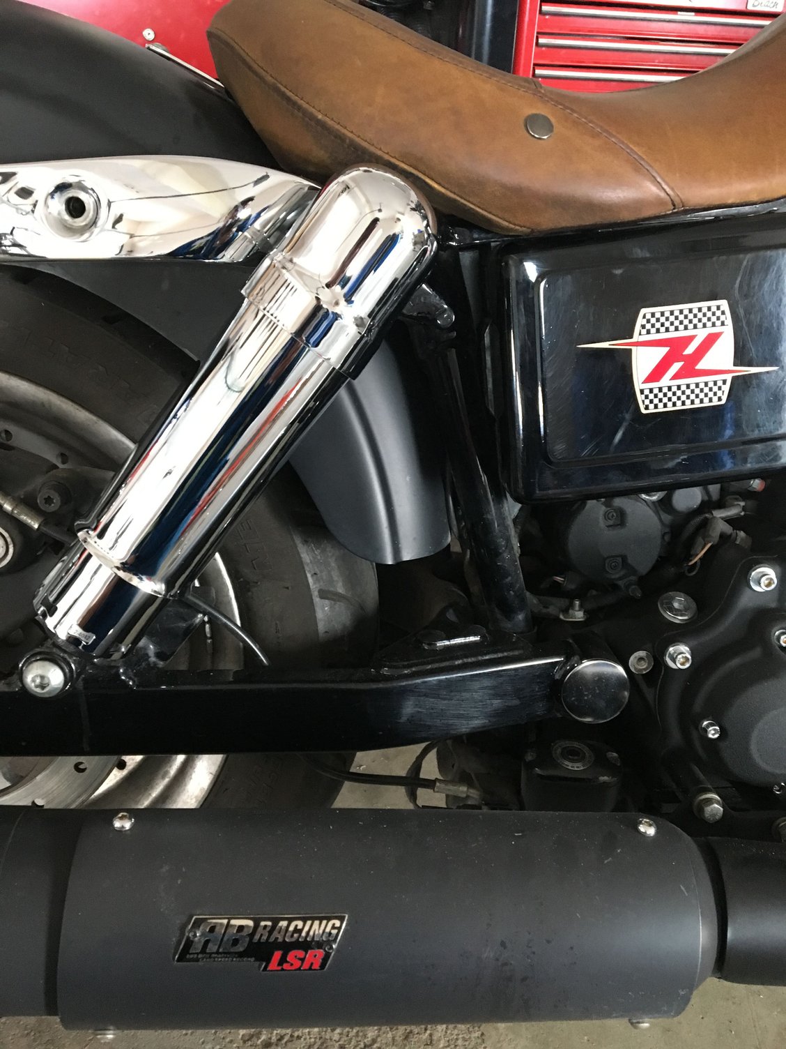

I've got some 412 heavy duty in stock length 12" , black with some rubs from bags. I'm a light guy and don't ride loaded as I thought might when i got them. Replaced with burly brand, regular duty. Will sell for 75.oo plus shipping if interested. About 10k on them. I noticed a good improvement over stock, but also did fork springs. I can email pics if interested.
