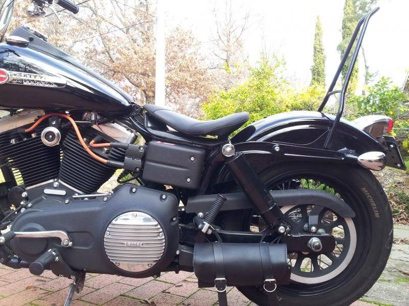

I replaced the stock setup with 412s and progressive springs up front (and played with fork oil) at the same time, and was very pleased with the overall result. IMO, the 412s were a significant improvement over stock, BUT that's not saying much, because stock (both front and back) are (again IMO) really bad, even dangerous.
I think that the 412s and prog fork springs are what the bike should have at least come out with as stock parts. Not great, but good enough.
There are plenty of better shocks than 412s (it just depends how deep your wallet is really), but for the money, they are a worthwhile improvement over the stock junk.
