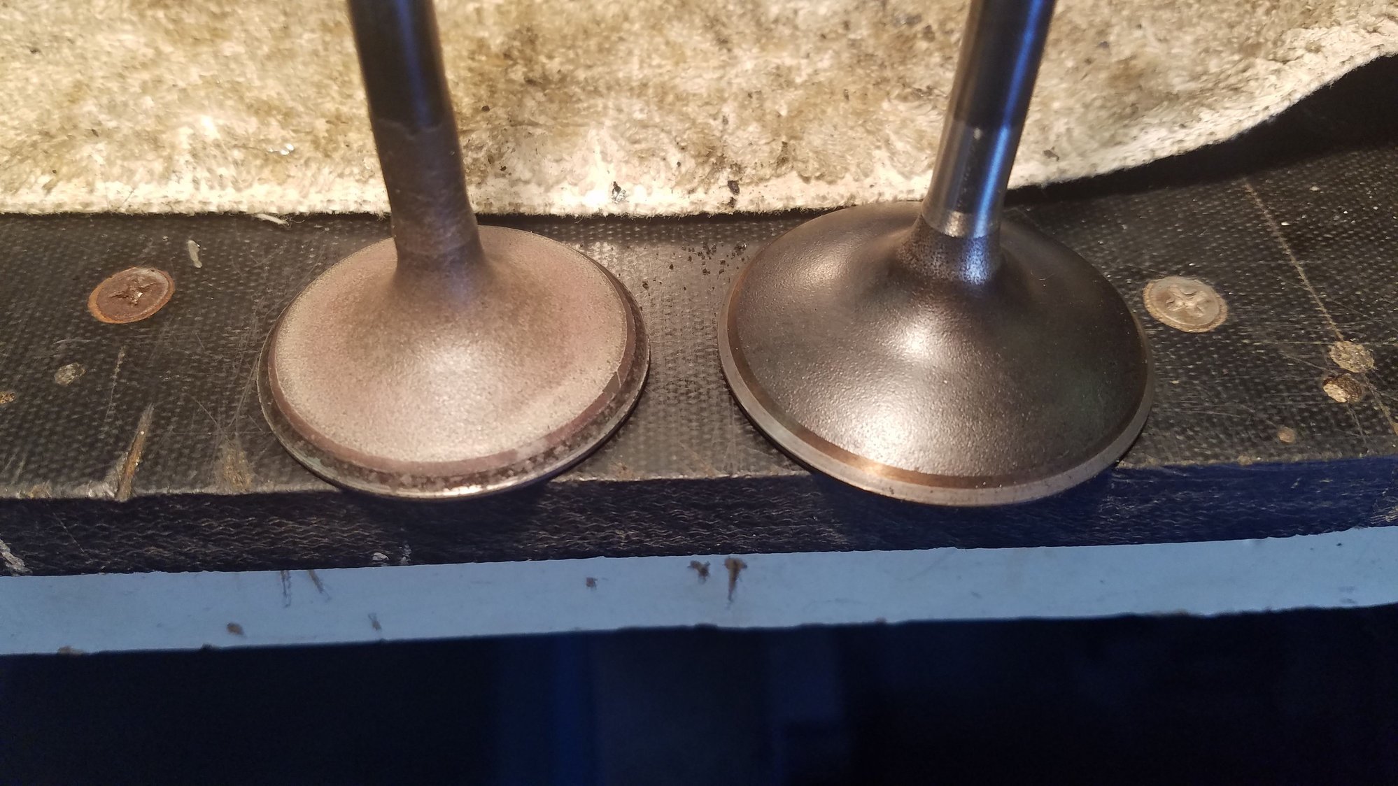

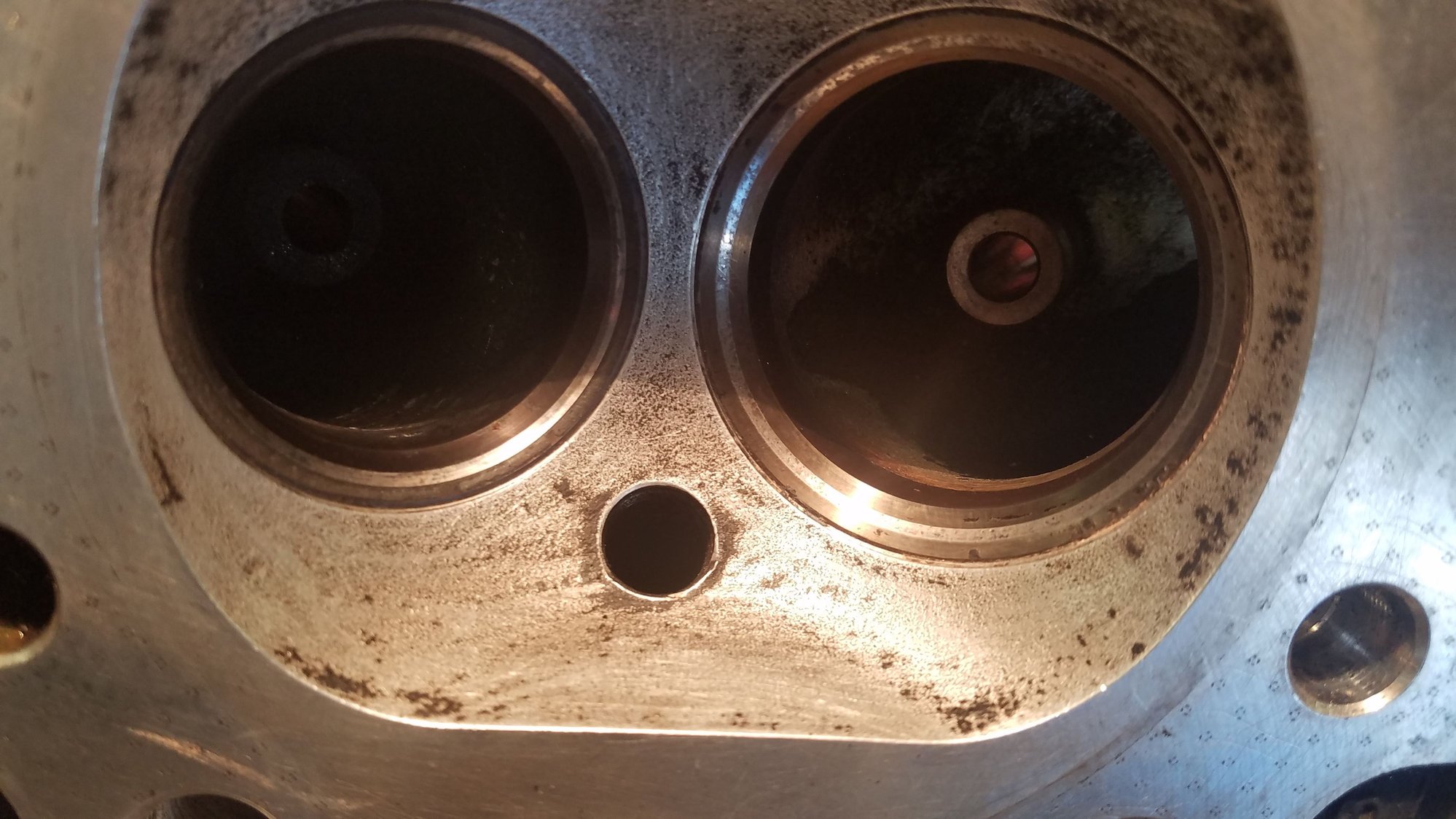

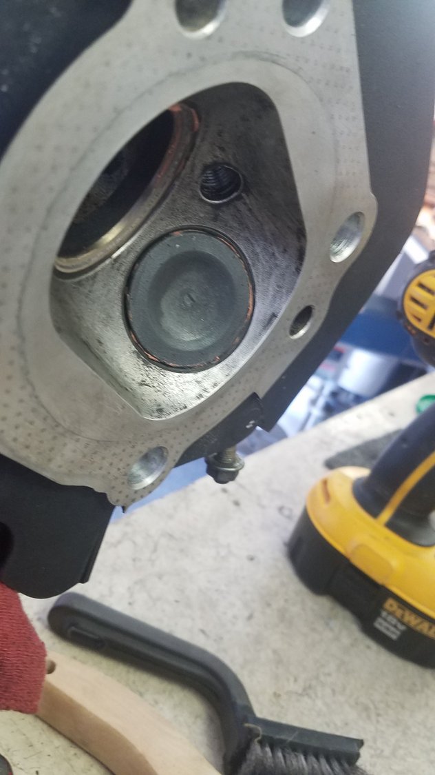

Here's what the head looked like after about 15 minutes with an old spoon, butter knife, small flat bladed screw driver and some stainless steel wool.
Note that there is still a lot of scum in the intake and exhaust, some of that's loose from the head the rest came off in a few more minutes.

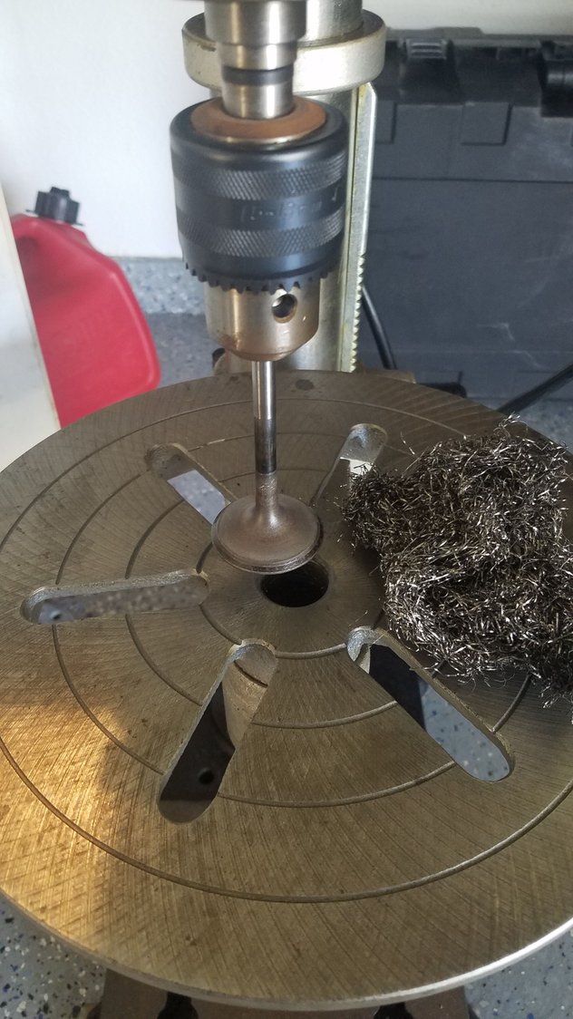

Then I cleaned up the valves, fortunately for me I have a drill press, made this job quite a bit easier.

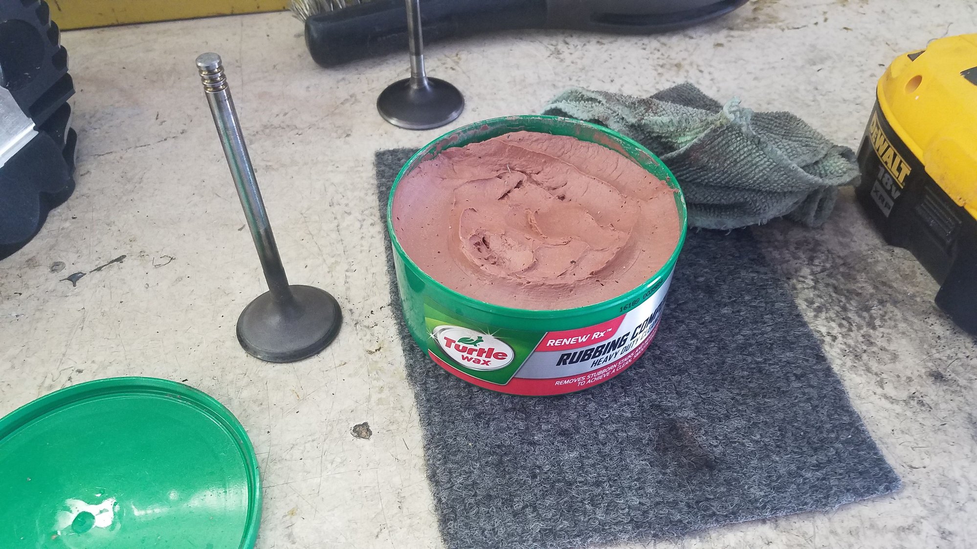

After that I did a little lapping with cordless drill and just regular rubbing compound.
I reversed directions with the drill several times so as to not have any weird galling in the guides etc.
Definitely not what the experts would use but made a shiny ring.
Here's the end result for the head ....
And here's the end result for the valves
The exhaust still looks kind of ratty but way better than it was before.
I'm hoping to get at least a few thousand more miles out of them before doing major head work.

I don't think I would have chucked those valves up. Did it mark the stems up?
