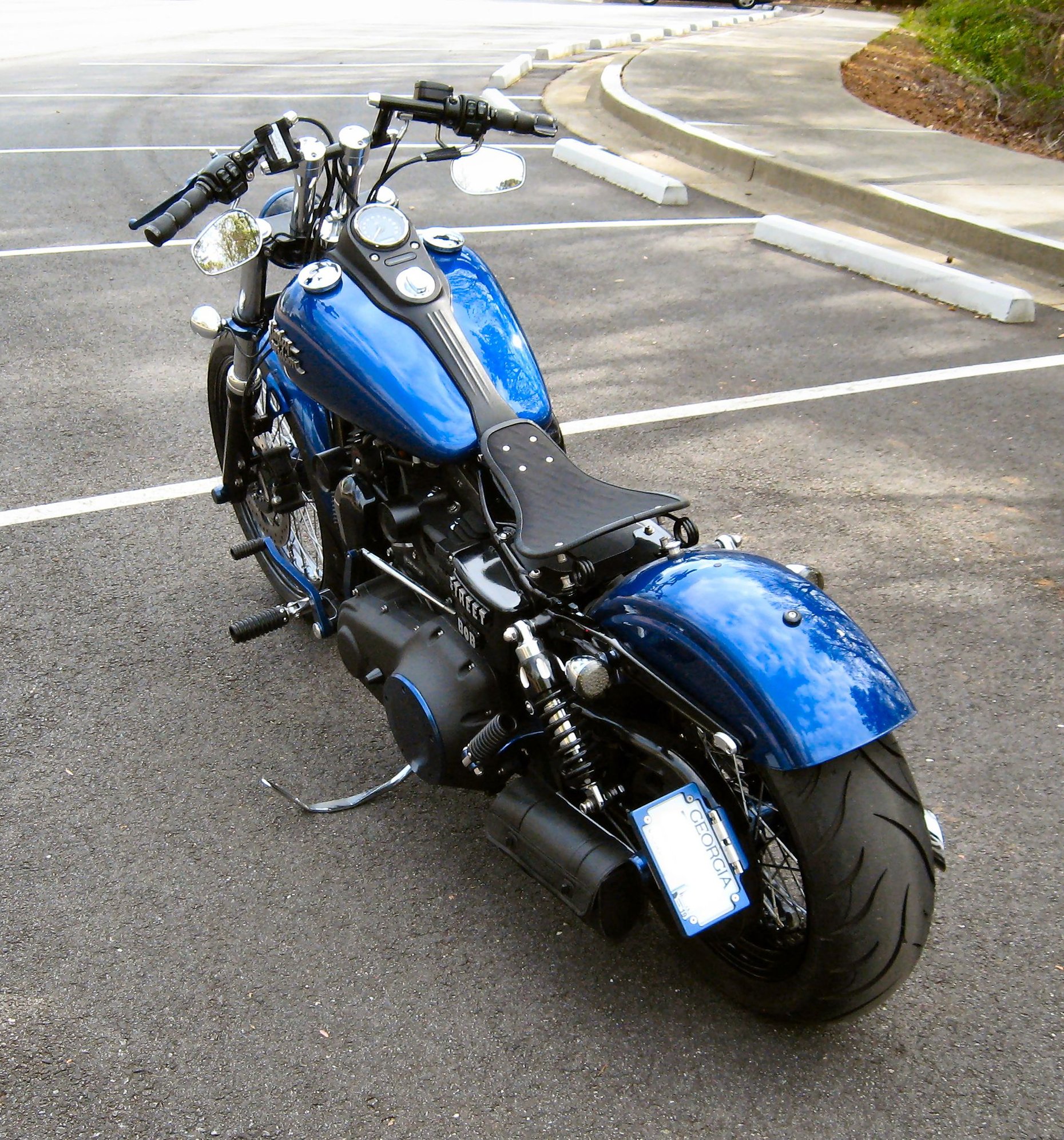

Do I have room for this?
Thanks in advance.

Yes....5.5" - 6" rim required. Signal light relocation required. Custom wheel spacers / sprocket spacer. Possibly modify brake caliper mount.
If you want to bad enough it's totally doable

Gorgeous ride Blue Bob.
