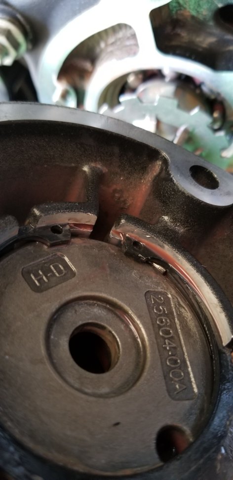

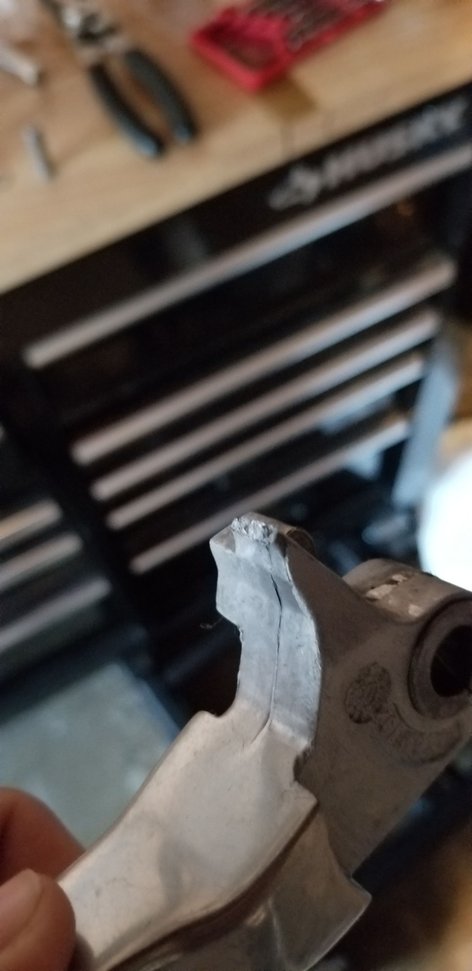

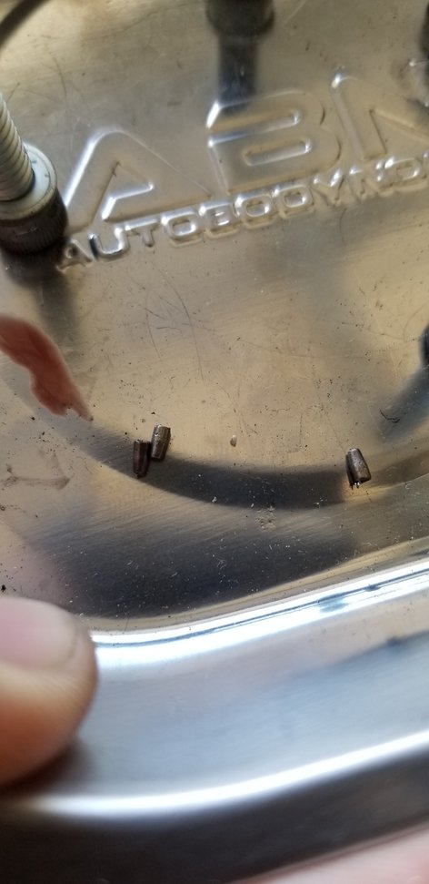

Took things apart, the cable is still intact on the transmission end. Found some nasty surprises after opening it up though. There was some metal debris the looks like it might be the tips of snap ring pliers? not sure what else it would be, suggestions are welcomed. Also a random bit that I can't make sense of where it would have come from looking at diagrams.
Another bit hiding beneath the retaining ring
WHERE DID YOU COME FROM??
I'll have to resume this after work, was hoping to get it resolved this morning but it looks like I don't have the correct size snap ring plier.
