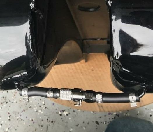

Originally Posted by Dynaglide92
Nobody? My tank is off to where I can adjust which way the motor sits in the engine and I’d hate to put it back because draining the tank is a pain in the ***
Quick disconnect can remedy this.

Yup!
I can't imagine having to drain my tank every time I want to take it off.

Originally Posted by F86
Yup!
I like this do you have a parts list I forgot what the ID is for the hose
The crossover is 1/4" ID. My valve is from Goodridge, but other companies make them as well.
