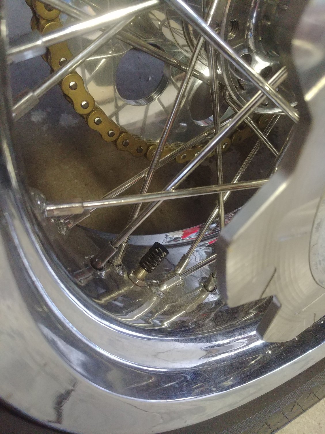

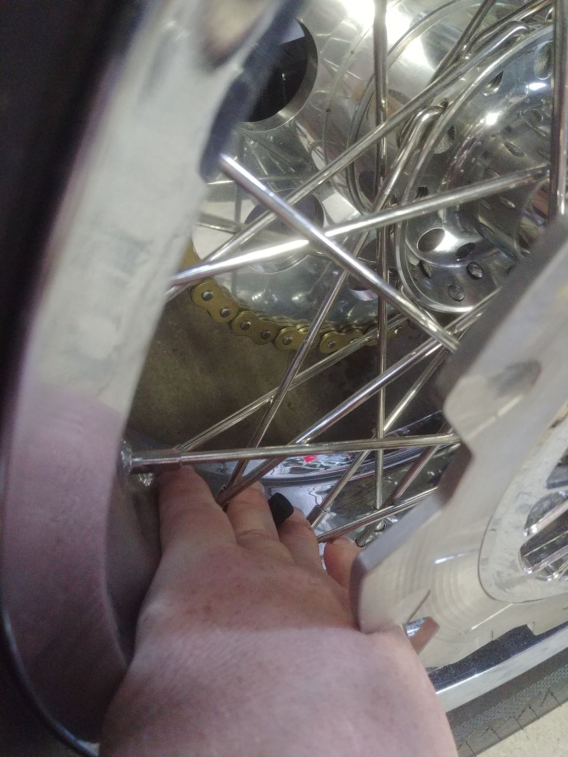

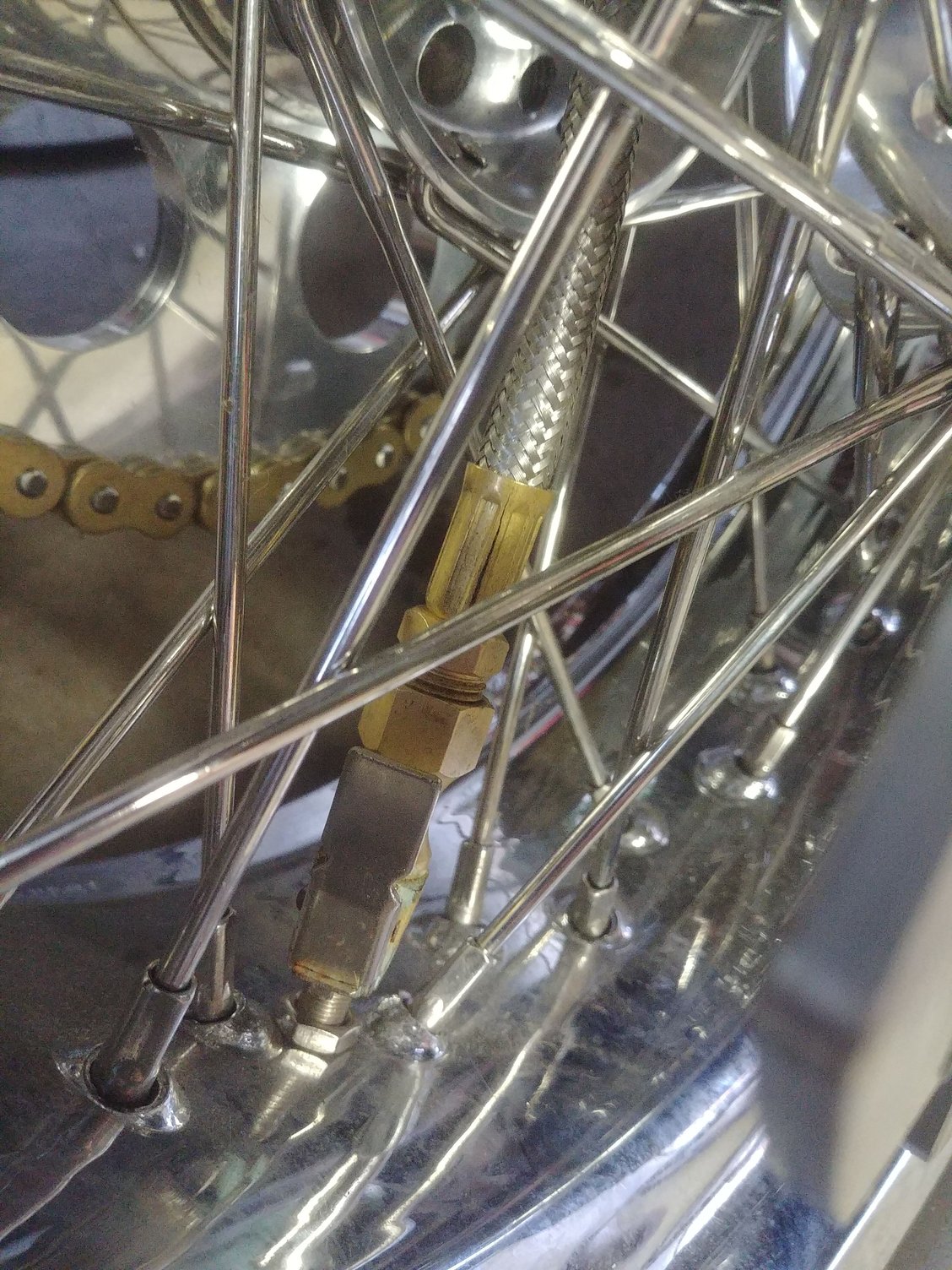

I need to change something to make adjusting my tire pressure easier. My spoke rims have center valve stems and both axles have "dual discs", small diameters, and wide widths. It's a real hassle to snake my current air chuck and hand in there to check the pressure.
What y'all using? I'm thinking some kind of 90 adapter on the valve stem...

I have one of these that I stole off of ebay for $15
https://www.ebay.com/itm/NEW-Motion-...ss!08611!US!-1
best chuck for motorcycle I have ever owned

You can have new valves installed engles or tee work great but it may cost a bit to have them installed.

The stems are molded into the tubes. I could get tubes with 90 degree stems but I'm not in a hurry to change tires/tubes. Besides, it's hard enough to find tubes that fit my weird *** wheels.

Your situation definitely looks tough to reach, though! Maybe you could get in from the side with the small end this ships with?

If/when you get angled stems, even on a tube, get metal, acceleration/deceleration forces really twist a rubber stem and they can fail early. I had one break off when I tried to put air in it - in my garage, fortunately. Haven't put rubber stems on a bike in many years. I'd never put an extension on a rubber stem, either.
